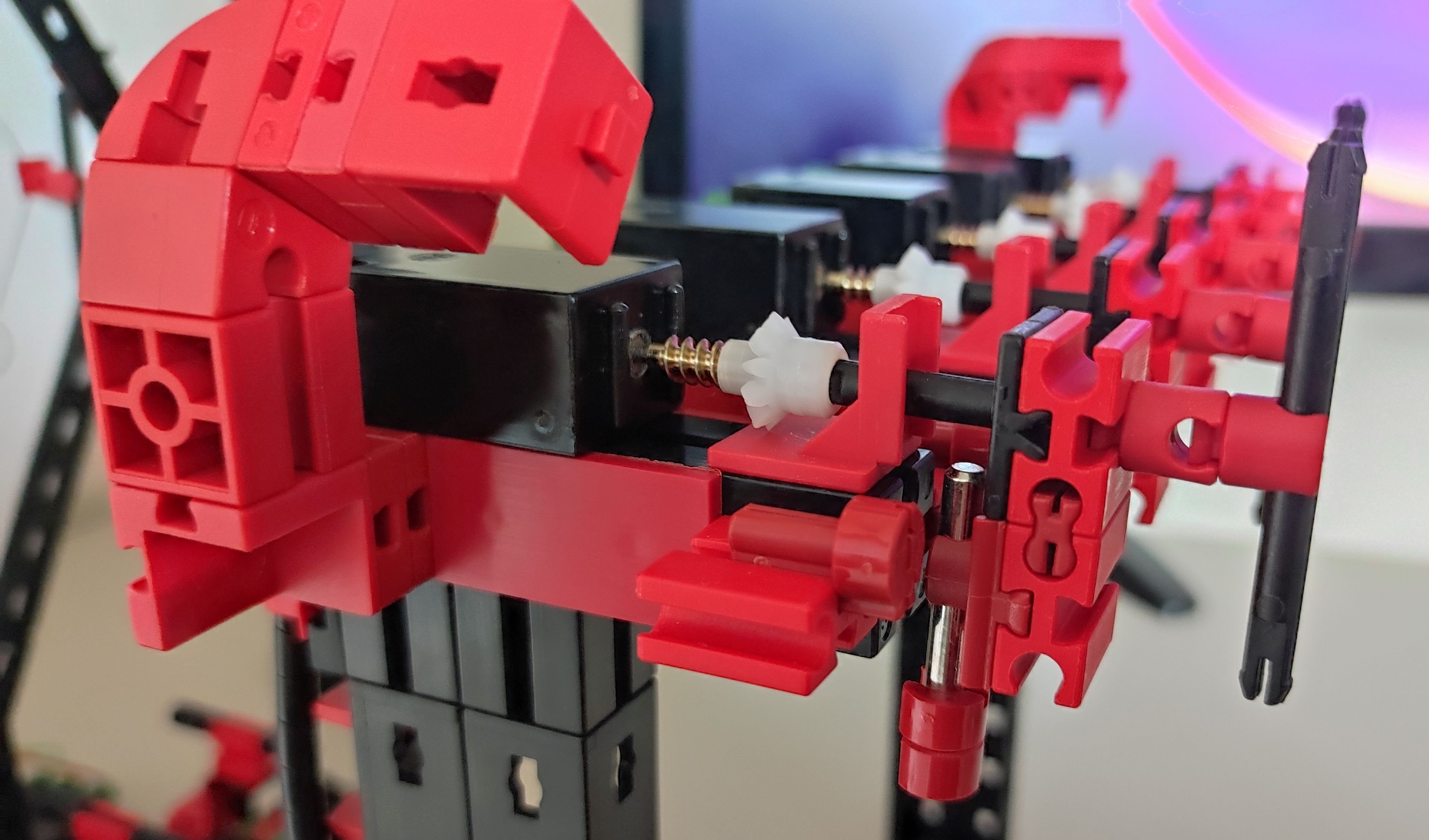

Die Rückseite mit der Technik wäre natürlich auch interessant. Gibt es da eine Rutschkupplung oder fahren die Motoren an einen Anschlag und brummen dann vor sich hin?
S-Motoren an Metall- oder Rastachsen koppeln geht z.B. mit Silikonschlauch. Siehe ft:pedia 2011-01 Kaulquappen(1), letzte Seite.

Here is a photo of the receiver (still on a plate 500) with the front panel removed. Harald, hopefully you can see that the connectors 15 with clips act as stops. And you added a good question: I don't hear any hum. Maybe because the switches are on just for short periods (less than a second)?

I forgot one important detail: When a motor is de-energized, the needle goes back to its resting position by using a time-tested principle called "gravity" ;) Each assembly includes a weight made of a block 7.5 with a clamping sleeve where a 30 mm metal axle (with two clips 5) is attached. The picture below shows it in detail, with one of the connectors 15 with clip that stops the rotation.
Metal axle assembly.jpg (877.74 KiB) 16786 mal betrachtet
