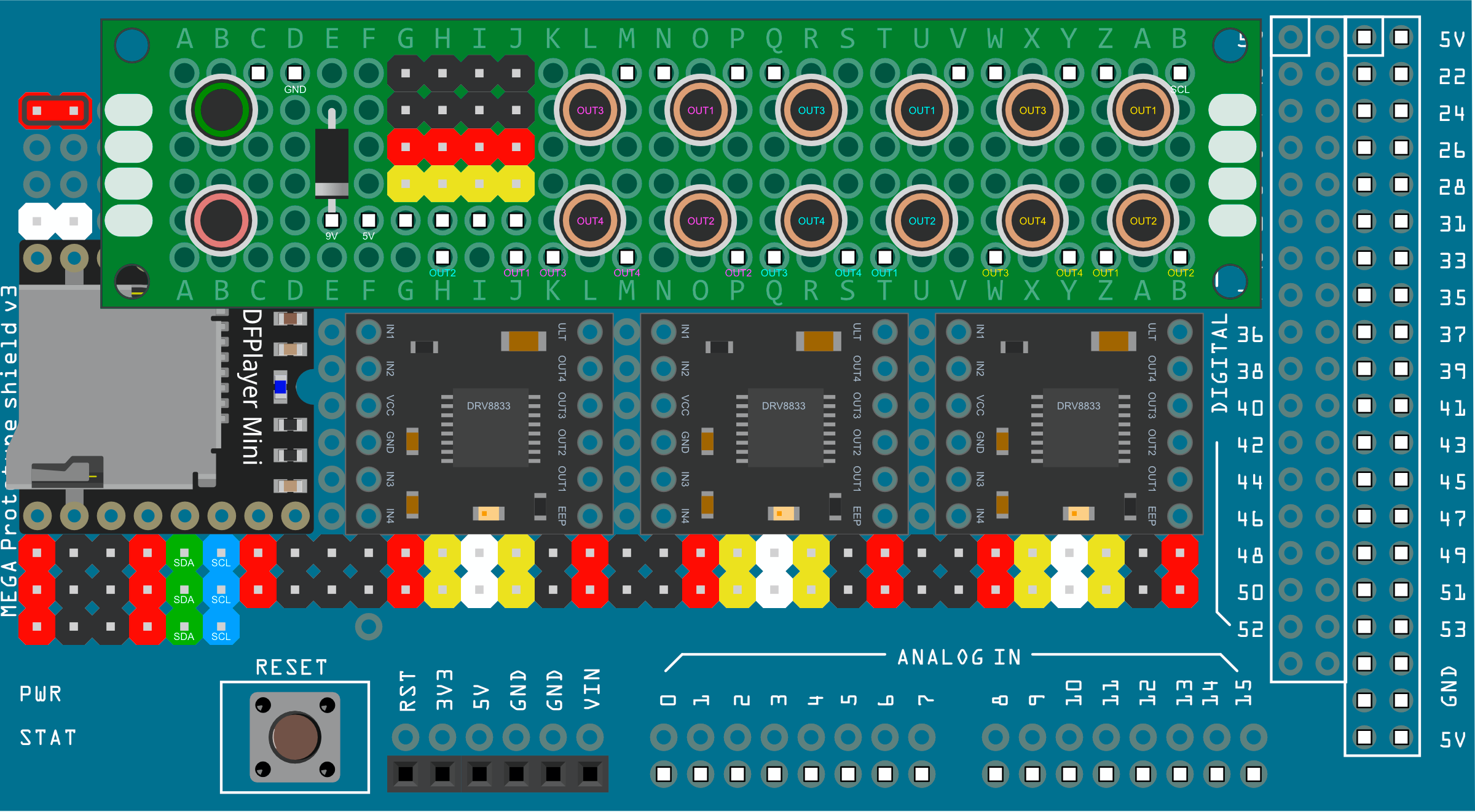

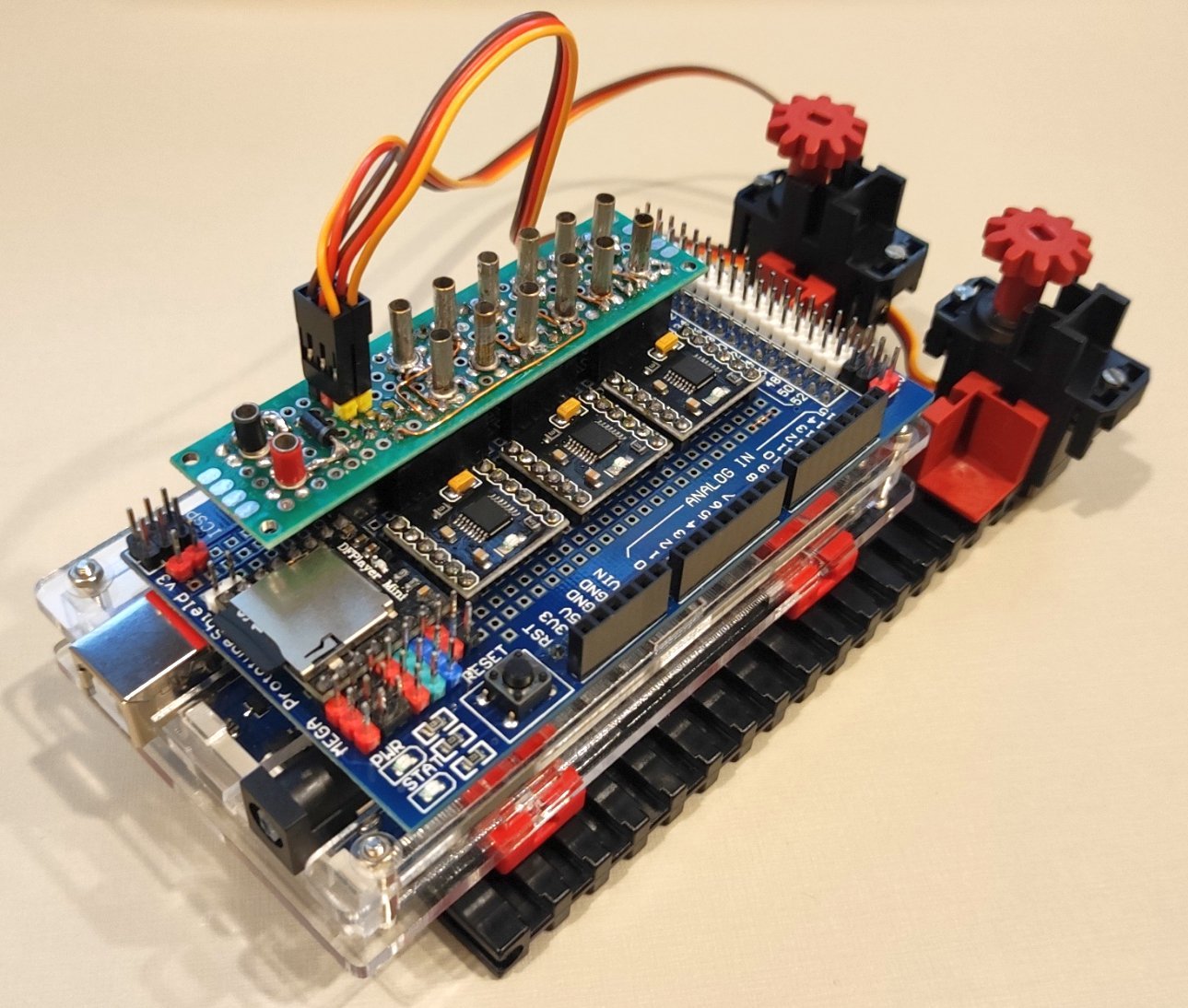

Hi everyone,
I'm building my own controller for a complex project and I thought it would be best to create a new thread.
It is an Arduino Mega clone with a prototype shield on top. The shield received a DFPlayer Mini MP3 module plus 3 dual DRV8833 motor drivers, so this controller has sound and can fully control up to 6 motors with PWM. There are also provision for several I²C devices, analog inputs, digital I/O pins for motor encoders, switches and more. The "mini-shield" on top of it has a 9V input and ft sockets to facilitate the connections to the motors.
Tests are going well, everything is working as expected. Some header pins are still missing, I'll take more photos later.

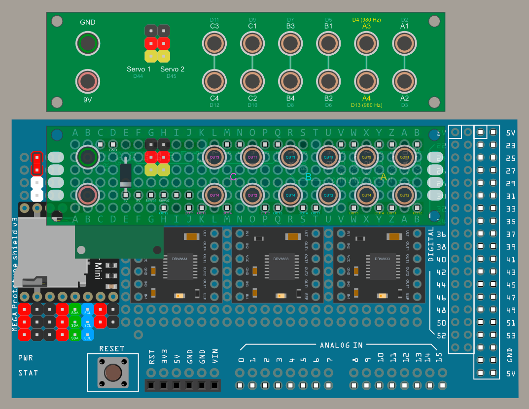

Here is the project layout:
Mega 2560 for ft@2x.png (465.37 KiB) 14516 mal betrachtet
For the project I didn't use Fritizing or similar, just a drawing program I'm quite familiar with (Affinity Designer). So unfortunately I don't have any schematics. This folder contains vector versions of the drawing.
I can provide more details about the boards, so feel free to ask, I'll be happy to help.

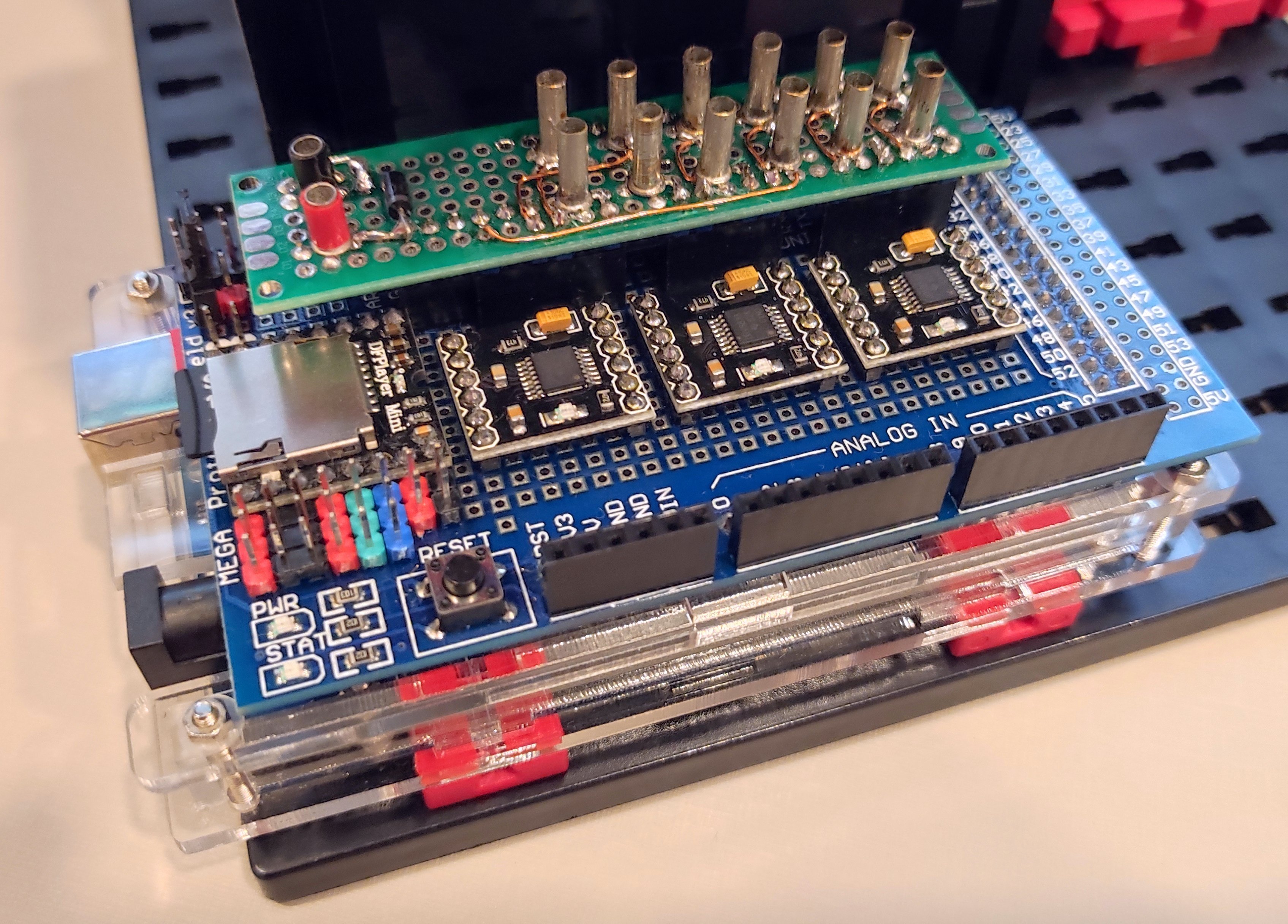

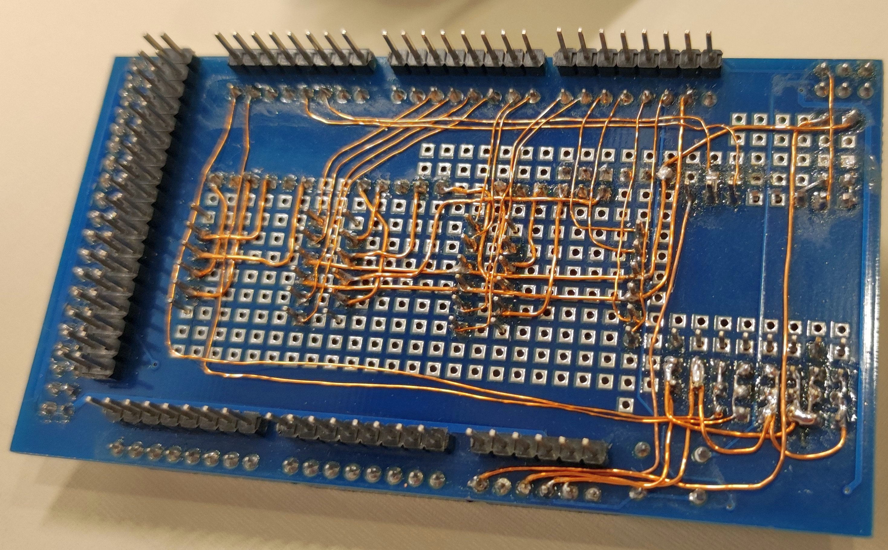

I forgot, the proto shield underside looks like this for now:
------ Google translate
Ich habe vergessen, die Unterseite des Proto-Schildes sieht vorerst so aus:
shield underside.jpg (985.81 KiB) 14513 mal betrachtet

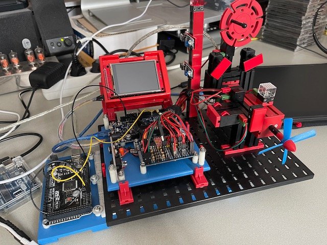

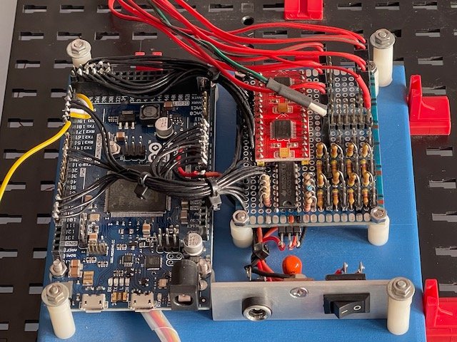

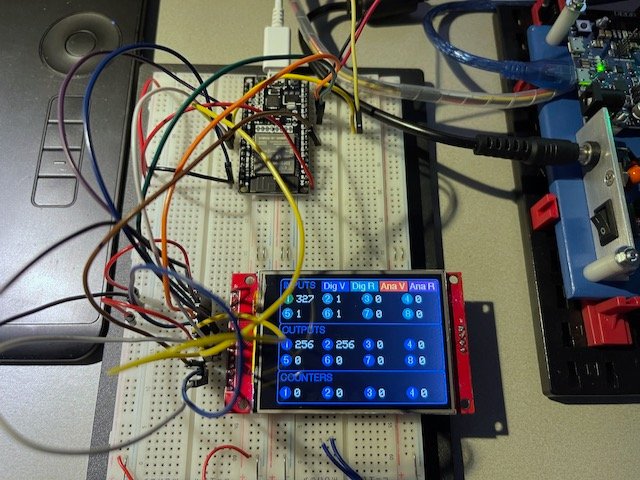

Such a nice project! I think I've gone more or less along the same way before I decided to go 'modular' with my 'Zauberling' modules (ATmega382 inside, 2 motor controls, four analog input, four digital outputs with drivers). Complex projects I mostly build out of concatenated modules nowadays, supervised via I2C if neccessary. But it sure is nice to have everything for one specific project (e.g. with MP3 player in your case) on one solution board! In my case the 16MHz of the Mega (or Uno, or most other Arduino's) 'for all' proofed to be a restriction. So I switched to an Arduino Due (54 MHz) for the more complex and multi-motor controls. For separate tasks (when you use a modular setup controlled over I2C) the 16 MHz per module/task would of course not be an obstacle too quickly. :roll:
Your board reminds me of some "TX-controller simulator" tinkering I did a few years ago because I liked to study the old ROBOpro code for a fischertechnik robotic-kit that came my way. Since I don't have a Windows computer, nor a TX(T)-controller I made this TX-simulator that can be used in 'live-mode' of ROBOpro (in my case emulated in VirtualBox on a Mac):
TX - 1.jpeg (137.18 KiB) 14410 mal betrachtet
The yellow wire used to hook up to a separate display driven by an Arduino Nano. But the 16MHz loop of the Mega was too slow to control all outputs during reliable polling of the inputs, let alone counting pulses of an encodermotor on interupt (and that's only one counting-input used, haha). So later on I experimented with a seperate ESP32-board with a small color display. The displays monitor the configurable inputs and outputs.
TX - 1 (2).jpeg (129.64 KiB) 14410 mal betrachtet
TX - 1 (1).jpeg (123.95 KiB) 14410 mal betrachtet
The DRV8833 is a great choice, but unfortunately only for switched outputs, so the motors will not be able to have variable speed control [My fault, not right, read on]. You might consider the pin-compatible drop-in replacement TB6612FNG that enables you to not only control the rotation direction of your motors, but the speed as well via their additional PWM inputs. The modules don't even differ that much in price!

Arnoud-Whizzbizz hat geschrieben: ↑
04 Mai 2023, 17:55
The DRV8833 is a great choice, but unfortunately only for switched outputs, so the motors will not be able to have variable speed control. You might consider the pin-compatible drop-in replacement TB6612FNG that enables you to not only control the rotation direction of your motors, but the speed as well via their additional PWM inputs. The modules don't even differ that much in price!
Hi Arnoud,
maybe it's a misunderstanding, but of course you can PWM the DRV8833. It just uses a different control logic with only two input pins, which both need to be PWM inputs for full directional and speed control, while the TB6612 uses two non-PWM direction pins and one PWM for speed control.
Great stuff, btw, from both of you!

rubem hat geschrieben: ↑
04 Mai 2023, 23:25
Now it occurred to me, maybe the TB6612FNG has dedicated PWM (not sure, never used it). This can be nice so the Mega PWM outputs may be used for other stuff like servo control. Anyway PWM is working quite well with the DRV8833s.
Yep, both you and juh are completely right! :oops: My introduction to the DRV8833 was when I accidentally soldered it into a Zauberling, while I had planned a TB6612FNG in it where the A and B inputs are only used for direction of rotation (and 'brake' etc). This planted the idea that PWM is not possible, but since it is an H-bridge, you probably might as well control it with a duty cycle < 100% on these inputs. Which is in the datasheets indeed... :roll: Super!
But the main advantage of the TB6612FNG is of course that it only needs only one PWM-signal per motor. For my design that was an advantage at that time. The Mega has 15 PWM outputs, so no shortage there. The Pro Mini Board only has 6, of which 2 are part of the regular SPI bus that I wanted to keep free. And I also liked the idea of having the possibility to connect two servos as well (this design wish was dropped later, because I thought to use a I2C PCA9685 board for that)
So, thanks for the insights, love this forum! Happy Hacking!

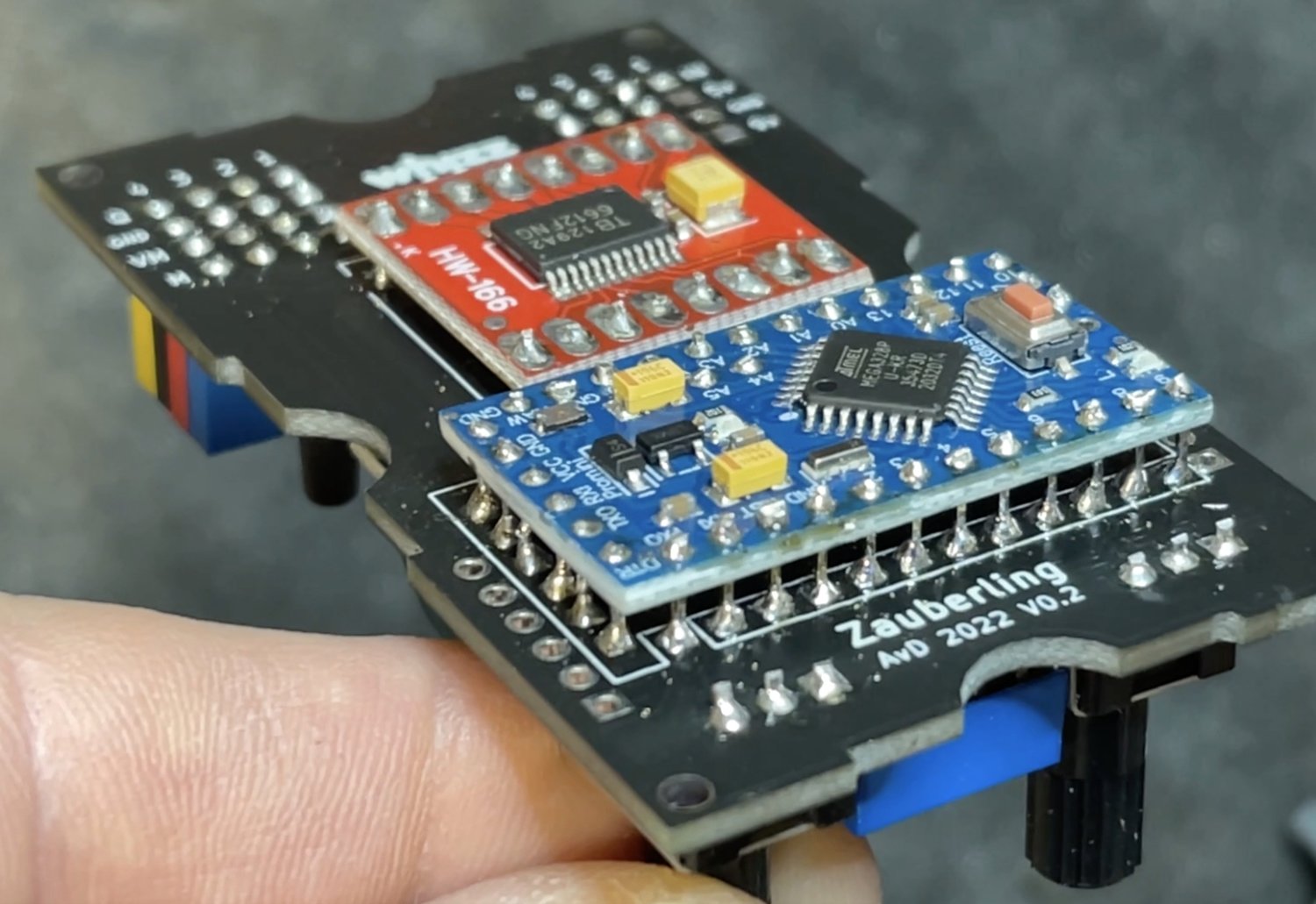

I have this idea of a community-developed "super ft controller" kit including a custom PCB with protected I/O pins, ft sockets and a 3D printed case. The rest would be made of low-cost components: An ARM microcontroller module, motor drivers, servo outputs... Someday I'll find the time to make a rough draft and post it here. Then I'll leave the circuit / testing / etc. for those of you who really know how to do it :lol:
Take a look at https://www.whizzbizz.com/en/the.next.zauberling :lol:

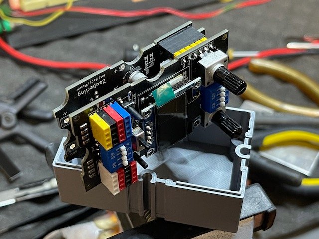

zauber - 1.jpeg (108.22 KiB) 14111 mal betrachtet
The ftDuino was born out of the same wish and is a great candidate as well, of course. So are the various motor shields. A controller based on a Raspberry Pi might also have a lot of potential, but the development of the ftPi (https://github.com/eXpire163/ftPi) seems to be stale for some time now.
But, I completely agree with you that tinkering yourself is always the best. My latest 'Zauberling' is equiped with an ATmega328 board, next generation will have the motor driver and microcontroller boards 100% SMD because assembly is still quite labour intensive. Not yet a production process that can be made 'semi-commercial'... It takes me around 2 days to build one complete module :roll: (even though I sold ONE to someone who absolutely wanted to have one)
Because I wanted to bring together quite a lot on the relatively small front, and wanted the traditional 'Silberling' footprint and interchangeability, I (temporarily) abandoned the ft plugs in this design. Another thing is that I think €0.30 for a 'Bundhülse' is way too much money. So I have already experimented a lot with more useful and affordable alternatives for this. Recently I found a very good alternative, which is also much more pleasant to solder (and keeps the forces of plugging in and out much better from the pcb). I am now developing a module that might 'fill a gap' in the current ft program. So... until then also a little 'secret'. haha. Let me develop it a little bit more, and then I'll tell you more about it. But first I have to finish two other projects (including one where I promised the client another month of 'confidentiality'). :roll: To be continued...

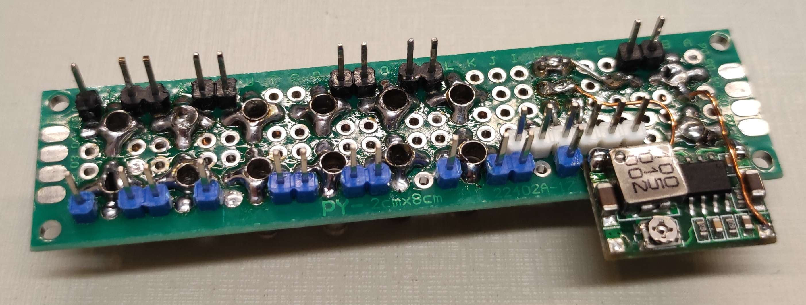

Hi,

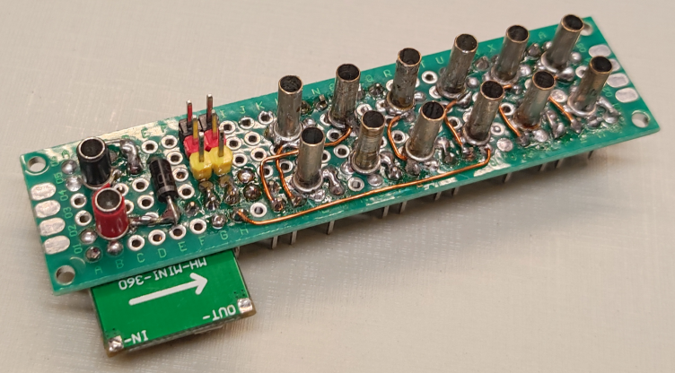

I've added a small step-down to the ft hat board adjusted to around 5.5 V to act as a supply for the servos, see below:
I was lucky I still had space between it and the main shield, because it was an afterthought. The diagram was updated accordingly. I made other modifications too.

Hello Rubem,
that is very useful. Where is the Step-Down-Converter? Is it the small green Board below the proto board?
Florian

atzensepp hat geschrieben: ↑
01 Sep 2023, 09:27
Florian
Exactly. I'm out of town this weekend, I can post a couple of photos when I return.

Here is the top board from the underside:

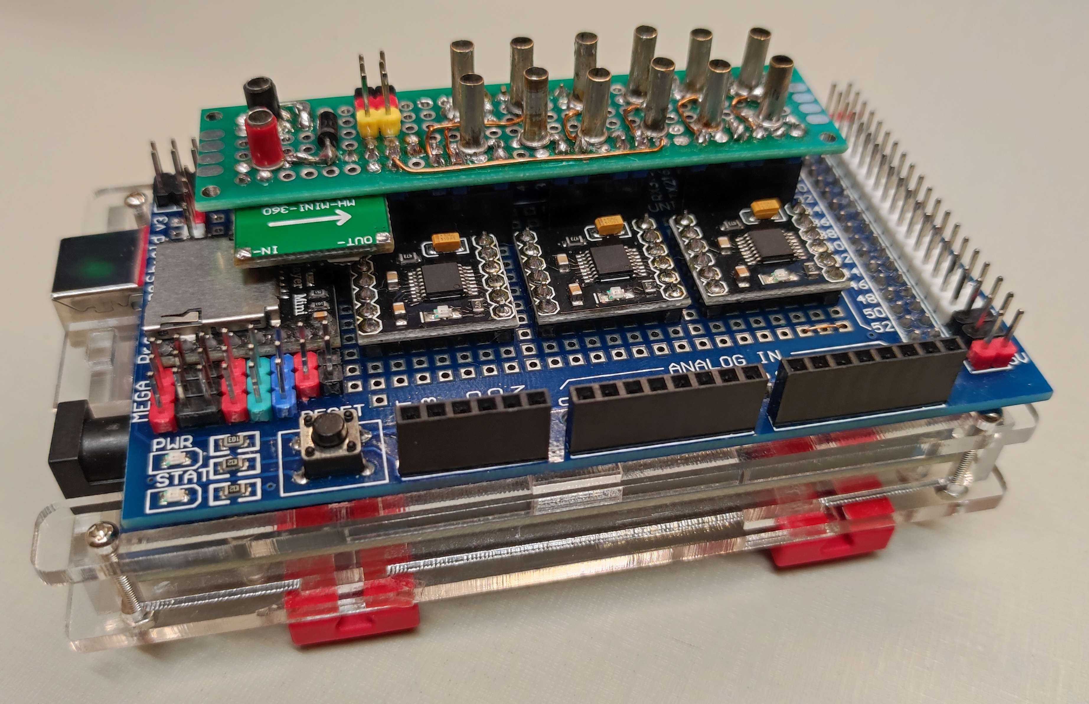

And the whole assembly:
