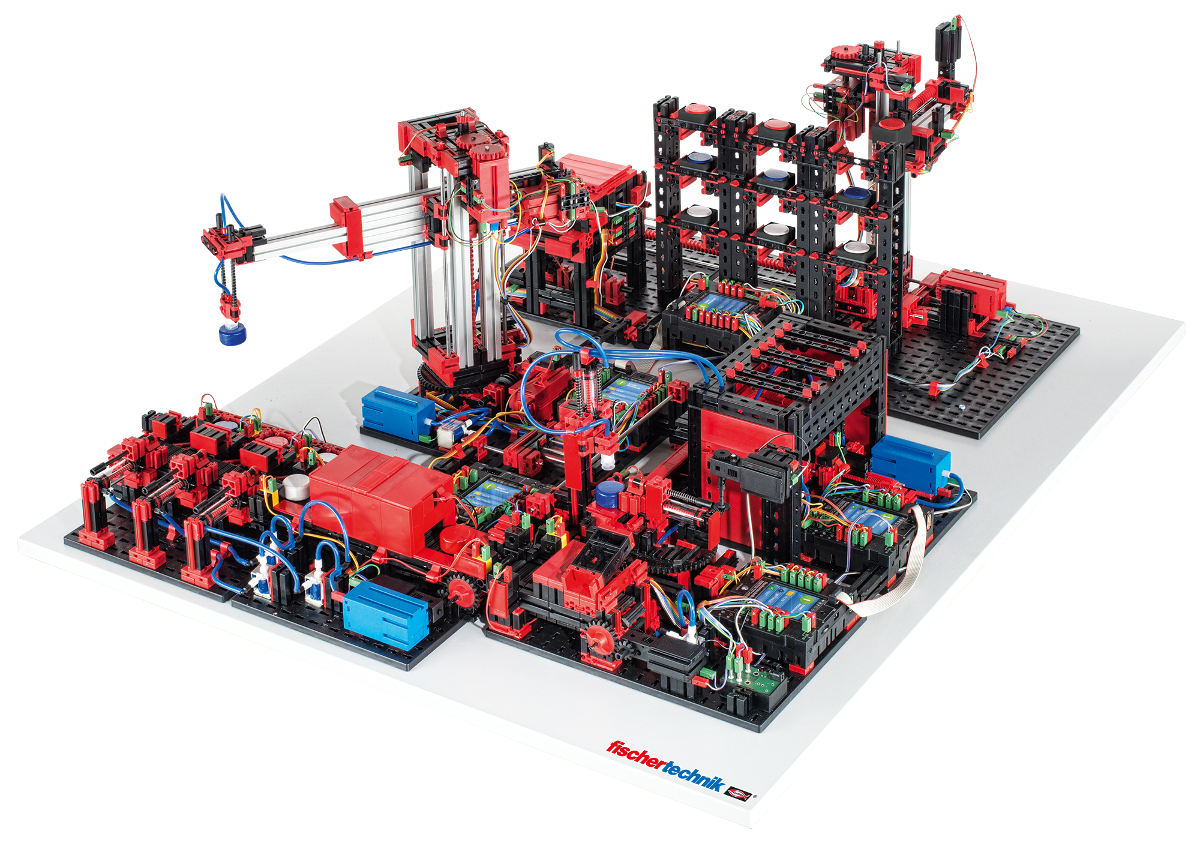

Hello, I am a student tasked with getting a #536629 factory simulation model that has been collecting dust into a working state. It has been very fun but I have run into some issues and have had trouble finding support. I will explain all the steps I have taken before getting to the problem.
When I updated the 5 TXT controllers from 4.2 to 4.7 I, unfortunately, did not save the programs originally on it. I tried the programs in the Fischertechnik github (https://github.com/fischertechnik/txt_training_factory) for the training factory, some of them worked but they seemed to be better suited for the #567769 factory model. That model has other additional parts: a Sensor Station, Delivery and Pickup Station, and is controlled by 6 TXT controllers one of them being a Master controller with a TXTFactoryMain program. The #536629 does not have a "Master" controller as far as I can tell so the TXTFactoryMain does not work for me.
I found the correct manual for #536629 which directed me to the sample programs in the ROBOPro application:
MAIN: SortingLine.rpp, ProcessingStation.rpp, Warehouse_GripperRobot.rpp
EXTRA: Warehouse.rpp, GripperRobot.rpp
I believe there are 3 main programs, as Multiprocessing Station w/ Oven has 2 TXT controllers in a primary/secondary relationship and the HBW and the VGR seem to have a primary/secondary relationship as well. I have the MPO and the SortingLine working and passing the workpiece perfectly.
My biggest problem:
The Warehouse_GripperRobot.rpp program picks up the workpieces and delivers it to the HBW, but the VGR only picks up workpieces in the white section, even when there is nothing to trigger the light barrier the VGR will still go to that place. I have used a multimeter to check that the light barrier works properly and registers when something is there. There are subprograms in the Warehouse_GripperRobot.rpp file that should make it move on to the next color. The HBW also does not go to the next row of empty shelves but stops after the top 3 are filled.
When using the Warehouse.rpp program, it is my understanding that the HBW is supposed to deliver a workpiece to the VGR which then takes it to the MPO to begin processing. From there is gets sorted and the delivered back to the HBW as a 'processed' piece. The HBW pulls a workpiece from storage and loads it on the conveyor belt but the VGR does not move to pick it up/deliver it to the MPO.
I have tried using the GripperRobot.rpp, but it is misconfigured and sends the VGR in wrong directions.
I really appreciate any help or advice the community can offer!

Ich bin mir nicht sicher, welche Anlage du genau hast. Mach mal ein Foto der Anlage.
Ich meine, ich hab zwischenzeitlich alle RPP-Programme runtergeladen. Das wird aber etwas aufwendiger die rauszusuchen.
Es kann sein, das du ein Programm für das -einzelne-/stand alone Modell geladen hast. Die gab es auch.
Ansonsten würde ich fischertechnik direkt anschreiben.

Hallo, vielen Dank, dass Sie sich die Zeit genommen haben zu antworten. Die von mir verwendeten Dateien finden Sie in Windows unter dem Pfad: Datenträger - Programme (x86) - ROBOPro - Beispielprogramme - Trainingsmodelle
Unten ist ein Bild des genauen Modells, das ich verwende.
https://www.studica.ca/en/fischertechni ... lation-9v-
Ich habe fischertechnik bereits kontaktiert und warte immer noch auf eine Antwort per E-Mail.
Wenn Sie mit dem Modell Erfolg haben, lassen Sie es mich bitte wissen. Ich versuche immer noch, es auf meiner Seite herauszufinden. Am Ende schreibe ich vielleicht einfach mein eigenes Programm, um das Modell auszuführen. Kennen Sie Ressourcen oder Beispiele zum Schreiben von Programmen in C oder in ROBOPro für die TXT 4.0-Controller? Ich habe Ihr Buch zur ROBOPro-Codierung gefunden (https://ftcommunity.de/knowhow/computin ... dingklein/). Gibt es eine englische Übersetzung?

Die Anschaltplatinen auf den einzelnen Modellen sehen nach früher 24V Lernfabrik aus...
Die Wareneingang/-Ausgangsstation fehlt.

Hallo,
Ein kleiner Hinweis:
der TXT 4.0 und der TXT haben zwar einen ähnlichen Namen, die beiden Kontroller sind jedoch sowohl in der Hardware als auch in der Software sehr verschieden.
Viele Grüße
Torsten
auf diesem Bild erkenne ich keine TXT 4.0 Kontroller, sondern TXT Kontroller.

@beepere
Your picture shows the original 9V factory (with TXT) which is using the ROBO PRO program set mention already by you.
(His successor was a 9v Factory 4.0 (with TXT and a MQTT interface, written in C++).)
I have worked with both and gave professional technical support for these factories on two institutes for higher education.
There exist some mechanical issues and calibration issues.

Du hast recht, ich habe die Dokumentation zu diesem Modell noch einmal durchgesehen und festgestellt, dass sie immer nur als TXT-Controller bezeichnet werden und TXT 4.0-Controller ganz anders aussehen. Danke für den Hinweis!
Ich glaube, ich war verwirrt, als ich mir die Handbücher für die anderen Modelle ansah.

Just to clarify, can this system use C programs? or does it only use the ROBO PRO programs?
Thank you for taking to time to reply!
Re: #536629 Factory program issues // Probleme mit dem Werksprogramm
Hi,
Best,
Torsten
TXT Controllers can be programmed with RoboPro, Python (ftrobopy) and also with C or C++. fischertechnik also released the TXT-C-Programming-Kit a while ago. I don't know the current download link for this package, though.
Best,
Torsten
Thank you for showing me these resources, I have had a lot of trouble finding things on my own. It's all been very helpful and I think I am going to review the examples with C/C++ and ftrobopy and write my own programs for this model. I've spent too much time fighting with the ROBO Pro programs
The RoboPro programma is very well programmed and not to difficult to understand.
The 9V factory (TXT) and the 9v factory 4.0 (TXT) are using the same building blocks.
But the last one has been extended with the camera and the RFID card reader.
The wiring between the building is a little bit different.
It is possible to use the C/C++ program but you need to change the program a lot.
If you have the original 9V factory (TXT) the best idee is to use the RoboPro program.
The main problem will be the mechanical issues and not the RoboPro program.

Thank you everyone for your help!! I understood that the ROBOPro programs should work perfectly fine but I couldn't figure out why it was always getting stuck. Turns out there was a piece over the receiver of the white phototransitor in the sorting line machine that was ill-fitting and covered the receiver and sent signals that it was on all the time. Once I removed the piece everything works perfectly except for some small calibrations.
I hadn't thought to check it sooner because I'd used a multi-meter to check that signal was being passed and verified an on/off change, but it turns out it would only turn "off" for a couple seconds and then turn back "on". I caught it in the interface test later when I was going over each connection, kind of a silly end but I appreciated all the help!
