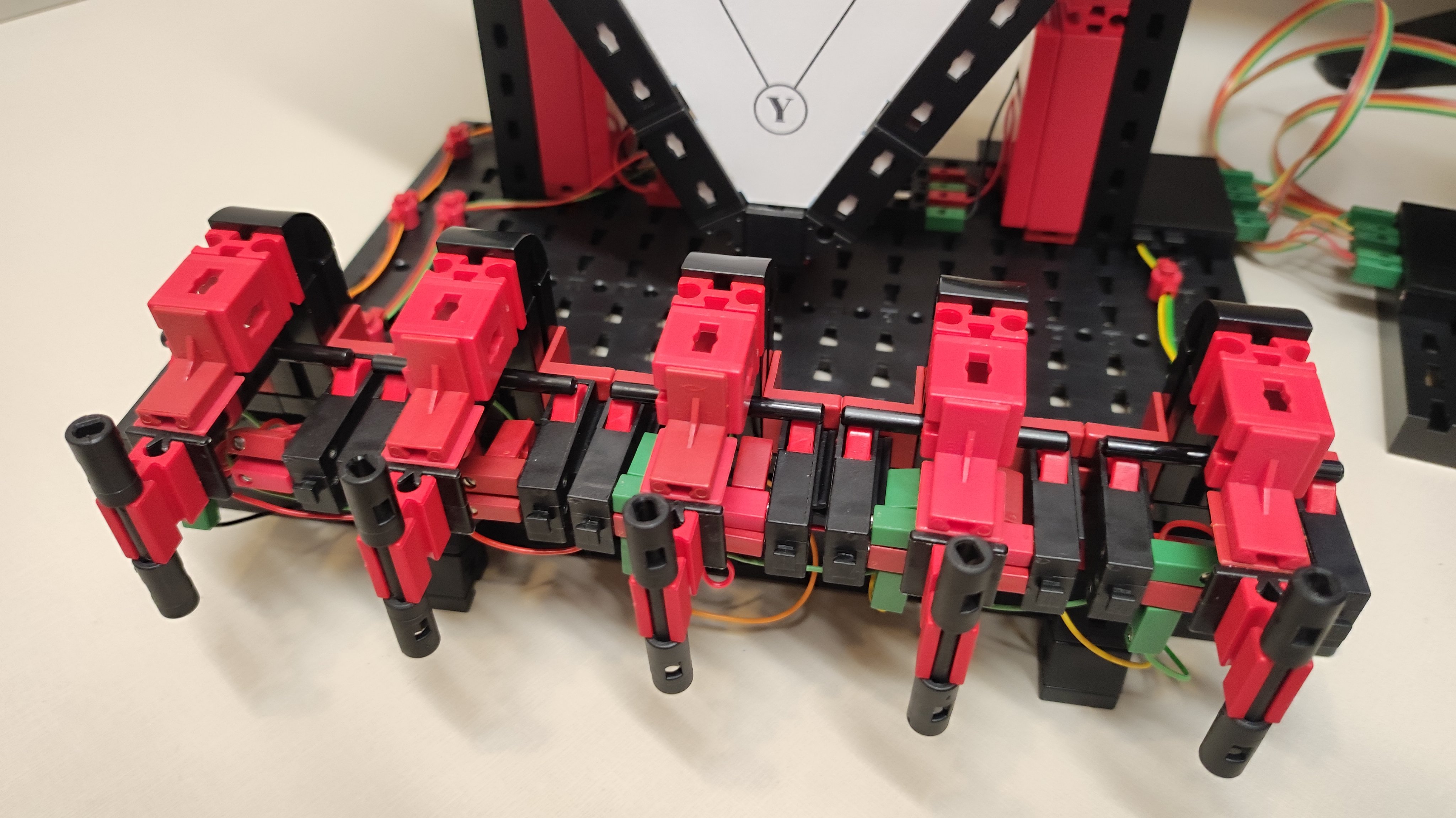

In the original, two buttons must be pressed for a character to be transmitted. I added rotating handles to press the buttons, both to avoid short-circuits (which are very likely to happen otherwise) and to make transmission more user-friendly. Turning a pair of handles each time drives two motors on the transmitter and two on the receiver, sending one character. The whole switch assembly can be pivoted for easier storage. The panels are printed on 240 g paper and have lines, circles and typography similar to the original. Five needles give only 20 characters; I decided to copy the original English layout (which omits the C, J, Q, U, X and Z, so it can't quite spell "fischertechnik" :sad:). Perhaps some of you will try a German version with different letters? A bigger, 6-needle model which would allow up to 30 characters.

Exactly! The rotatable handles are kept in the middle position by default because of the springs inside the mini-switches. They are connected to horizontal plastic axles that rest on the switch buttons, one at each side. Here they are in their default position:

cheorl
Beiträge: 146
Registriert: 03 Jun 2024, 17:51
Wohnort: Dritter Stein, der einen Stern umkreist, der vor Ort als Sol bekannt ist.
Re: Vintage 5-Needle telegraph model / Vintage 5-Nadel-Telegrafenmodell
Beitrag von cheorl » 22 Dez 2025, 23:13
Moin Rubem,
👌😀👍 Nice pictures ❗
👌😀👍 Schöne Bilder ❗
Grüß, Cheorl
