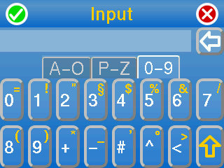

Oh, and Richard just told me how to rotate the screen to landscape orientation:
Log into your TXT using ssh. Then
Code: Alles auswählen
sudo nano /etc/default/launcher
and enter the desired screen rotation (0/90/180/270)
SCREEN_ROTATION=xx
Save the file and restart the launcher by issueing
sudo /etc/init.d/S90launcher restart
Thanks, Richard!

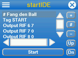

PS. looks like startIDE is the first app to have a dedicated screen layout for both portrait and landscape screens :mrgreen:
[/b]
Zuletzt geändert von PHabermehl am 30 Sep 2017, 22:52, insgesamt 2-mal geändert.
viele Grüße
Peter
Benutzeravatar
PHabermehl
Beiträge: 2639
Wohnort: Bad Hersfeld
Re: CFW weekly builds
Beitrag von PHabermehl » 30 Sep 2017, 22:05
Please be aware that the landscape oriented on-screen keyboard is NOT contained in yesterday's build. It will be part of the next weekly build.

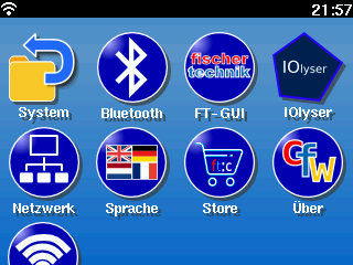

Big news behind a small icon:
Use the Display config to calibrate your touchscreen or to rotate the display:
viele Grüße
Peter
