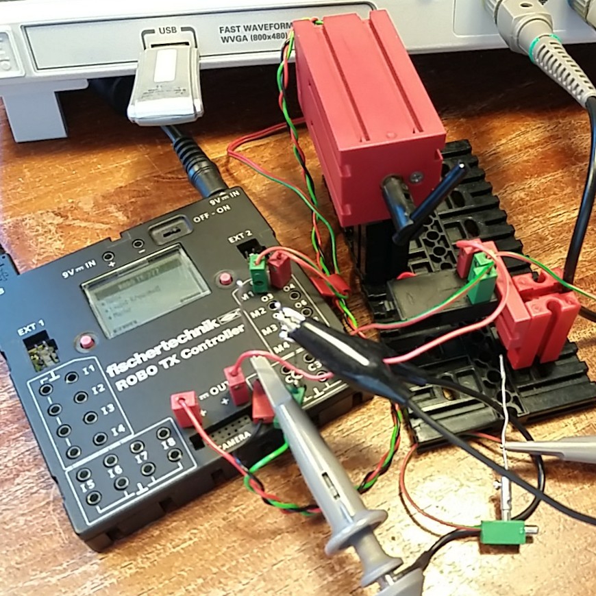

Today I made a test to measure the accuracy of the FT encoder motor FT135484. This is an encoder motor that can only deliver pulses, but contains no direction. The TXT Controller has its own function to control the starting and stopping of the motor. We already know from other reports that this is not always so precise. I have created a small test program and extra hardware for the measurements.
This test measures the FT encoder via the TXT Controller and the FPGA measures the same rotations via a hall quadrature encoder. The FT encoder give 76p/turn, the hall quadrature encoder 40p /turn. The program rotates 2 revolutions forward and 1 revolution backwards each time. After 100 times the program stops. Both encoders can be read in real time. After 100 times we see an error of 9 pulses which is indicated by the hardware encoder. These 9 pulses correspond to (9*76/40) or 17 pulses on the FT encoder. However, it is the FT encoder that is not correct. The FPGA quadrature encoder is error-free. The hardware quadrature encoder does not work with interrupts on the edges of the encoder, but with level changes. There is a home point on my hall encoder disk. Because of this I can see the drift that is developing. The errors occur in the TXT controller when starting and positioning the motor. Sometimes a few pulses are seen too much, sometimes a few too few. The errors are not greater with long rotations. The hardware quadrature encoder is read out via the I2C connection. Errors are not constant. Sometimes the deviation is larger, sometimes smaller. This makes it somewhat unreliable.
Here a picture off the setup:
HD version: https://www.flickr.com/photos/fotoopa_hs/30012681758
The program:
Bigger version: https://www.flickr.com/photos/fotoopa_hs/30012681808
The next test I'm going to make is the synchronous control of 2 motors.
The software version is: RoboPro 4.4.3
Frans.

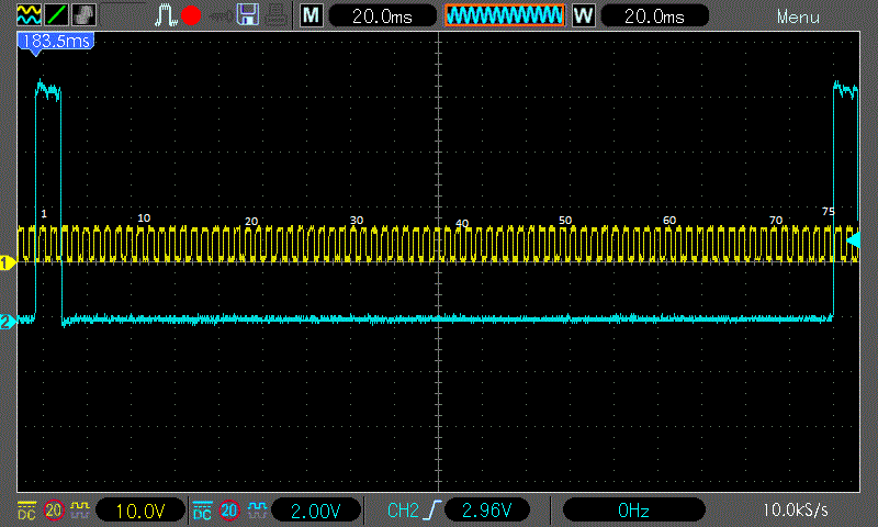

New measurement of the Fischertechnik motor encoder FT134484. For comparison I use my hardware hall encoder via the FPGA. The Ft encoder has 76 cycles/revolution, my hall encoder has 10 cycles but as it uses quadrature detection it corresponds to 40 pulses per revolution. The measurement clearly indicates these values, 76 pulses for the Ft, 40 pulses for the hall encoder.
Results of the logic analyser measurements:
HD version: https://www.flickr.com/photos/fotoopa_hs/28965019107
Frans

Re: TXT Controller and I2C speed
Hi Frans,
This 75 vs. 76 pulse phenomenon is really kind of weird, so I also have done some measurements: First I requested in a tiny RoboPro program the extended Motor control to drive a distance of 750 pulses and checked the counted pulses provided by the RoboPro Counter input element.
=> The motor does reproducibly 10 revolutions without any visible deviation and the counter input also reports the expected 750 pulses, sometimes 751 … ok.
A 10 count deviation would translate into an obvious 10/75.5*360 = 48° offset. I haven't seen that.
This is absolutely consistent with the ft documentation:
Mhmm, has ft silently replaced the 25:1 by 25 1/3:1 gears? That would be rather mean.
But maybe there's a mechanical problem in your model. The ft encoder is firmly attached directly to the motor shaft, whereas it looks like that your DIY reference encoder is connected via one of those flimsy ft clip couplings to the gears of the motor. This might cause lots of backlash, from both, the gears and the coupling. This might spoil your measurements when accelerating or braking the motor or even when changing the direction.
But this couldn't explain your 76 counts in your logic analyzer measurement. The pulses are distributed so evenly that I assume that the motor was running at constant speed and that there weren't any backlash caused fake counts. You don’t have any slippage in the drive train?
That's really strange. I would peek into the motor just to see what kind of gears are installed and maybe I would ask ft if they have changed anything.
Kind Regards,
Helmut
I have also repeated your independent "logic analyzer" measurement. Ok I took my China scope and a simple one-pulse-per-revolution-reference-encoder, i.e. a ft pushbutton switch as can be seen in the photo, and counted the pulses manually. The motor was running continuously => My result is 75 pulses. So my encoder does definitely 75 pulses per revolution.The encoders on the fischertechnik encoder motors generate three pulses with each revolution of the
motor shaft. And because the encoder motors also have a gearbox with a transmission ratio of 25:1
(meaning "25 to 1"), then one revolution of the shaft, which comes out of the gearbox, corresponds to
75 pulses of the encoder.
Kind Regards,
Helmut
Hi Helmut,
Many thanks for your new measurements. This morning I took new measurements with both the LA and the scope. I had told you that there was an anomaly, my homepoint was always shifting. even with 76p/turn. To have no more errors at 100 revolutions, I need to enter 76,1666p in the TXT, so 7616 p/100 revolutions. With the scope I can make measurements over 6 revolutions. This brings me to 457 pulses of the TXT Controller. The sync is done with the hall detector homepoint. There is no friction, the encoder distance is 1.5mm.
I have 2 encoder motors (FT135484) and have now measured both of them. The results are the same. I also tested it at lower rotation speeds, even then the results remain constant.
All measurements are made during constant rotation, there are no start or stop periods in the measurements and there are no changes in friction. The encoder for the hall detectors is simply placed on a shaft directly on the motor. As shown in my previous images. I have no explanation for this peculiar value, but 75p is not correct with my encoder motors.
I can follow the real rotation visually via the homepoint. If the hardware counter shows too few impulses, you will see that the disk had too little rotation. If you manually rotate the disk until the homepoint is in the correct position, the hardware counter will give the correct value. My encoder motors were recently purchased (22 Apr 2018) via Amazon.
Because I also had position problems with the robot kit, I controlled the motors from my own hardware. The commands were then transmitted via the I2C connection.
Start, stop and back-slash for the Motors were arranged in the FPGA. If the direction was negative, I first went a little further negative, then again in the other direction. This function was automatically included in the FPGA for each motor. There were adjustable parameters for the distance, and speed control.
Update:
After many tests I still found the exact value to use (I suppose) for the encoder motor FT135484. The real value I measure is 76,16666 pulses per revolution. This perfectly matches my own hardware quadrature encoder mounted on the motor. After 200 revolutions, the error is still zero. I still don't understand how Fischertechnik comes up with this 76,1666 value. But all measurements point in the same direction. I tested 2 different motors, with different set speeds. Every time I arrive at the same results. Even with measurements over very long periods, the results remain the same.
Test setup program:
Frans.
Update:
Test setup program:
Frans.

Update:
However, I still have to remark that my measurements with 76.2 have a small deviation. With 76.16 I don't have that mistake. It could be that the motor reduction value is actually rounded off and therefore slightly lower. In a test with 30480 pulses, an error of 13 pulses was measured. With 30467 (76.1666 x 400) pulses the error is null. Smaller distances give proportional results. The error is therefore not caused by starting and stopping.
Frans.
