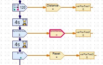

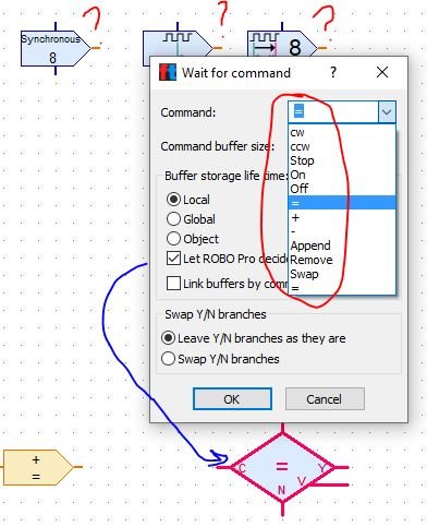

I was busy with creating an simulation subroutine for the FT-motor and the Ft encoder motor.
I discover that the list in the two RoboPro filter elements are not covering all the commands.
I looks like that RoboPro is a little bit out date concerning command handeling.
I hope that these command will add to the list.
Missing are:
  • Synchronous
  • Reset
  • Distance
Command filter
Command filter
Command branch filter
2020-04-19 Workaround for this problem, add the commands manual to the filter.
I tested this.
This will give a problem when the used language in RoboPro has been change
Workaround
Workaround
