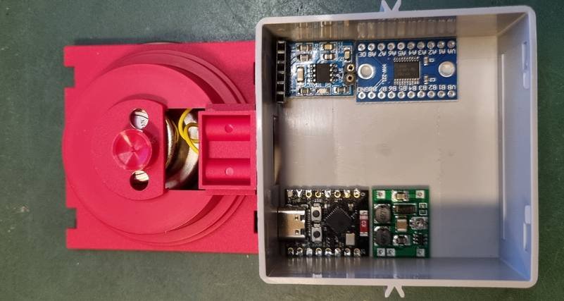

Proof of concept, well at least that it could fit: ESP32 mini, step down converter, amp module, and (5V<>3,3V) level shifters for the input signals, space at the right for maybe 6 to 8 ft 2,6mm or even more dupont connectors. Not much space left for cabling, tho. :lol: The amp is analogue, a digital I²S module would probably better, they are not much larger.
Would be a shame to slaughter the original housing, though, so a printed custom one would be called for.
