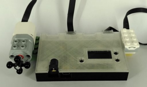

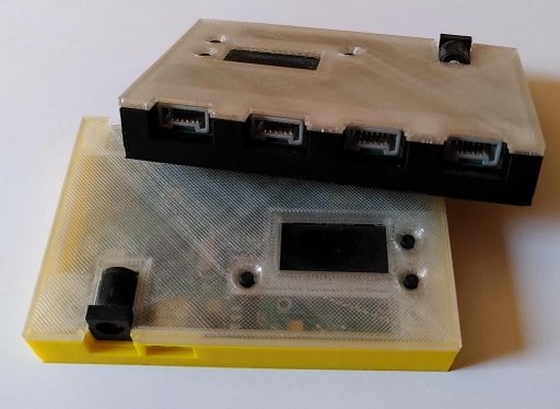

Connection Lego and Fischertechnik.
By combining both systems we can enjoy their advantages. The data and command exchange occurs on 2 levels. There is a serial duplex connection via the hubE and the DE0-Nano_Soc board. On the other hand, the data lines of the other hubs are also read by the board. The latter can thereby process data in real time and without interaction of the running software. This data can mainly be used by the TXT Controller to display the results on the PC screen. Motor speed, position, sensor color information, distance information and pressure can all be read out. From the Lego side there is no need to write a program. The DE0 board simply listens in real time.
The DE0 board responds very quickly ( only a few usec). The connection is via 115200 baud but can be much faster if needed. I now need to work out some protocols to build a large application.
BildLego-Fischertechnik by Frans, on Flickr

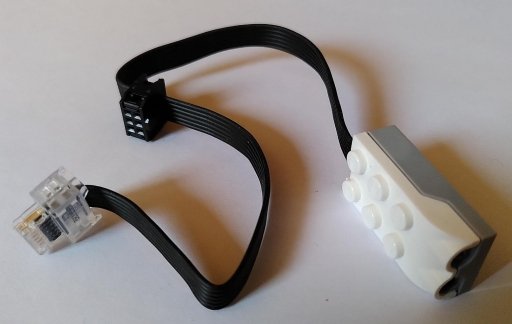

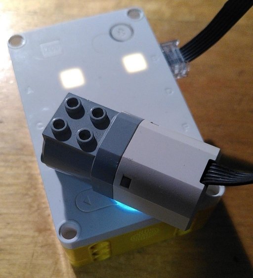

The WeDo 2.0 motor being detected and used by the Spike:
Believe me, they are all compatible. I own them all :-)

Surely a photo like this is convincing.

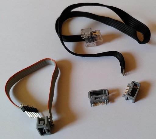

This means that this extension cable would fit on the Mindstorms 51515 hub : https://www.toypro.com/nl/product/7355/ ... 35cm/zwart
That one is in stock there. Still, those cables have a little locking tab that is not there on the new sensors and motors. I wonder how it goes then, or does it not interfere.

That is no extension cable. The WeDo2 and it's peripherals have the same connectors as the spike. It fits directly.
Yes I understand that. But my question was if these extension cables fit. I am looking to cut them and put a pcb in between to reach the connection points. I want to have pin5 available from each hub to send to the FPGA for listening in on the lines. I suspect that those indicated cables are not going to fit
I checked that uPIDE for a while but for now I don't understand how everything works. Looks way too difficult for me right now to start it up.
Benutzeravatar
MasterOfGizmo
Beiträge: 2726
Re: Lego-Fischertechnik.
Beitrag von MasterOfGizmo » 16 Mär 2022, 17:45
The cables you linked to are for a he NXT which In turn is the predecessor of the EV3. It will not work with the spike. You need power function 2 (pf2) cables and connectors. I only found them in china
But if you just want to get access to the signals you can mount a standard 6 pin flat cable connector onto the Lego cable. The Lego cables have standard 1.27mm spacing and these headers fit just fine.
uPIDE will just work without setting up anything. But if you are happy with the Lego software there's no reason to switch.

Beitrag von MasterOfGizmo » 16 Mär 2022, 18:00
An image is worth a thousand words. So ...
This is a single BrickDuino, a ftDuino like device, but for Lego:
Two of them:
Some LEGO powered up / power functions 2 connectors from china:
A LEGO sensor with a standard 6 pin connector in the middle for quick access to the signals:

MasterOfGizmo hat geschrieben:
16 Mär 2022, 17:45
Okay that's clear. I expected them to be NXT types and therefore not usable. I could also use the solution with the 6 pin standard on the flat cable but it can cause mounting problems if you want to build the original models. Therefore I have not yet modified any of the original motors or sensors supplied with the kit. The best solution is like your female conectors from china. But ordering something from china is not possible here. My wife would rather not have it. If I could buy it locally then it would not be a problem.
For the uPIDE, I'll see later. There are other Python solutions but they require a hub software update. You can always restore it but I'd rather wait. I still need to learn first the Python language sufficiently.
Thanks for the helpful clarification.
