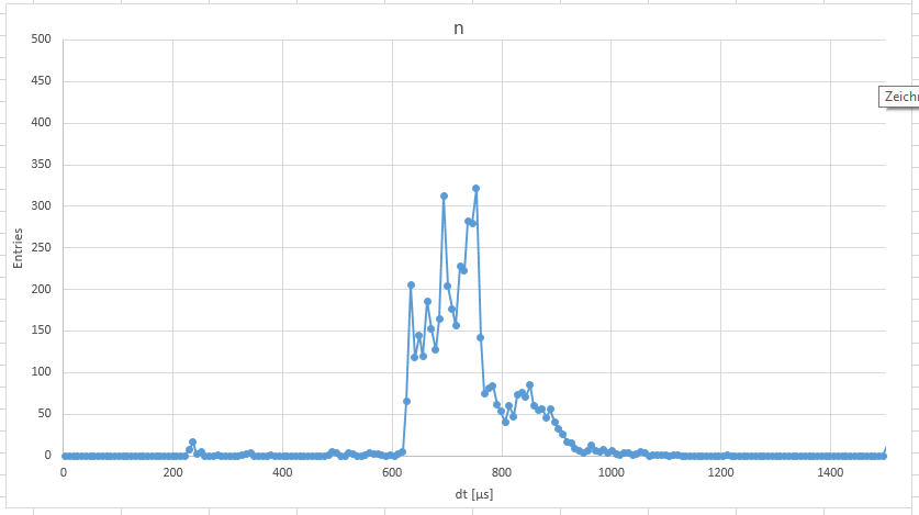

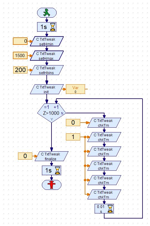

I did some timing measurements on the Shared Library interface:
The test program performs every 10ms a six times burst call of the SLI function "chkTm" that just measures the time between its calls in microseconds and enters the result into a histogram. So we get 5 timing measurement each burst every 10ms. This approach simulates a real life application and shouldn't overload the TXT.
The time needed for plain clock and histogram access has also been measured: 3µs-4µs

The result doesn't look that promising:
About 600µs-1ms for one call to the Shared Lib!
So transmitting five parameters to the lib would take about 3ms-5ms.

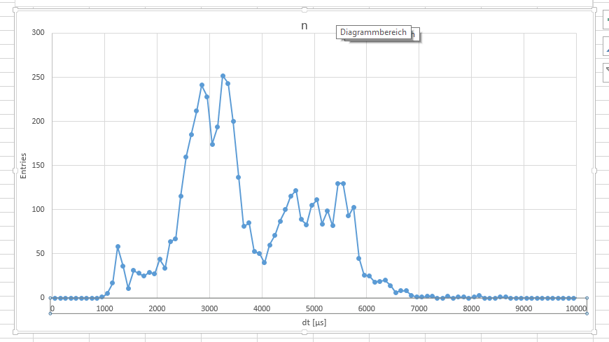

This was Offline mode, with the logging screen detached from the expensive serial console.
I've also tried to activate interface locking in the RoboPro Lib access elements, but that doesn't make any difference.
Online the situation is even worse, there it takes a few milliseconds:
Code: Alles auswählen
histogram entries, average, standard deviation, median, minimum and maximum
  n=5000
avg=3749.835200
sgm=1243.389060
mdn=3409.500000
min=929.000000
max=11585.000000
