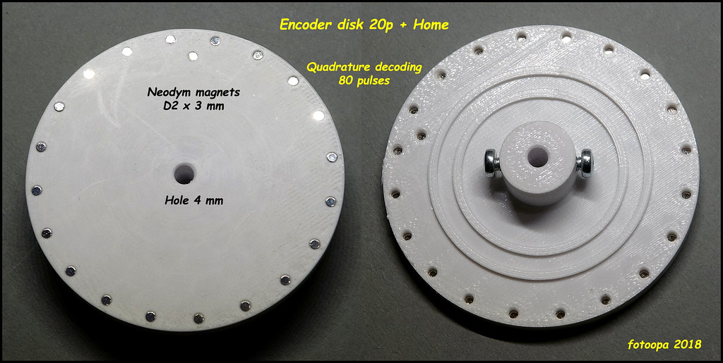

I just put most of the 3D files for encoder disks and decoder modules online:
https://www.thingiverse.com/thing:3168028
A few pictures:
HD version: https://www.flickr.com/photos/fotoopa_hs/45474048501
HD version: https://www.flickr.com/photos/fotoopa_hs/45474048771
HD version: https://www.flickr.com/photos/fotoopa_hs/45474049041
The dual decoder module is made to fit all disks. There are built-in 3 pole female connectors for the connection. If you need a home point you can use the single decoder module. Mounting is Fischertechnik compatible. All holes must be drilled to the correct size. The Neodym magnets D2x3mm can be pressed in nicely. The hall chips are unipolar, note the magnet polarization!
