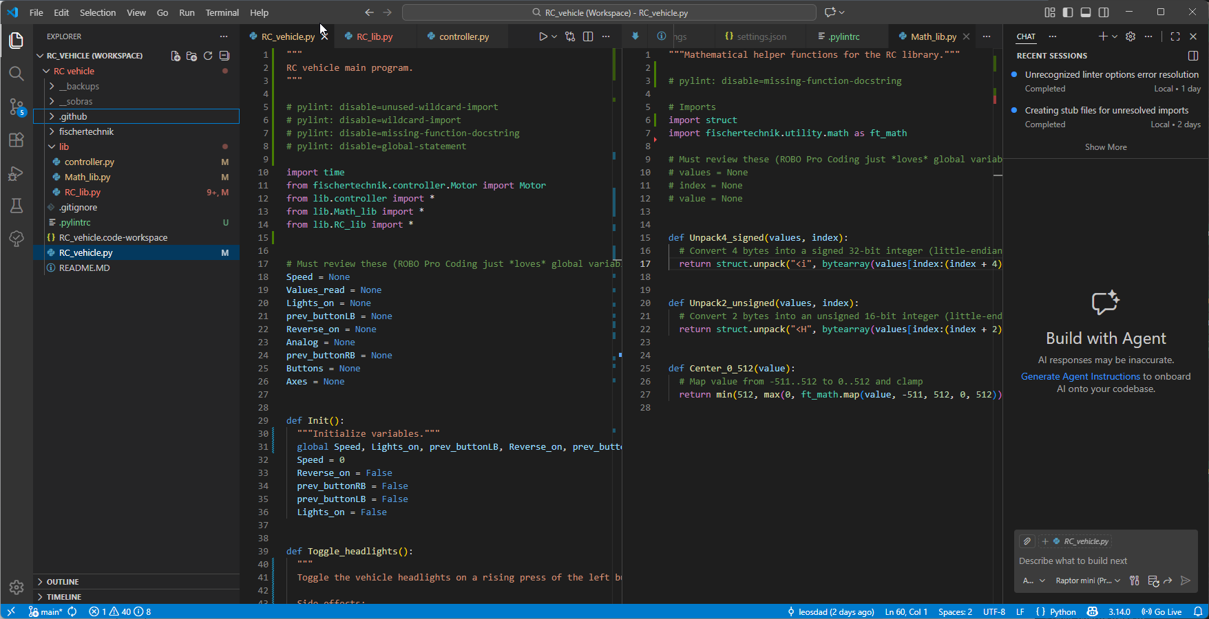

@Vleeuwen, I've already seen your post some days ago but it seems me that you are trying to run VSCode on the TXT (please correct me if I got it wrong), which should be quite interesting but it's not what I'm trying to accomplish.
Here is a reduced screen of VSCode running in my desktop. Whenever a file is edited or added to the project, WinSCP (not shown here) uploads them to the TXT4 automatically. Then I touch the button on the TXT4 screen to start the program.
@Holger, I hope I clarified it.

[Bild]
Hier ist ein verkleinerter Screenshot von VS Code, das auf meinem Desktop läuft. Immer wenn eine Datei bearbeitet oder dem Projekt hinzugefügt wird, lädt WinSCP (hier nicht abgebildet) sie automatisch auf die TXT4-Datei hoch. Anschließend tippe ich auf den Button im TXT4-Fenster, um das Programm zu starten.
@Holger, ich hoffe, ich konnte es verständlicher machen.

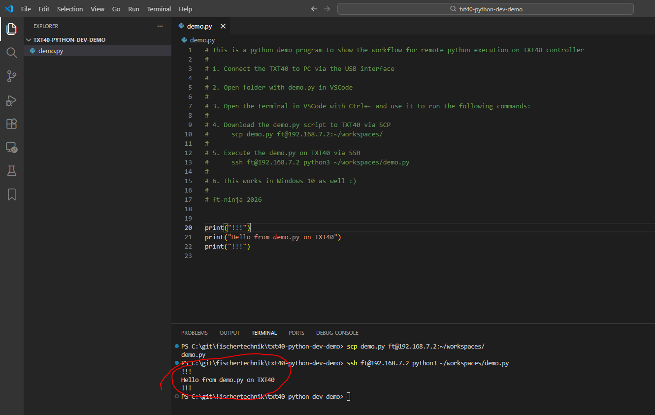

Does anyone know how to run a Python program and display the results on WinSCP's console?
Not sure if it helps with observing output in WinSCP, but you can observe the output from your python program right in the VSCode if you start this program on the TXT40 via the SSH. I've provided a demo.py script for you. Please follow the comments:
Code: Alles auswählen
# This is a python demo program to show the workflow for remote python execution on TXT40 controller
# 1. Connect the TXT40 to PC via the USB interface
# 2. Open the folder with demo.py in VSCode
# 3. Open the terminal in VSCode with Ctrl+~ and use it to run the following commands:
# 4. Download the demo.py script to TXT40 via SCP
#      scp demo.py ft@192.168.7.2:~/workspaces/
# 5. Execute the demo.py on TXT40 via SSH
#      ssh ft@192.168.7.2 python3 ~/workspaces/demo.py
# 6. This works in Windows 10 as well :)
# ft-ninja 2026
print("!!!")
print("Hello from demo.py on TXT40")
print("!!!")
You can bypass the password entering procedure for SCP and SSH commands by generating a SSH key pair and copying public key to TXT40. Also you can automate those scp and ssh steps using a batch script or Makefile or VSCode Tasks.

@ft-ninja, your solution worked brilliantly! I learned some "new" things in the process, among them a little bit about scp/ssh and how to run a Python command in the TXT4. WinSCP is not needed to upload the files anymore, I wrote a tasks.json to do it and run the code (with the help of GitHub Copilot, mostly using the GPT 5.2 model). Now the result is neatly captured to the VSCode terminal :D
