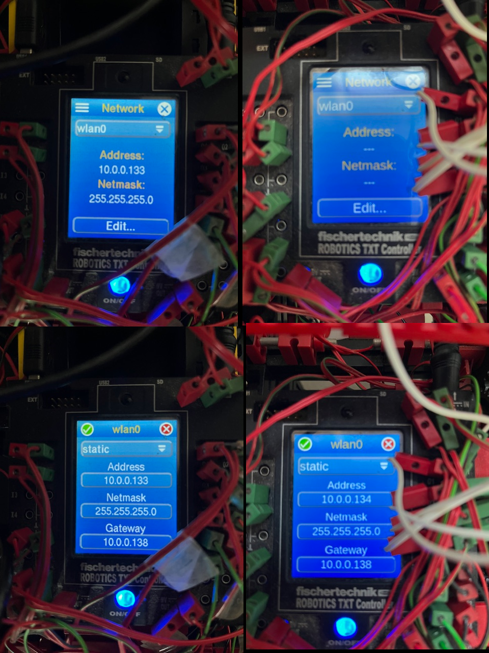

After quite a bit of time, I have made another attempt to regain connection. Which failed. Upon the suggestion, I did not create a new sd card but upgraded the cfw version. Without result. However, since I have 2 TXT's, one of which is working, I made imagess of the network settings of both.
Both lower images are from the screen after pressing the Edit button.
You can see that at left, both IP addresses are shown: it's the correctly working TXT.
At right, the IP address is shown only at the bottom. That's the TXT that fails to connect.
Is there a reason that could explain the difference between the 2 network interfaces, other than that the TXT is broken?

Of course, it could be that something is broken. But I think it is way too early to give up !
You should check if your txt is really connected to the network (e.g. by running `ping 10.0.0.134` or `nmap 10.0.0.134`). It could also be that the wifi password has been entered wrongly - I don't know how this looks like.
If both txt controllers run the CFW, you could try swapping the SD cards and see if the problem also swaps.

The SD Card swap did not move the problem.
Right now the situation for the broken TXT is that the only connection possible is by USB cable (and then often with some IP issues). If you watch my https://www.youtube.com/channel/UCZHm47 ... amY_bVmHYA, you can see some of it. Most of what I do is placed behind cheap paywall.

Maybe a serial connection could help to analyze the problem further. I did that once when I had the white screen problem using a cheap usb to serial converter. I checked the wiring multiple times as I am not that familiar with the txts serial port.

Since the SD card swap didn’t move the problem, firmware is probably not the issue. The missing wlan0 IP points more toward a Wi-Fi hardware or driver failure, and serial boot logs should show whether the interface is failing to initialize.schermo rotto scherzo

I'm convinced it's the hardware. Right now I can only use the USB connection, but even that gives unforeseen issues.
