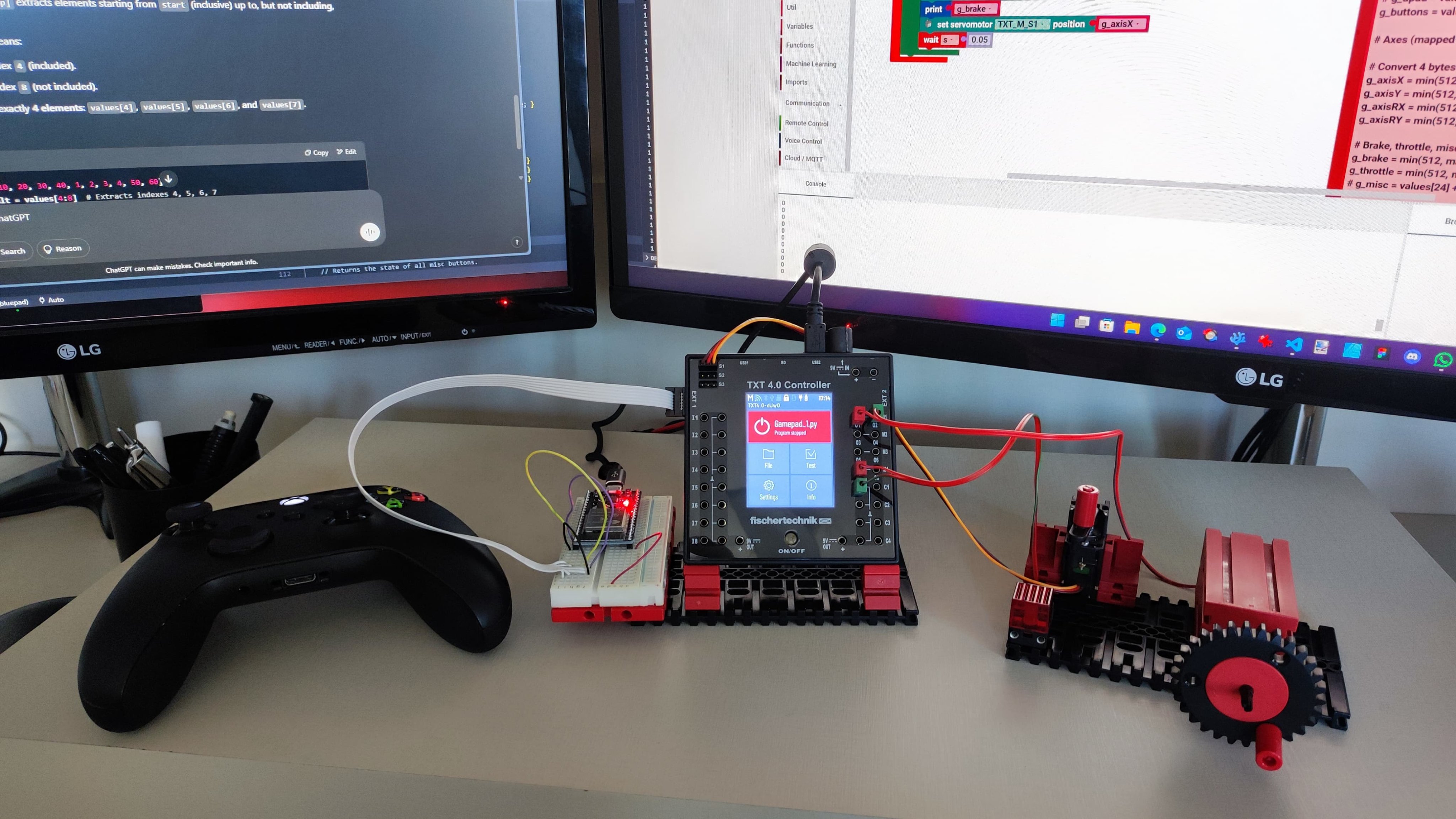

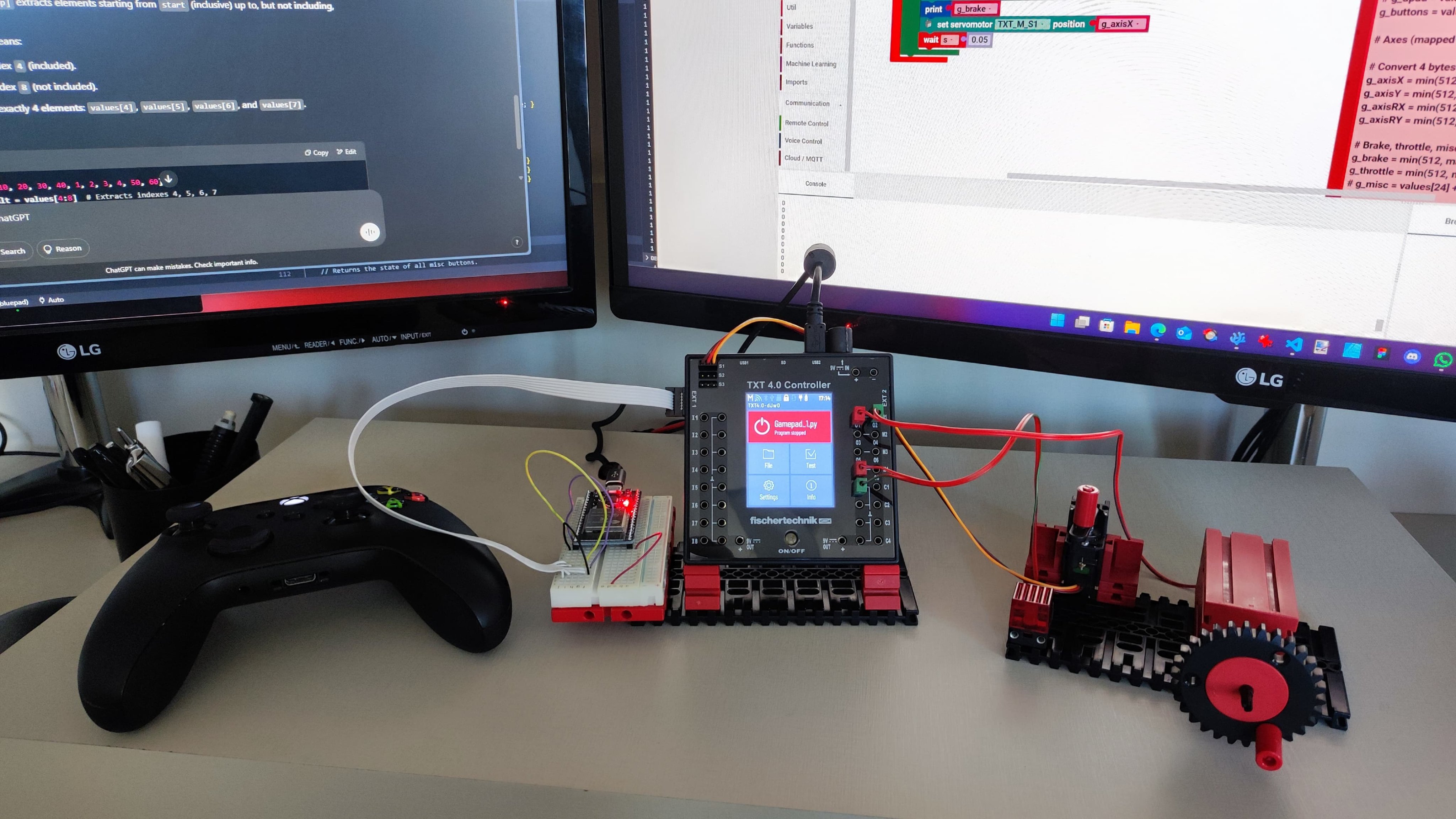

Verfasst: 09 Feb 2025, 21:32
von rubem
Hi everyone,
As a follow-up, and because it seems that the lack of a remote control solution is a hot topic now, I'd like to share the current test setup of my project:
Remote test setup.jpg (1003.01 KiB) 43048 mal betrachtet
After several weekends of trial and error, I was finally able to successfully forward the commands from a Bluetooth gamepad into a TXT 4.0 using a cheap ESP32 module via I²C. I'm still working on it, but the results are encouraging! I can already map any analog input (joysticks, throttle, brake) to the motor speed and the servo position, and use any button to command things like reverse, lamps, etc. Just what I wanted. My Python functions report occasional issues with values outside the allowed ranges and I/O errors, I'll probably be asking for some help soon.
Next step will be to build a case for the ESP32 and an IDC socket, then test the controller with a real model. I'll also be posting the circuit and code for those who wish to make a similar adapter.
Best regards,
Rubem

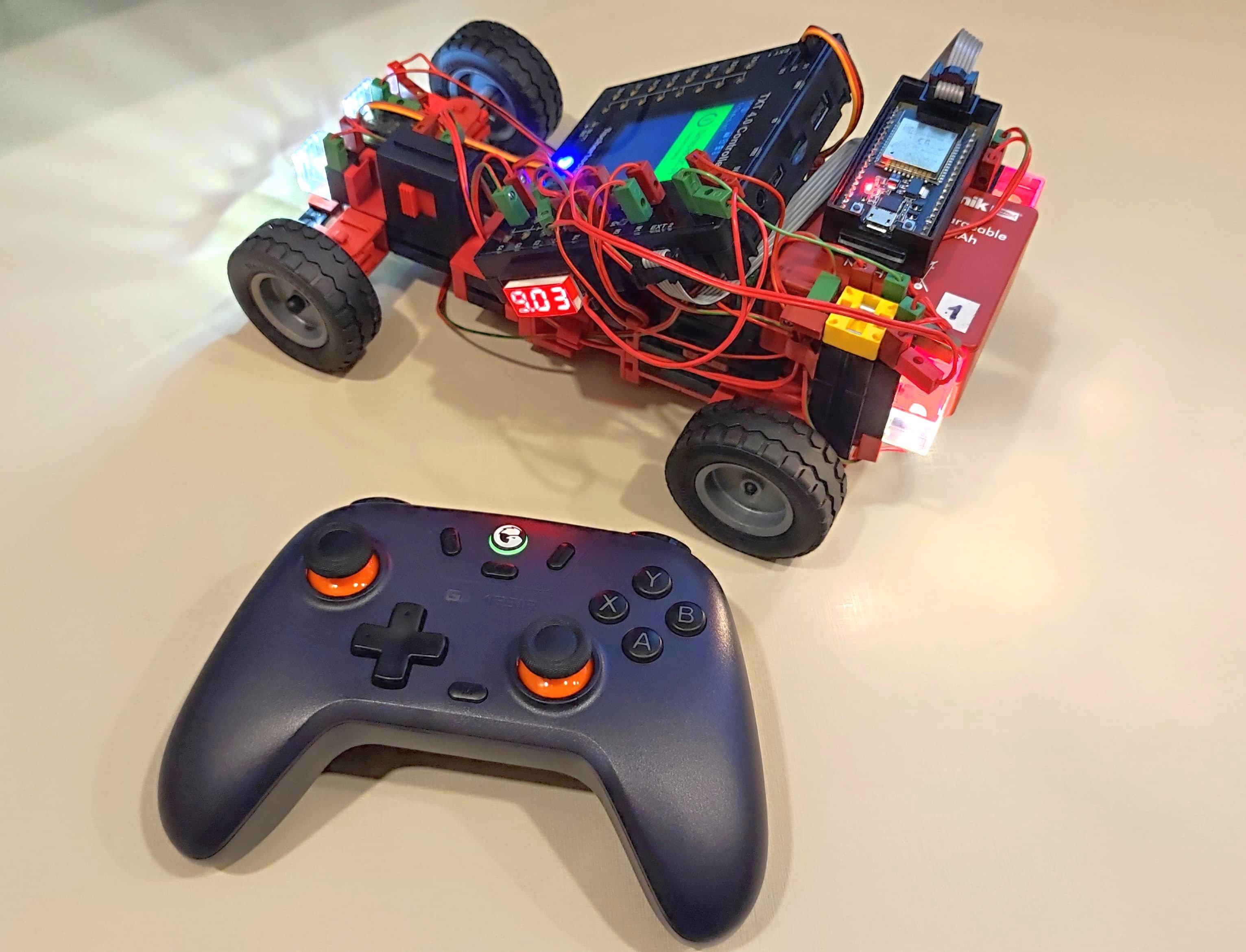

Verfasst: 15 Feb 2025, 23:46
von rubem
Hi there,

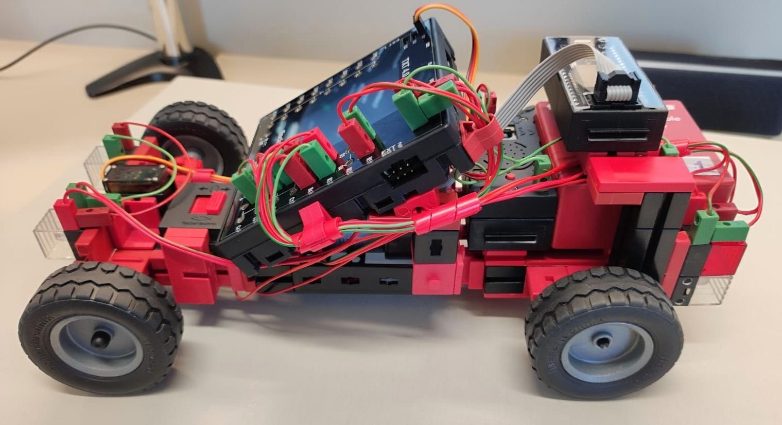

The remote control is now working. You can see that the ESP32 module and the I2C connector fit exactly inside a 30 mm wide ft case.
Test car.jpg (394.96 KiB) 42501 mal betrachtet
I built this simple test car with the following functions, all controlled remotely:
- RT (throttle): Motor speed
- LB: Headlights and taillights
- RB: Reverse with lights
- Left joystick: Servo steering
- A: Internal horn from the TXT4 (takes a long time to start -- I hope ft fixes this)
- B: External horn using a Sound + Lights Module (it's below the TXT4)
In the future I may create some sort of library in ROBO Pro Coding including slow deacceleration, braking, dead zone, gamepad vibration etc. For now I'm very happy with the results. The gamepad works better than I expected, especially the speed control which is very precise.
Regards,
Rubem

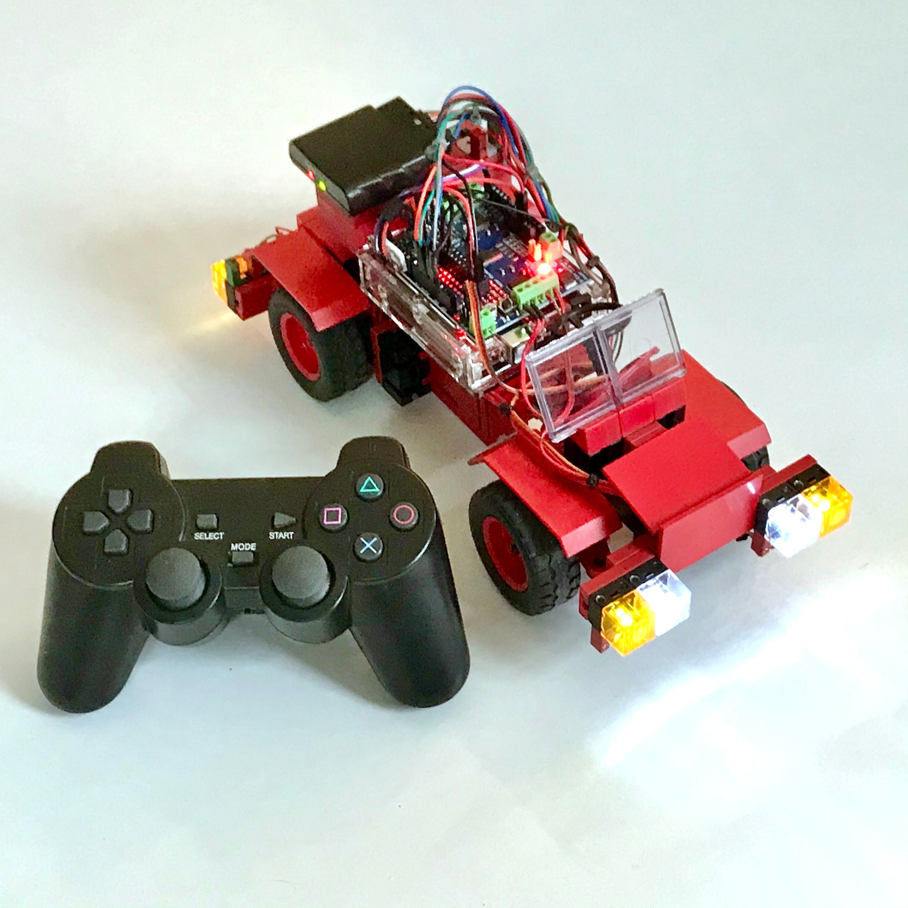

von Arnoud-Whizzbizz
PHabermehl hat geschrieben:
15 Dez 2024, 11:34
I have used wireless game controllers with USB receiver several times so far. Programming was done in Python.
Gives you less headaches...
Ich habe keine Erfahrung mit dem Anschluss einer USB-Konsole an den TXT-Controller (ich besitze keine ft-Controller, nur original Silberlingen :lol: ) und wie dann die Fernsteuerung gestaltet ist (über BlueTooth an einen zweiten TXT-Controller?) und ob das für dieses Modell notwendig ist, kann ich nicht genau überblicken.
Aber ich habe selbst schon oft mit kabellosen Controllern für Modelle experimentiert. In ft:pedia 2020/4 kann man über meine Experimente mit dem kabellosen PS2-Gamepad lesen, und in ft:pedia 2021/1 über Lösungen via Bluetooth mit einer selbstgebauten Fernbedienung mit einem Arduino Joystick-Shield.
Inzwischen wurde ich von mehreren Leuten gefragt, ob es nicht möglich wäre, ein universelles Modul zu entwerfen, das die Nutzung der kabellosen PS2-Gamepads ohne separaten Arduino erleichtern würde, also z.B. eine Empfängerplatine mit (Motor-)Treiberausgängen, auf die das Empfängermodul aufgesteckt werden könnte und die von einer ft-Batterie gespeist werden könnte.
Daran habe ich auch schon gedacht und es sollte auf jeden Fall möglich sein. Ich bin immer noch neugierig, ob es Interesse daran gibt (und welches „Budget“ die Leute vernünftigerweise für eine solche komplett gebaute Lösung haben, schließlich wird es eine handgefertigte Sonderanfertigung sein) :roll:
-----Deepl translation------
With connecting a USB console to the TXT controller I have no experience (I do not own ft controllers, only original Silberlingen :lol: ) and how then the remote control is arranged (via BlueTooth to a second TXT controller?) and whether that is necessary for this model I cannot oversee exactly.
But I myself experimented frequently with wireless controllers for models. In ft:pedia 2020/4 you can read my experiments with the wireless PS2 Gamepad, and in ft:pedia 2021/1 solutions via Bluetooth with a self-built remote control with an Arduino Joystick-shield.
I have since been asked by several people whether it would not be possible to design a universal module that would make it easier to use the wireless PS2-Gamepads without a separate Arduino, So for example a receiver board with (motor-)driver outputs on which the receiver module could be plugged in and which could be powered from an ft battery.
I did think about this prematurely and it should certainly be possible. I am still curious if there would be any interest in this (and what 'budget' one would reasonably have for such a completely built solution, after all, it will be custom built by hand) :roll:
Re: Robot with remote control / Roboter mit Fernbedienung

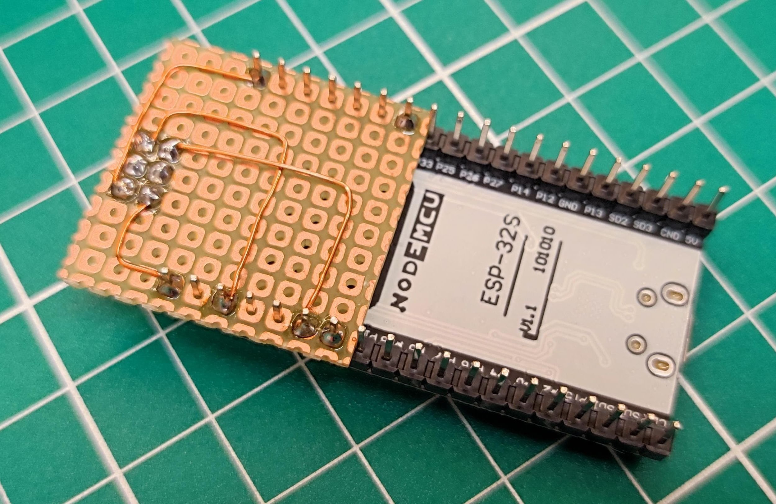

In one of my posts above I already mentioned you, I was able to duplicate your project. It worked well and I even was able to fit the receiver's PCB inside a 60 x 60 enclosure with an Arduino Nano (see photo), but then I was a bit too optimistic... I cut part of the PCB because I wanted it to fit it inside a 30 x 60 housing. I believe the chip couldn't withstand the heat and burned. This happened twice... But I learned a lesson :D
Failed board.jpg (183.2 KiB) 41008 mal betrachtet

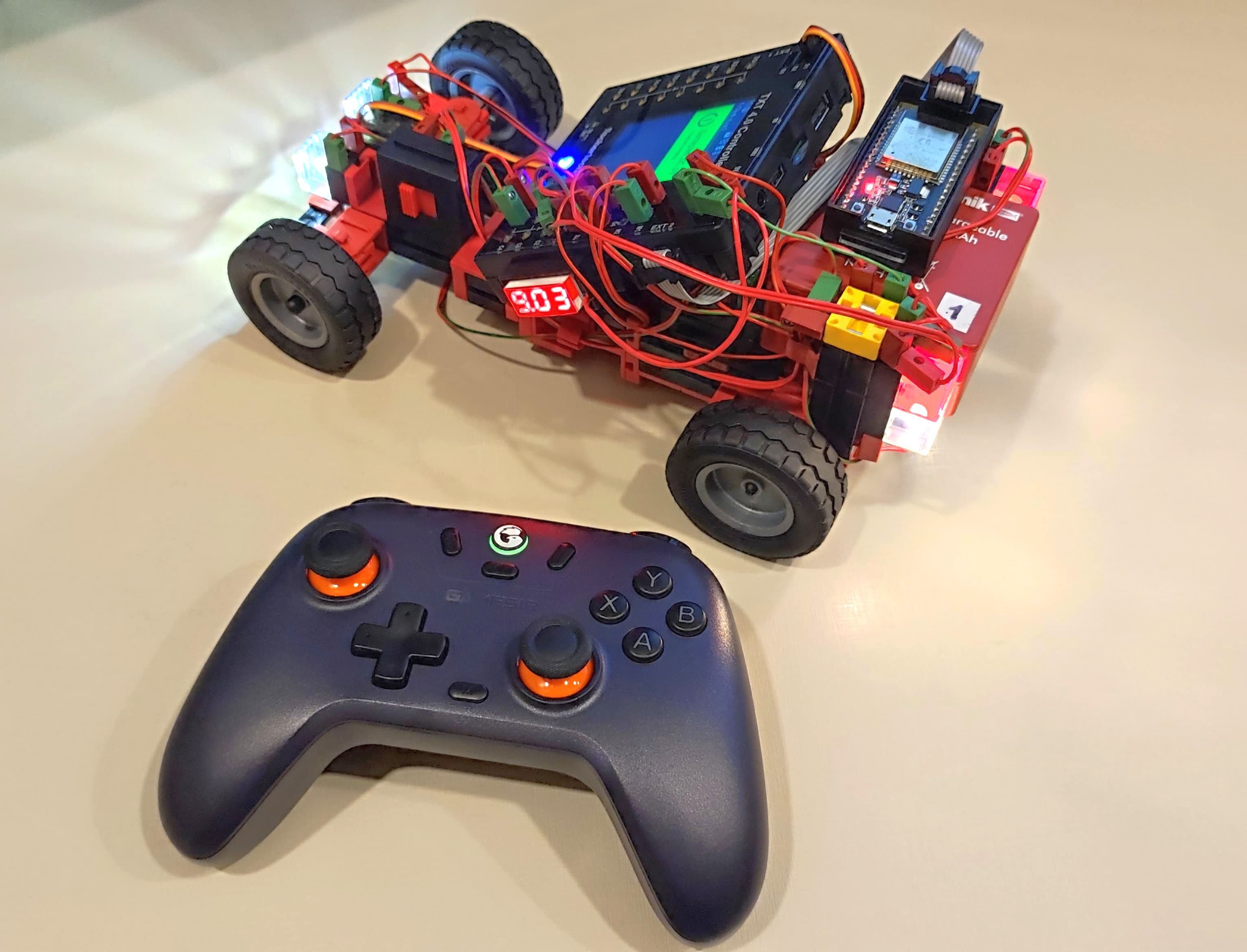

For those who are still following, here is the newest version of the car. The main difference is hardly visible below the TXT4. I've replaced the red encoder motor with a 8:1 power motor and now the car is a racer, it can run real fast. I still can set the speed quite precisely, but of course I must be much more careful when handling the throttle control at lower speeds. I also had to extend the overall length a little bit because of the power motor requirements, so the Sound + Lights Module is clearly visible now. I've also added a transparent cover to the custom ESP32 module.
rc racer.jpg (146.48 KiB) 38557 mal betrachtet
Best regards,
Rubem
Verfasst: 10 Mär 2025, 10:53
rubem hat geschrieben:
01 Mär 2025, 17:01
I had not read it carefully yet indeed. In an earlier post you say that you had also blown one and that they “broke down quickly. So also you experience that they apparently get very hot?
I actually did not have this experience at all. That's why I was wondering: did you put the supply voltage of the receiver module at 3(.3) volts? Revisiting the old schematic, I would even think it would be technically more elegant to run the Data/CMD/Ack/CLK lines through a level shifter (5v<-->3v) if you are using a (5 volt) Arduino Uno.
The whole power supply and interfacing becomes easier if you use a 3.3 volt ESP-32 of course.... And so myself, with a supply voltage of 3.3 volts for the receiver, I have not experienced excessive heat generation.
-----translation-----
In der Tat, ich hatte es nicht richtig gelesen. In einem früheren Beitrag sagst du, du hättest auch einen durchgebrannt und dass sie „schnell kaputt gehen“. Du hast also auch die Erfahrung, dass sie sehr heiß werden?
Diese Erfahrung habe ich eigentlich gar nicht. Deshalb habe ich mich gefragt: Hast du die Versorgungsspannung des Empfängermoduls auf 3(.3) Volt gelegt? Wenn ich mir den alten Schaltplan noch einmal anschaue, würde ich sogar denken, dass es technisch eleganter wäre, die Data/CMD/Ack/CLK-Leitungen durch einen Pegelwandler (5v<-->3v) zu führen, wenn man einen (5-Volt-)Arduino Uno verwendet.
Die ganze Stromversorgung und das Interfacing wird einfacher, wenn man einen 3,3-Volt-ESP-32 verwendet natürlich.... Ich selbst habe bei einer Versorgungsspannung von 3,3 Volt für den Empfänger keine übermäßige Wärmeentwicklung festgestellt.
