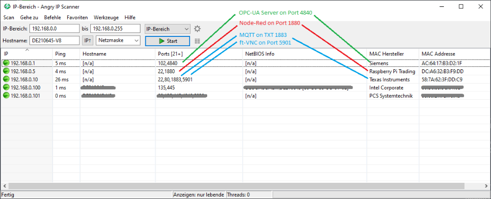

rugee-f
Beiträge: 79
Registriert: 28 Jan 2022, 13:46
Re: FischerTechnik Simulation 24v Factory Siemens 1500 PLC Help!
Beitrag von rugee-f » 21 Feb 2023, 14:04
I documented my network infrastructure.
It should look the same in your case...
