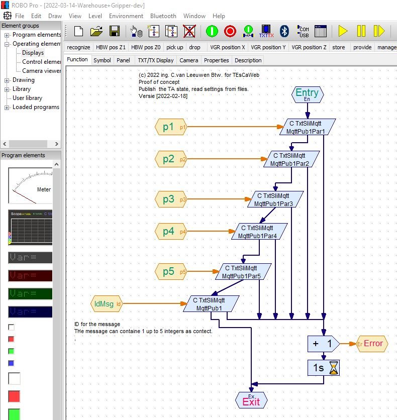

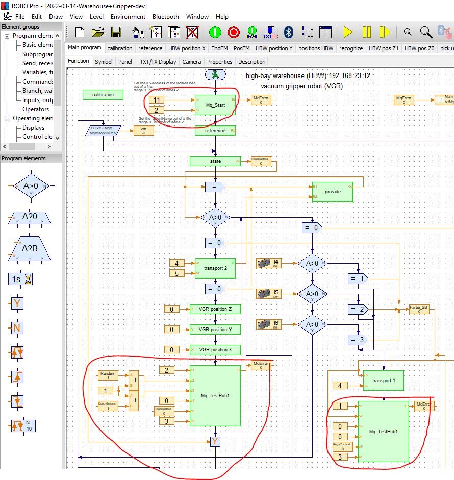

As we have already shown, MQTT with RoboPro extension elements can be used within RoboPro. At Saxion, university for applied science, we use that. We have added a local network to the factory 9V, without cloud or internet.
These RoboPro extension elements are developed in C++ and not in Python.
The RFID software is written in C++ and could in principle also be made accessible within RoboPro via RoboPro Extension elements.

Example of the integration of MQTT into RoboPro factory software.
This SLI elements take care of the publication of a MQTT message with a certain topic and a payload of 5 integers.
