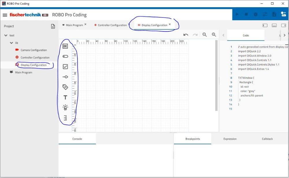

The "standard method" (display configurator in the ROBO Pro Coding app) to communicate with the TXT via its "internal display"
(by Blocky and/or Python language) is well described in the app documentation.
