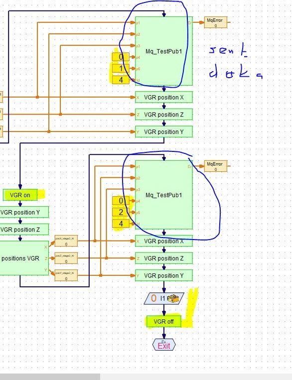

Examples of semi real time MQTT data:

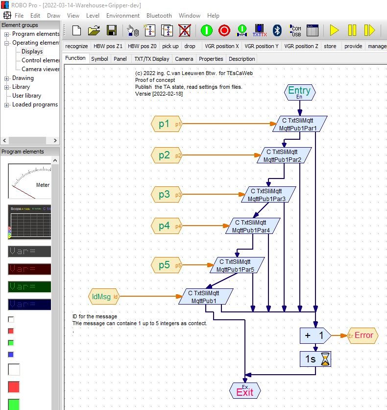

The Mq_testPub1 sub routine, the message has an ID and max 5 values:
The subroutine in use

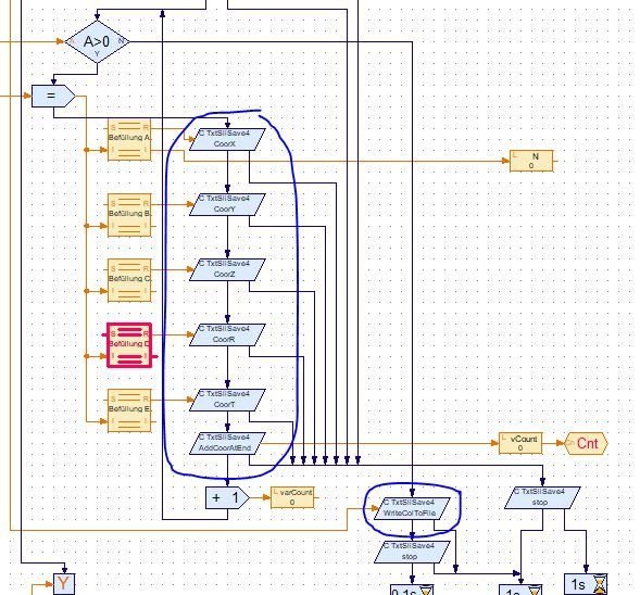

Example of saving to a file (code example on fischertechnik Github: txt_demo_ROBOPro_SLI/FtTxtExamples/SLI_TxtSliSave4C ):
