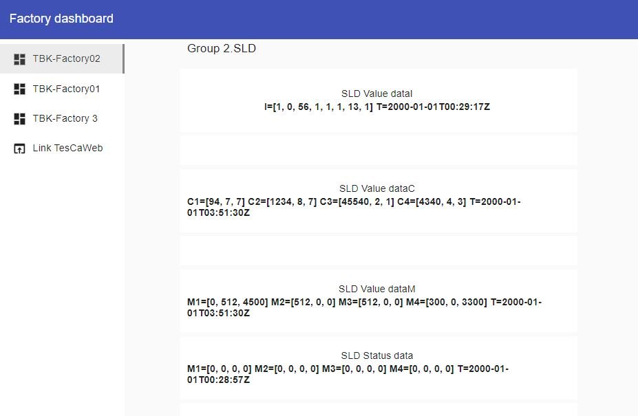

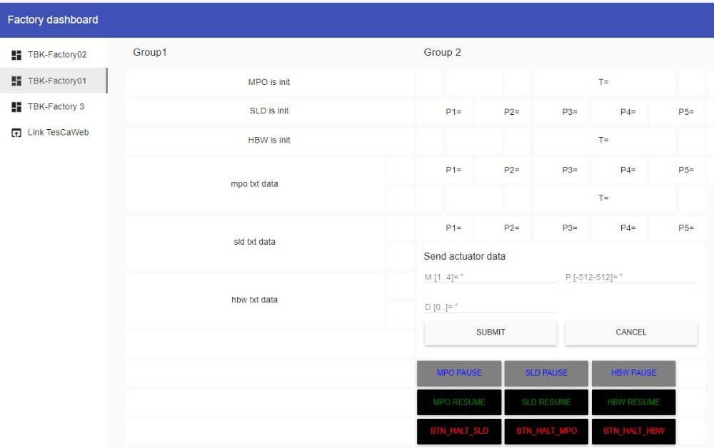

March 19, 2022 in Enschede, Saxion University of Applied Sciences section: TBK and I will present our first steps in the development of upgrading the factory software during this FT convention:
RoboPro MQTT communication using SLI elements with the outside world.
The objective of this project is to track the product as it makes its way through the production line and into storage.
Adding units for the supply of semi-finished products and the distribution of finished products.

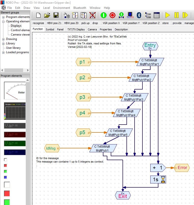

@Rei,
I already show 3 years ago at a FT-convention, it is easy possible to work with more inputs or outputs.
When you combine several small SLI's and use the lock.
In the example, there a 5 data inputs and a message ID.
It is even possible to program a kind of a branch, as also show in this example.
A bigger challenge is to bring the incoming MQTT messages at the level of RoboPro (at workflow level); but this is working too.
