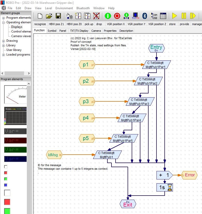

The SLI is interesting, although SLI functions only accept one parameter and return one value.
For that reason, I have developed smartNode, an external solution connected to the TXT through I²C.

I already show 3 years ago at a FT-convention, it is easy possible to work with more inputs or outputs.
When you combine several small SLI's and use the lock.
In the example, there a 5 data inputs and a message ID.
It is even possible to program a kind of a branch, as also show in this example.
A bigger challenge is to bring the incoming MQTT messages at the level of RoboPro (at workflow level); but this is working too.

There is no source code available.
We (Saxion-TBK Enschede and I) are still developing but the POC have show that the idea of integrating MQTT in RoboPro with SLI's is possible and working. We have presented the first prototype during the FT-convention in Enschede.

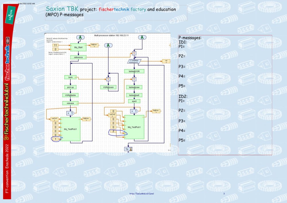

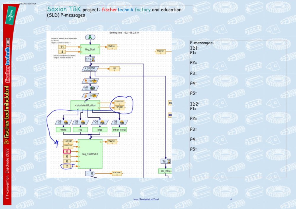

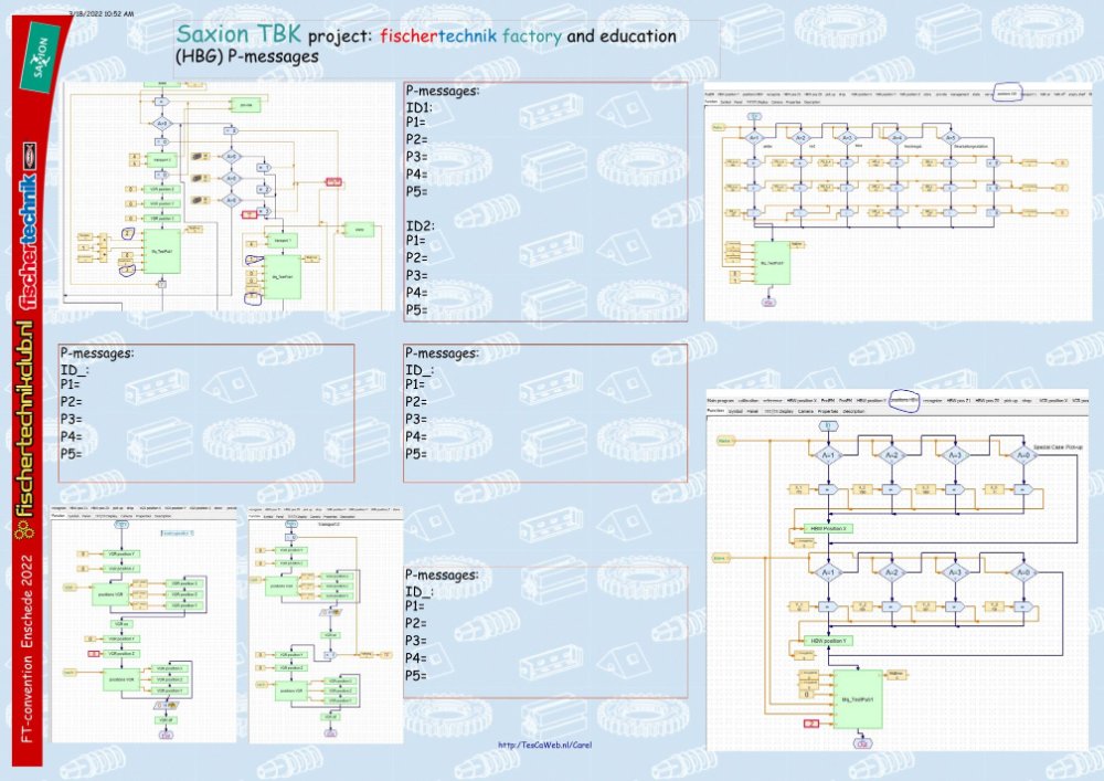

Our last 3 posters used during the FT-convention in Enschede:
FT-Enschede_2022(posters 3)__comp.JPG (168.37 KiB) 3677 mal betrachtet
FT-Enschede_2022(posters 4)__comp.JPG (172.62 KiB) 3677 mal betrachtet
FT-Enschede_2022(posters 5)__comp.JPG (192.51 KiB) 3677 mal betrachtet
