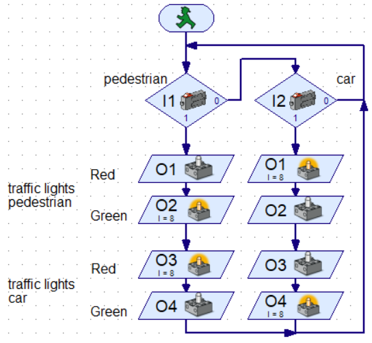

Hello,
I am building simple traffic light program with arduino, microbit, raspberry and fischertechnik.
I have build and programmed all but have problem with programing fischertechnik in robo pro.
In program it should be traffic light change process and when the button is pressed it should change to pedestrian crossing. And i have mannaged to program this simple thing but there is speed trap and when the car is speeding it needs to stop process imidietly and change to red light. So i dont know how to stop process when the input is for speeding. Can it be solved with multiple processes or maybe with timers instead of wait in traffic light change process? And how to do that? Thank you.
Re: Help for beginer in robo pro
Verfasst: 15 Feb 2022, 07:50
von elektrofuzzis
Hi Orangebox,
both options are possible, but I think using threats is a little bit more difficult.
I think you need something like that:
Best,
Stefan
Verfasst: 15 Feb 2022, 08:37
von Orangebox
Thank you for fast answer. The problem is that red light needs to be on 5s then yellow 1sec and green 5sec and yellow again 1sec then red and this need to be in loop for cars going in other way is easy since when is red for one way there is green on the other. When you hit switch it should start pedestrian light sequence. Then when car is speedin the program should stop and run red light for that car. The problem is that i dont know how to make it immidietly i mannaged to make speed trap but it only starts when sequence is over.
Verfasst: 15 Feb 2022, 13:05
von elektrofuzzis
Hi,
you could use two threads doing the job and synchronize both threats using a global variable used as a semaphore. Works perfect, but there is a risk on headaches reading the flowchart.
Second option is a little more the arduino loop idea. My flowchart this morning is based on that idea. But you problem is the timing of the lights.
If you use classic robopro timers, you aren't able to do anything until the delay has finished. At this point you are back with the two synchronized jobs (see above).
As a second option, there is a timer variable in robopro. It could run a countdown without blocking you code. You could read that timer whenever you want and descide on the results. So you're able to "loop on" while you are waiting on your counter.
Both solutions are fine. The first one is more thinking in threads, but less code. The second one needs more code but it's easier to write down.
Depends on you, how to continue. In both cases you could get some help on how to code the beast.
Best
Stefan
