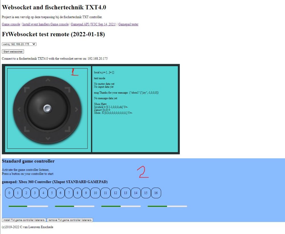

Example of a virtual joystick and generic game controller interface communicating with the TXT4.0 via a web socket.
Both can be used to control the fischertechnik model.
In this case, a wireless XBOX game controller is attached to the laptop.
I have published the web socket software on this forum before.
1) The virtual x-y joystick
2) The status of the connected game controller (0 to 4). This information can also be sent to TXT4.0
