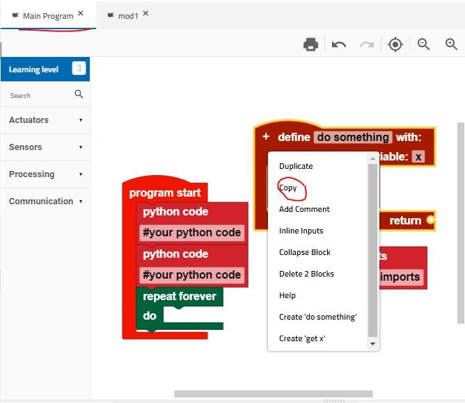

Only inside a project.
Copy past between .py files in a project, select object, right mouse klick:

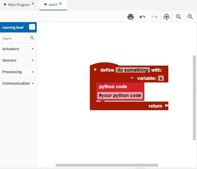

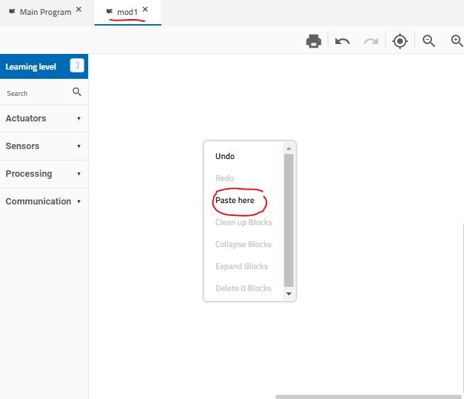

change .py module, right mouse click:
