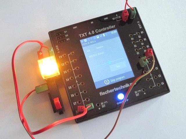

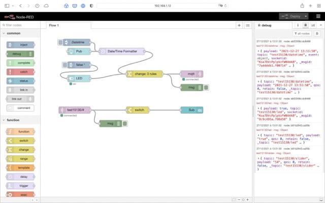

Answering the call from Bjoern, here are what I have discovered so far.
Built-in MQTT broker and Node-RED server
with 192.168.7.2 being adapted to the specific address.

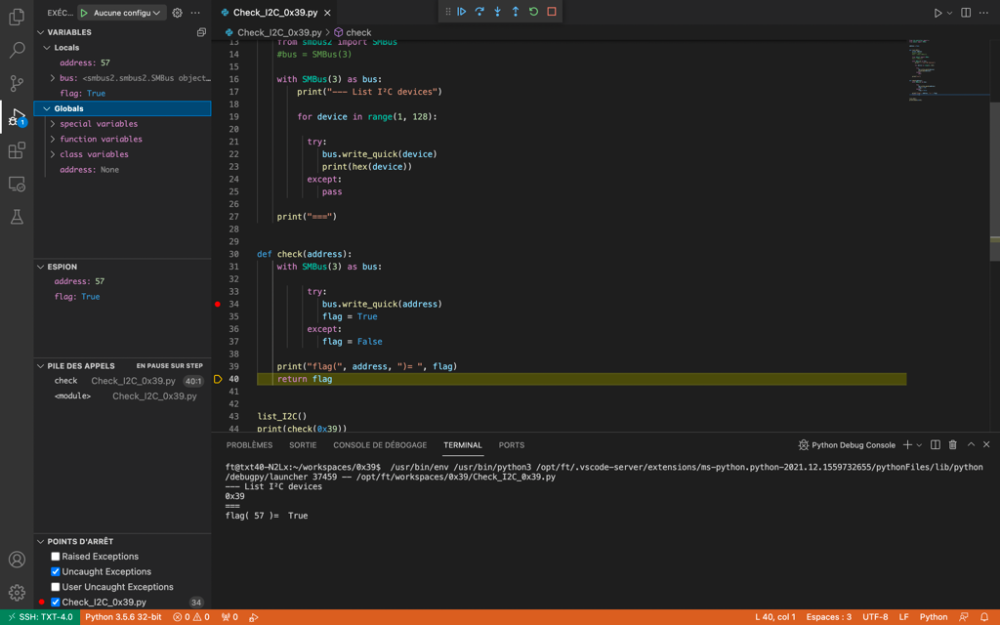

Remote development with Visual Studio Code
The excellent Visual Studio Code offers Python remote development against the TXT 4.0.
  • ssh ft@192.168.7.2
Connection is done with the ft:ft profile, while the owner for the projects and files generated by Robo Pro Coding is ftgui:ftgui. As a consequence, the projects and files generated by Robo Pro Coding can't be modified.
However, new projects can be created, debugged and run.

Thanks for the suggestion to use MS-Visual coding to develop Python programs on the TXT4.0.
I was already using it for the Raspberry Py.
I did not realised myself that after connecting VSC with it LINUX device, It is able to discover the local installed compilers.
The syntax highlighting and the library help is helpful.
The run support is fine.
The code can later cut and past into the RoboPro coding blocklies.

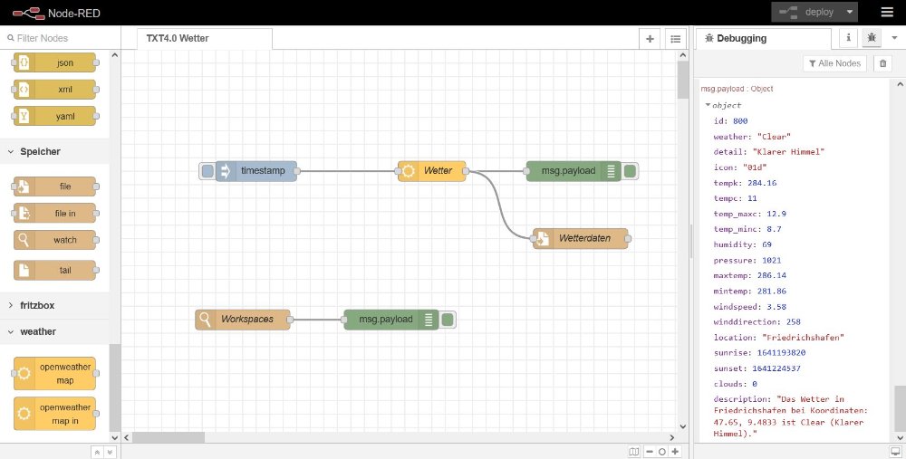

nice thinks like weather app with TXT4.0 is easily feasible, see
Wetter app
Wetter app
Wetter app.jpg (81.85 KiB) 22148 mal betrachtet
The Weather data can be stored in a file on the TXT.
TXT4.0 recognise the SD-Card. How can the data be stored?
It might be on "/opt/ft/workspaces/ext_sd/mmcblk1" however it doesn`t work...
Next step would be to join the data with RoboPro....

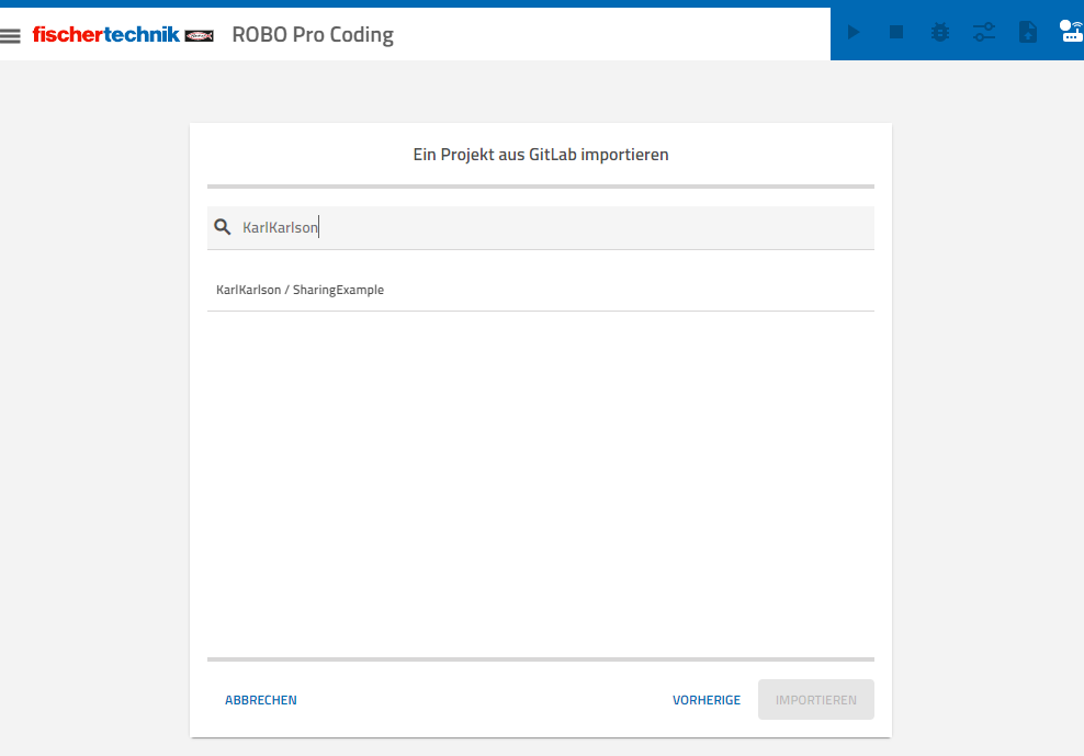

Since it is not possible to upload a RPC-Project here and you want to share the project, you could use the fischertechnik gitlab. Just upload your project there and set its visibility to public. Afterwards the project can be imported in RPC through its import function. Just search for a combination of your username/projectname (e.g. KarlKarlson/SharingExample).
If you have trouble setting things up, feel free to ask.
Best Regards
KarlKarlson
Rei Vilo
Beiträge: 95
Registriert: 19 Dez 2015, 15:39
Re: Exploring TXT 4.0
Beitrag von Rei Vilo » 04 Jan 2022, 15:15
Thanks for the tip, the project is available now.
