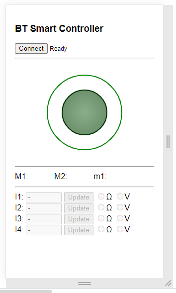

In fact I've already adapted your JavaScript script to use a joystick-like UI. The UI is here and the code is here:
Thanks for now,
Rubem
