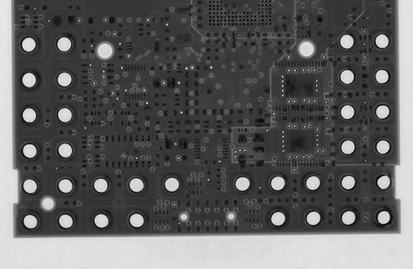

Update May 22 2022: X-ray images of PCB available

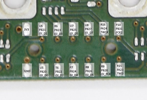

Update May 24 2022: The camera connector pinout reconstructed from pcb x-ray images. OV2640 camera is no go. Looking for another one with ITU-R BT.656-4 SAV and EAV synchronization support.

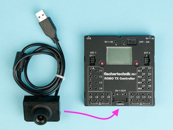

Die Kamera funktioniert nur am TX Nachfolger, dem TXT Controller.
Für den TX gab es nie eine Kamera.
Da die ft Kamera eine USB Webcam ist, kann man nicht am TX Controller anschließen und nutzen.
Okay. I understand that I can't get image from USB camera in the TX - there is no USB Host interface routed from the CPU :). At the same time TX has the CAMERA connector. May be it is a kind of standard type of camera connector?
Also it looks like CAMERA interface connector was wired to the CPU's Image Sensor Interface (ISI) on the PCB:
Do you have any ideas - why FT not finished this function? Was it hardware, software or other kind of problem?

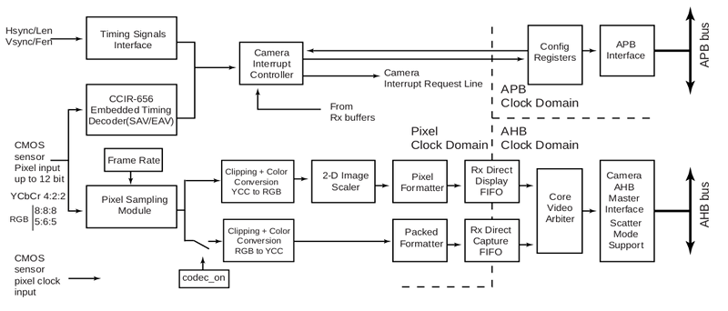

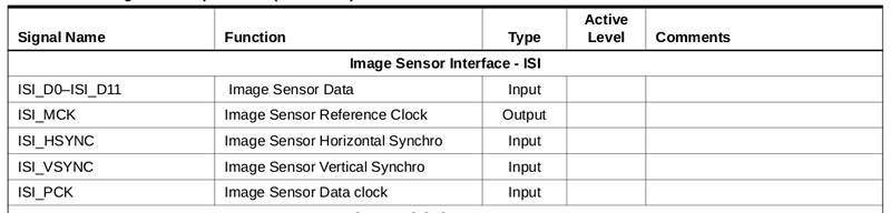

According to the datasheet for AT91SAM9260 CPU it has the Image Sensor Interface (ISI) that supports direct connection to the 8-bit parallel bus sensors and up to 12-bit grayscale sensors. It has FIFO buffer for pixel data and DMA interface - so we can offload frame data transfer job from the CPU.
Internal block diagram for ISI:
ISI signals list:

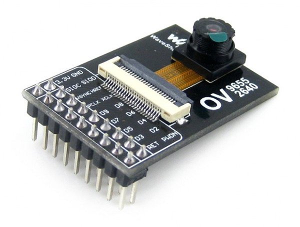

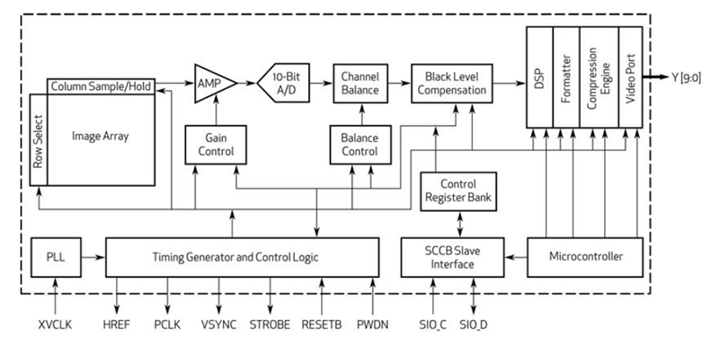

Also I found the cheap camera compatible with AT91SAM9260 8-bit interface. It is OV2640:
OV2640 block diagram:
Now the question - Is there copper traces wired from CPU ISI to CAMERA connector in the right way? May be someone could donate dead ROBO-TX that I can use for PCB reverse-engineering? I will blow off all parts from the PCB and track down traces from CAMERA connector to the CPU.

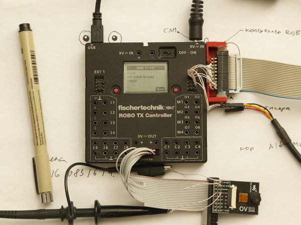

I have tested some software samples from at91sam9260-ek board on the ROBO-TX and they works fine. Just need to tune LD script according ROBO-TX memory map.
At this point I can control onboard red LED, buttons, I2C(TWI) bus, USB device interface and DBGU serial port.
ROBO-TX under test:

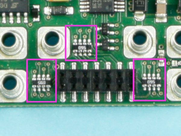

Thanking a lot to noname donator and an underground dental service we have a whole bunch of x-ray images of PCB. It's time to trace wires between CPU and CAMERA connector:
ft-ninja
Benutzeravatar
ft-ninja
Beiträge: 118
Registriert: 01 Nov 2010, 14:26
Wohnort: Inner Mongolia
Kontaktdaten:
Re: ROBO TX Camera connection - How?
Beitrag von ft-ninja » 24 Mai 2022, 12:49
Here we go:
It results in two news:

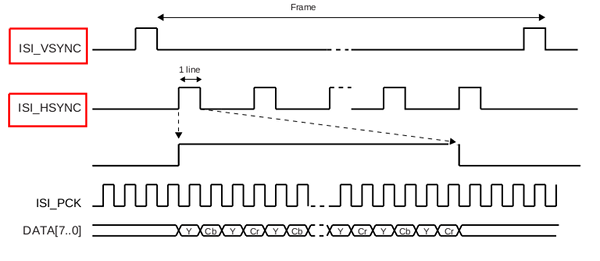

Bad one - there is no ISI_HSYNC and ISI_VSYNC signals available on the connector. These signals used by ISI controller to gate data capture from the data bus:
Good one - there is another mode for synchronization in the ISI controller - ITU-R BT.656-4 SAV and EAV synchronization. This mode uses two timing reference data patterns on the data bus, one at the beginning of each video data block SAV (0xFF000080) and one at the end of each video data block EAV(0xFF00009D):
Only data sent between EAV and SAV is captured. This reduced pin count alternative for synchronization can be used in case it is supported by sensors that embed SAV (start of active video) and EAV (end of active video) delimiters in the data stream. In our case OV2640 camera do not support ITU-R BT.656-4 SAV and EAV synchronization :(
It is good time to find another sensor with ITU-R BT.656-4 support. Any suggestions appreciated.
