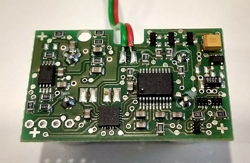

@vleeuwen, I understand that the sensor cannot be connected directly, thank you for the confirmation. However I see the circuit board has four unused pins (bottom left) which may be useful for hacking. There are also four interesting pads right above the bottom IC. Maybe the pins are compatible with an HC-SR04, I don't know. I would not be afraid to check out these pins if only I was sure where the 9V goes. The board has three "+" marks, which don't tell me much... See below:

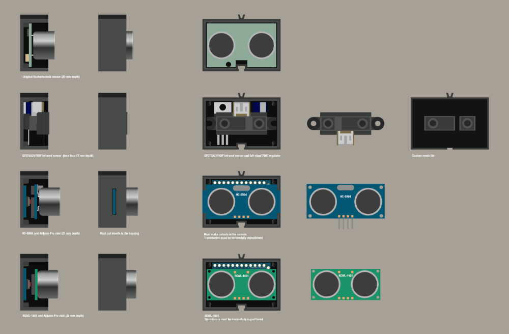

Unfortunately the guys at Knobloch did not answer yet, I'm not sure if they will. But in the meantime I found a sensor called RCWL-1601 (https://pmdway.com/products/rcwl-1601-u ... nce-sensor) that will easily fit into the housing, although the ultrasonic transducers will have to be repositioned horizontally a little bit.
The easily available and cheaper HC-SR04 will require cutouts in the housing, which is probably a bad idea.
There is also the GP2Y0A21YK0F infrared sensor. It has the advantage of being able to interface directly to the TXT because it has an analog output. Disadvantages are the more limited range (80 cm), less precision and non-linear output. And it will probably require a custom-made lid so it won't look like the original thing.
So here are my options: (The original sensor is shown at the top for reference.)

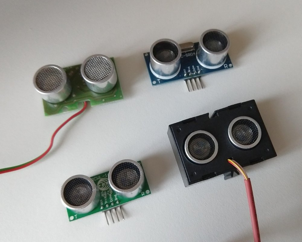

Today my new RWCL-1601 ultrasonic sensors arrived, and they fit perfectly inside the original ft housing with no modifications except for the removal of the 4-pin header connector. The sensor has exactly the same width as the original PCB (upper left). I soldered four thin flexible wires on it and brought them to the outside as you can see. An unmodified RWCL-1601 can be seen in the lower left.
There should be no problems interfacing it to the Arduino because this new sensor is a direct replacement for the (wider) HC-SR04 (upper right).

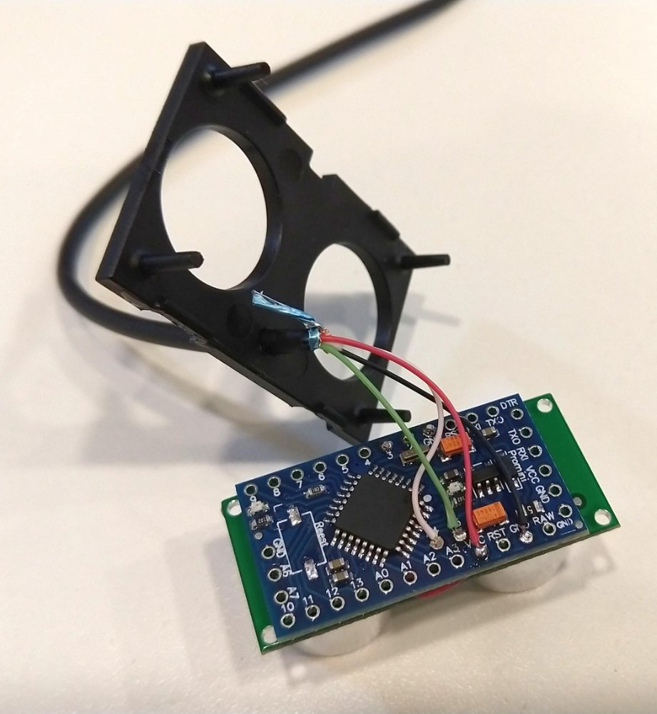

What I didn't mention yet is that I've installed and Arduino Pro MIni clone just behind the RWCL-1601. Thanks to some great pinout coincidences I was able to solder three of the four sensor pins directly to the Pro MIni. The whole assembly is sturdy and very thin (I removed the reset button) and it fits easily inside the ft housing. Here:
RWCL-1601 with Pro Mini.jpg (114.53 KiB) 17465 mal betrachtet
So far I'm using the Arduino to decode the signals from the sensor and send them to the outside world via I2C. I didn't test it with the TXT yet, but with the micro:bit it worked right away.
