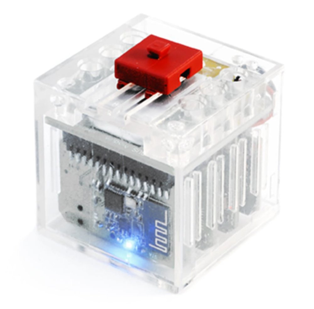

Hi everyone,
Yesterday I came across this:
https://databot.us.com/databot-meets-fischertechnik/
It's a cube with about a dozen sensors. The most interesting feature is that it already has two grooves specifically designed for fischertechnik pins! In the link above there are also a couple of ft models using t he sensor with explanations. I don't know much about this product; I'm just sharing it with you because I didn't see anything about it in this forum.
It's an intriguing product to say the least.

Many thanks Rubem,
This looks very interesting.
I didn't found many technical data or a datasheet of the item.
At least following:
  • 11 internal sensors,
  • 1 external temperature probe,
  • internal SD card memory,
  • Bluetooth low energy wireless
  • Programming via App in Python
  • I2C interface
  • Size: 42.5mm (1.67″) cube
  • Weight: 64 grams
  • Power: 3.3v Rechargeable LiPo
Source code https://github.com/arbotics-llc/databot_arduino
The Sensor are (Types assumed, from GIT Source code):
  • External Temperature Probe (maybe DS18S20)
  • Humidity (SHTC3)
  • UVa, UVb and UV Index (VEML6075)
  • Ambient Light (APDS9301)
  • CO2 & VOC (SGP30)
  • Air Pressure (MPL3115A2)
  • Altimeter
  • Accelerometer (MPU9250)
  • Gyroscope (MPU9250)
  • Magnetometer (MPU9250)
  • Sound
Price: $179.99
The idea for a higly integrated Sensors box is not new. The forum had this already in 2017:
viewtopic.php?f=6&t=4115&p=30145&hilit=weltraum#p29559
Anyway this databot Product provides clear advantages with its wireless solution, own power supply and SD-Card slot. So I may buy one when it is more mature. Acc to the presented available data sheet, I have the impression that this is not the case at the moment. May be someone have experience?
