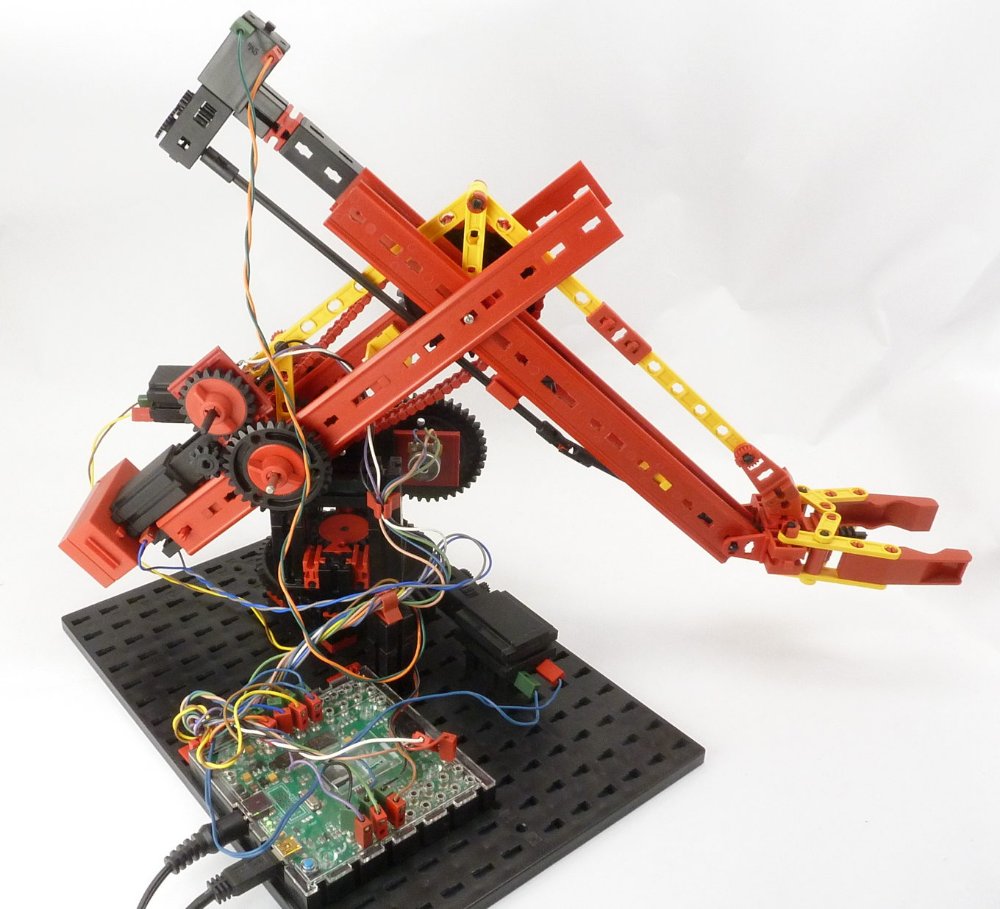

I have the book "fischertechnik-Roboter mit Arduino" and a ftDuino. I know the programs in the book are written for Arduino Uno, so I guess the programs have to be partly rewritten for ftDuino; especially the parts in which the inputs and outputs are used. Am I right or is there more involved?
Has anyone already made an effort to do this? Any help would be nice ;)

at least most of the programs in the book can be adapted to the ftDuino.
We are planning to provide the sketches for download on the book's website, but we haven't finished them so far.
We will report our progress here... and are hoping to publish the first skteches within the next weeks.
Stay tuned!

Die Sketche für den Greifer werde ich am Wochenende finalisieren.
