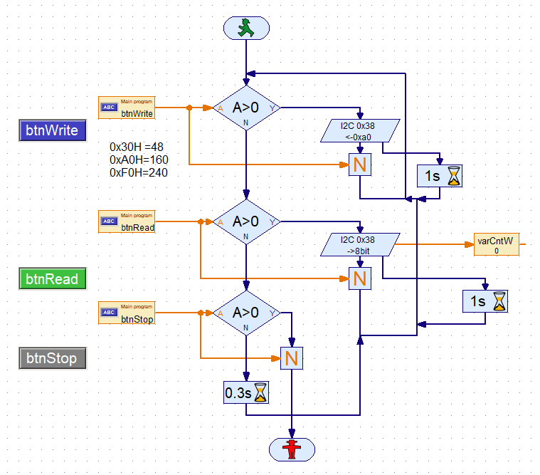

Today I was testing the RoboPro I2C elements with a simple test program:
RoboPro I2C test program
It was not working well.
Sometimes it was working but also it was generating errors.

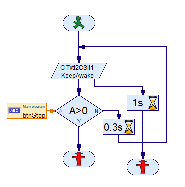

For the SLI I already publish a workaround, add a very simple KeepAwake function to the SLI,
call this function at least every 4.5 sec:
KeepAwake SLI
KeepAwake SLI

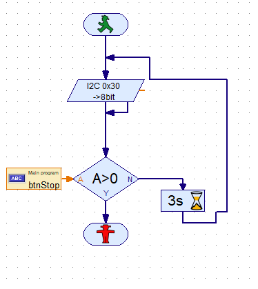

When you working with only RoboPro basic elements, then there exists also a workaround.
A I2C dummy read or write to a fake I2C address. In this case the element error output workflow needs be connected with the main workflow.
The dummy I2C element is producing an error all the time.
The I2C element error handleing property is set on "Abort immediately"
KeepAwake with I2C dummy element
