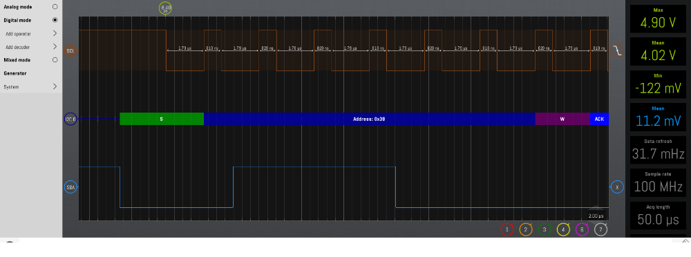

First error: The I2C 100Khz clock.
After a powerup and first use of the I2C device, the I2C CLK is always 100Khz. The setup setting 100Khz or 400Khz does not work and has no influence. As long as you keep using the I2C bus frequently, at least faster the I2C timeout, the clock will keep working at 100Khz. The error occurs in both on-line and off-line mode.
To be able to use I2C devices at 100 Khz, you need to start the program from a powerup of the TXT-Controller.

Picture at power-up on-line mode:
Hd picture Flickr: https://www.flickr.com/photos/fotoopa_hs/49952712277
Picture next run on-line mode = 400 Khz:
Hd picture on Flickr: https://www.flickr.com/photos/fotoopa_hs/49951922718
Summarized:
The first program starts after a powerup your I2C bus will always run at 100 Khz and will continue to run at this speed until you either stop a program or make a time-out of the I2C bus. The next start of your program will always run at 400 Khz (actually 384KHz) and cannot be changed without power down.
Time-out problems of the I2C bus in off-line mode do not occur. Only in on-line mode you have to take into account the timeout of 5 sec if you also want to use your I2C bus.

This offline prog run always @400Khz after the time-out even after a powerup.
Frans.

I always monitor both signals SCL and SDA during my tests on the scope. There are simply no signals coming out of the TXT in "online mode" after a time-out error. The levels just remain high. I don't think the problems have anything to do with the bus and/or load. All my tests are nicely repeatable. They're stable and predictable. That is why time-out in off-line mode also plays a role. After the time-out in "off-line mode", the TXT changes its I2C setting and goes to 400 Khz. The only difference with the on-line mode is that the Robopro PC connection is not recovered and remains in error until you restart the program. In off-line mode he apparently re-initiates the driver and just continues at 400Khz.
