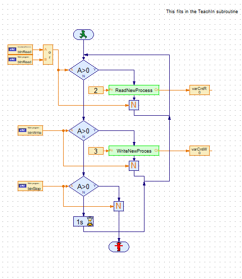

Yesterday I have finished my prototype for reading/writing contents of 5 RoboPro list elements to the TXT Data map.
Example about the use of a SLI for reading and writing to the TXT Data map.
I develop this SLI and RoboPro program for a TeachIn Robotor with a TXT as controller.
I also add a 5th RoboPro LIST element for a wait time after a position change.
The SLI write/read can use with more files.
The coordinates are stored as TXT which can also edit manually.
This works in both the on-line and off-line mode.
In fact the SLI can deal with 1 up to 5 RoboPro list element, a Dim-x cooridinate (vector) [x= 1..5]
I also develop a workaround for the RoboPro "on-line 5sec SLI" bug.
Impression:
Read from file 2.txt and write to file 3.txt
The main, this fits in into the teachIn software

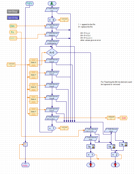

The write to the TXT Data map
Write the content of the List elements as coordinate to a collection as text (CSV, each line one coordinate)
Including some basic error handeling.

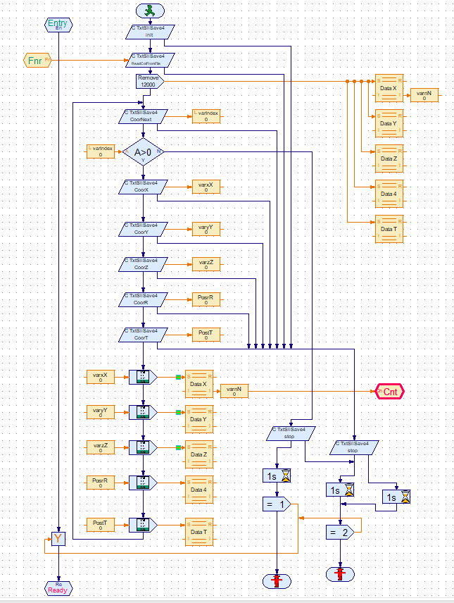

The read from the TXT Data map

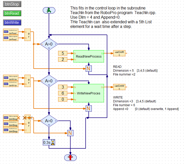

Version2 of the SLI:
selectable: dimension 3, 4 or 5 (4 is for the normale TeachIn software).
append to or overwrite the file
Skis empty lines in the input file.
The text file are stored in the TXT Data area.
Example of a file with coordinates (dimension =4)

RoboPro code that is using the SLI.
main
main

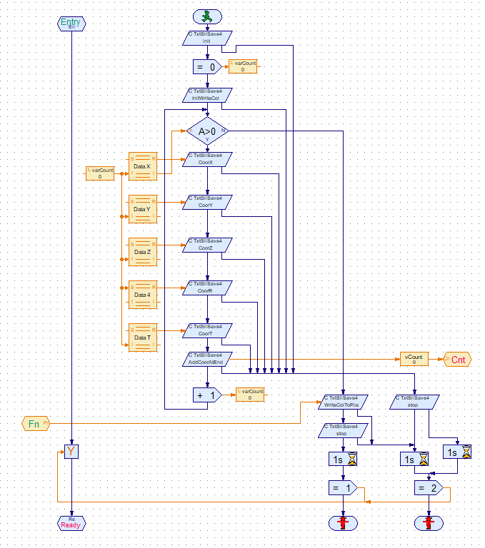

write
write

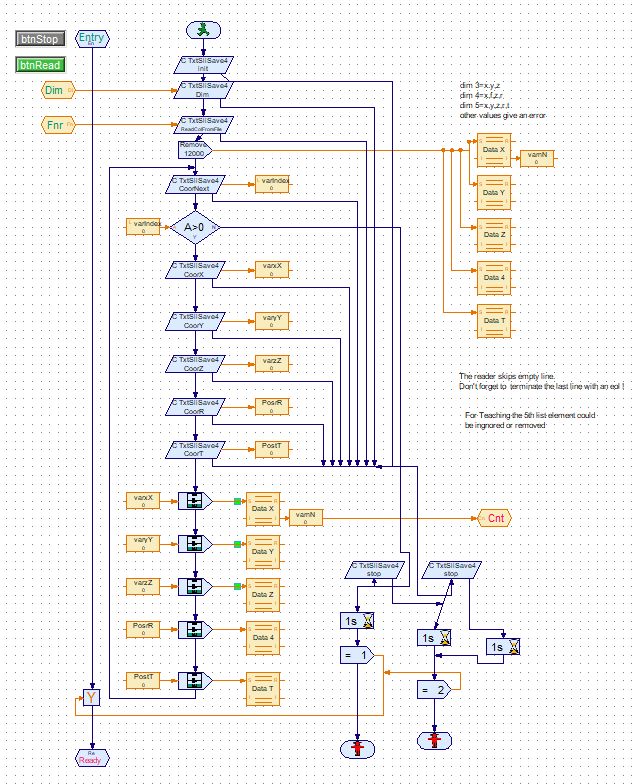

read
read
