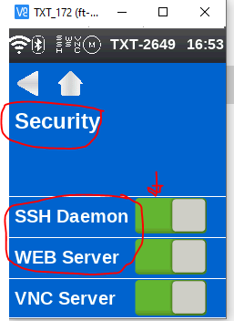

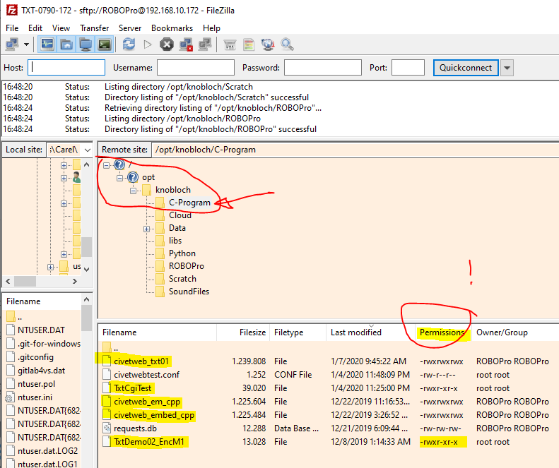

https://github.com/fischertechnik/txt_demo_c_download
https://github.com/fischertechnik/txt_t ... BServer.md
https://filezilla-project.org/
https://stackoverflow.com/questions/958 ... 00#6944100
Security on TXT
Security on TXT
Exe file for RoboPro => C-program
TXT Overview exe for RoboPro

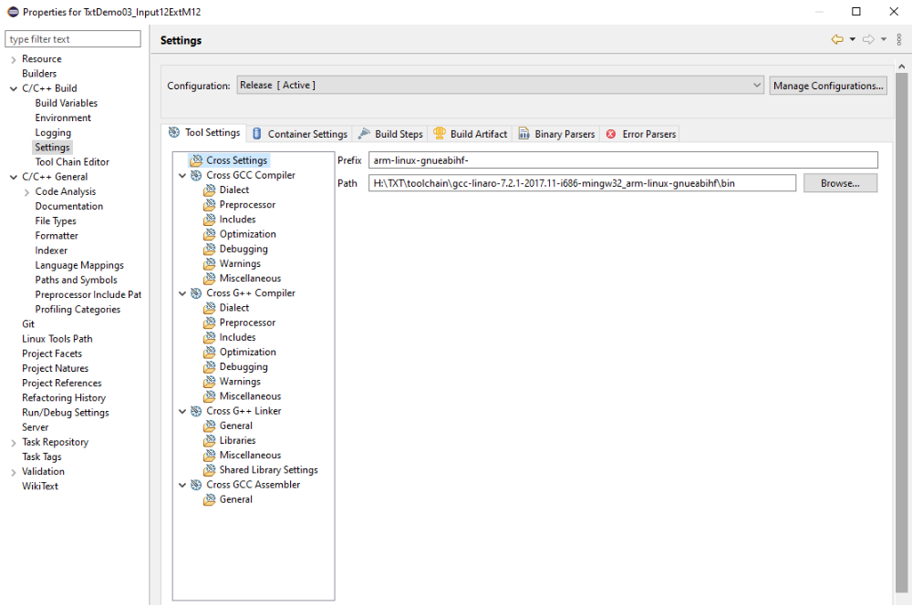

Aber in Eclipse Kommt immer diese fehlermeldung in der Konsole :Error: Program "arm-linux-gnueabihf-g++" not found in PATH
Was heisst das?
Der Rest ist Jetzt glaub wirklich richtig eingestellt.

Because almost all the information about Eclipse and how it works is in English, I don't translate this.
That is now just the reason that I give trainings.
Setting up a development environment is also understanding what you are doing.
Software enginering (computer programing) is just a lot more then type code with try and error approach.
Most of the information and documentation can be found on the internet.
So a important part (skill) of software engineering is also learn how to search and select the available information.
And transform this information into knowledge.
"stackoverflow" is a very good source for information.

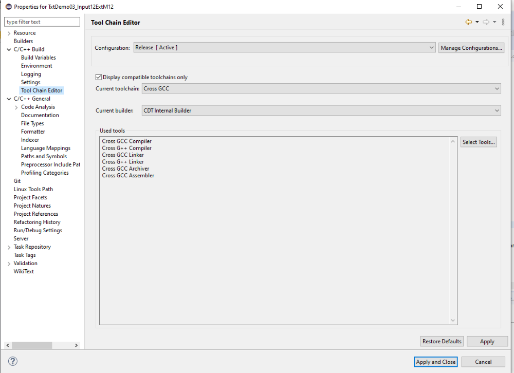

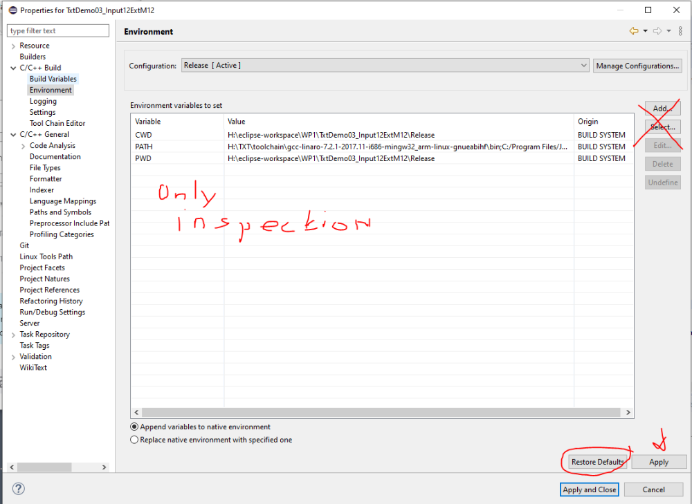

Check your Eclipse project properties and try to understand what they are meaning.
Inspection of the environment
Toolchain
Toolchain
Overview
Overview

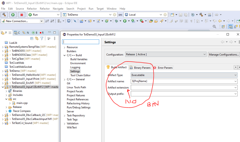

Ich hae immer noch einen fehler mit eclipse.

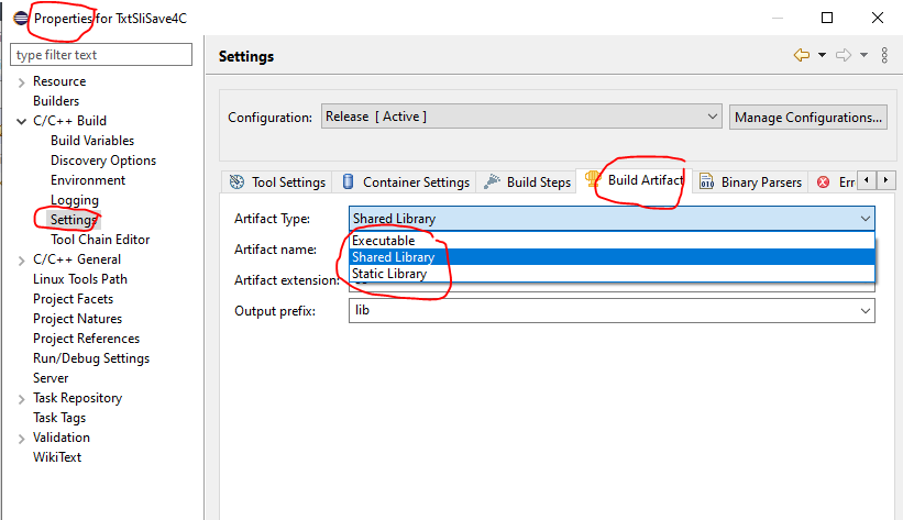

Mitlerweile habe ich den MinGW Compiler heruntergeladen. Dieser Compiled die .cpp dateien in eine .o datei. Diese kann der TXT aber nicht lesen.
Was muss ich umstellen damit es funktioniert?
Re: Datei auf TXT mit WinSCP
Verfasst: 05 Mai 2020, 16:34
von vleeuwen
Do you understand the basics of programming?
What is the difference between a static library, shared library and a executable?
https://stackoverflow.com/questions/264 ... -libraries
https://stackoverflow.com/questions/218 ... -is-o-file
https://unix.stackexchange.com/question ... -a-library
.o static library
-so shared library
no extension is an executable.
screenshot Eclipse project property
Most of the documentation is in English so adding a translation make no sense.

Aber das lib(name).dll file kann der TXT immer noch nicht lesen.
Verfasst: 05 Mai 2020, 21:02
von vleeuwen
The TXT is LINUX, for that reason Eclipse is cross compiling with Linaro.
You need for TXT (LINUX) an executable (no extension)
DLL => This is a MS-Windows library

Aber wie sage ich eclipse, dass er auf Linaro zugreifen soll?
Verfasst: 06 Mai 2020, 17:07
von vleeuwen
If you like to program for off-line (local) use on the TXT, please read first the documentation (readme) in https://github.com/fischertechnik/txt_demo_c_download.
It is good documented their.
Wenn Sie für die Offline-Verwendung (lokal) auf dem TXT programmieren möchten, lesen Sie bitte zuerst die Dokumentation (Readme) unter https://github.com/fischertechnik/txt_demo_c_download.
Es ist gut dokumentiert ihre.

Ich meine ich hätte alles gemacht aber er erkennt die Datei immer noch nicht!
Verfasst: 06 Mai 2020, 21:43
von vleeuwen
.so is a shared library which is also in use for the SLI.
But for a local program this is a executable.
On Windows this is identical, but with different extensions.
.bin (in the past) .exe for executable,
.dll for a dynamic library (it is covering different link protocols)
