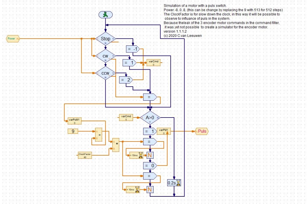

I was busy with creating a complete simulation of the Teachin software.
This because like to see what is happening without the mechanical problems of the real model.
RoboPro can run in simulation mode. However in that mode the combination of a motor and a puls- switch does not work anymore.
So I created a simulation for a motor-switch combination and now the software can run in simulation mode too.
Now my software can run and tested without the presents of a TXT-controller.
This also is an illustration and example about the use of command filters.
The duration of the puls can be controlled, with a slower puls it is easier to follow the workflow
The complete simulation
The simulation
The simulation

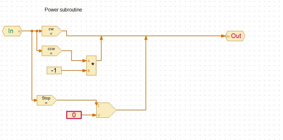

The motor react on the motor commands CW, CCW and stop. These commands has been transferred into values.
The stop has no value, so I add the 0.
The decomposition of the motor commands

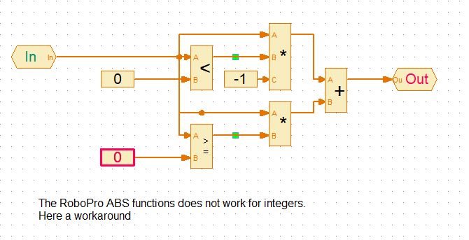

The RoboPRo ABS function does not work for integers so I create a work around for this problem/bug.
The workaround for the RoboPro ABS

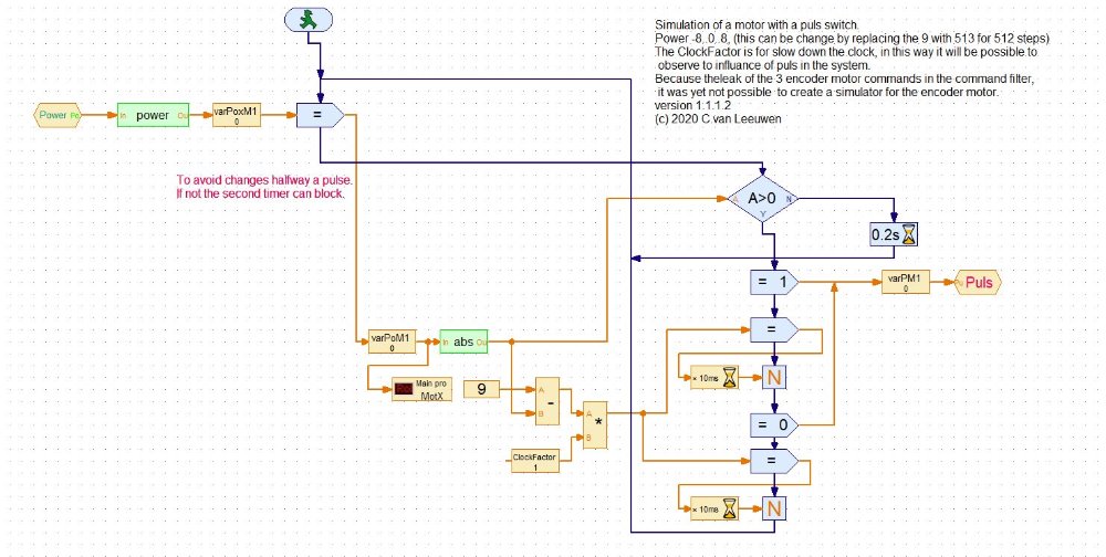

As an alternative for the motor simulation.
This example shows the use of the "8.2.4 Wait for command" RoboPro element.

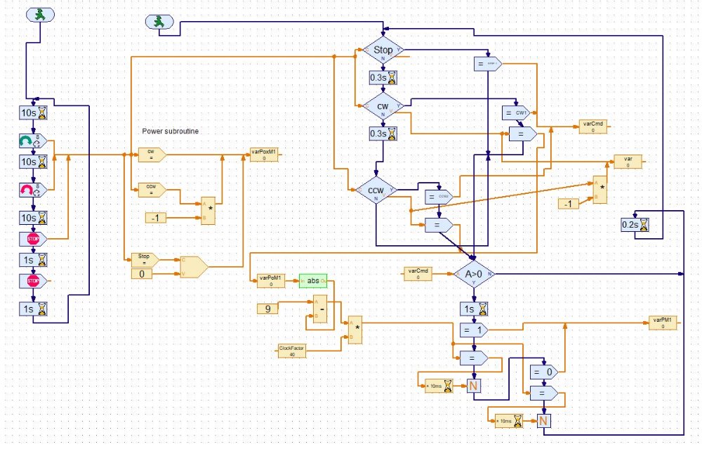

I imagine that novice RoboPro users are wondering "How can I develop a subroutine like the motor simulator myself?".
Or that a teacher wonders "How can I integrate this in my teaching?".
The RoboPro siumulation mode offers many possibilities for this.
Here is an example and some tips:
Work problem-driven and with a "Systematic Problem Approach"
It starts with an idea and writing down the associated objectives:
a) I need a subroutine with a data input that can handle the 3 motor command => CW, CCW and STOP.
b) The data output must be a clock pulse (0 1 0) with a frequency related to the power levels (1..8, -1 ..- 8)
No pulses with a stop command.
c) There is a need for an easy way to slow down the frequency. This allows me to observe the behavior of the system.
The first step is to analyze the 3 basic motor commands (CW,CCW, Stop):
What is a command and which RoboPro elements are available to deal with these commands?
What is the different between a value and a command?
The next step is to setup and to run some experiments to test the behavior of these commands in practice and also execute some experiment with it.
I myself have worked with the following small RoboPro program, my program to test my algorithmes.
This test program has been developed during my experiments. In the beginning it was rather small.
This simple RoboPro program runs in the simulation mode of RoboPRo, I don't need any hardware (TXT, motor, sensors).
Using this simulation mode also makes it much easier to use RoboPro in a classroom.
impression
impression
