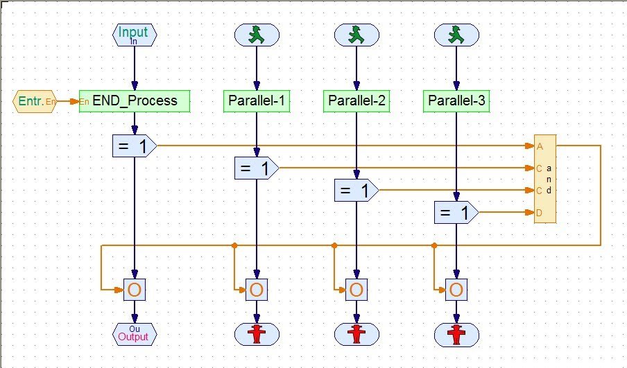

Re: Example of process synchronization
Verfasst: 05 Dez 2019, 10:31
von Rei Vilo
I discussed a similar solution on the
Parallel Processing page and used it on
Very Large Model: Defining the Processes.
- 7072523_orig.jpg (83.72 KiB) 4497 mal betrachtet
Verfasst: 05 Dez 2019, 15:53
von vleeuwen
Hi Rei,
Thanks for your contribution.
I guess that your "O" is the same as the "Y"?
You assume that during the initialisation of this subroutine a "0" has been send to all the "AND" inputs.
Has this been documented in the RoboPro help?
Otherwise local variables (start value 0 will resolve this) between the assignment elements and the AND element can help.
I would like have preference for a wait-element in the most left part, this to avoid a race condition.
The link to Michael's feedback is not valid anymore.
Kind regards,
CvL
