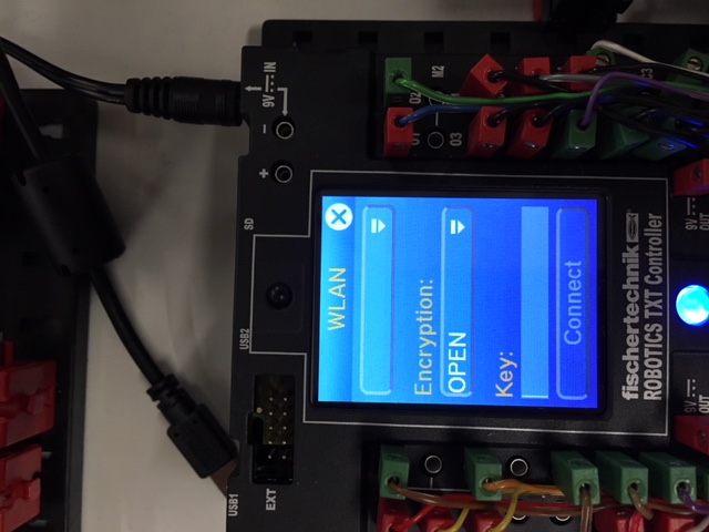

Can't Connect to WLAN
Every time I boot the FT Community Firmware I can not connect to wifi. When I press the wifi button and then press the button labeled "<unset>" there is no recognition of available wifi networks to join. My only options are to choose the security like open, wpa, wpa2 and enter the Key. Can anyone suggest anything to help me get my FT Community booted Txt Controller connected to wifi?

Re: Can't Connect to WLAN
Hello Giovanni, and welcome to the community!
First of all, I assume that the WLAN of your TXT works as expected under the regular firmware, right?
Then, which version of the community firmware do you use? You can find the release information in the "About"-App.
Does the WLAN symbol at the status bar at the top of your TXT indicate that WLAN is active?
Have you tried to exit and re-start the WLAN App?
And ... is your WLAN visible to new devices? Remember, even if you connected with the regular firmware before, the community firmware powered TXT is "unknown" to your WLAN, so you might have to allow connecting new devices at your WLAN access point...
Hi Peter,
Thank you for the welcome and response to my question. Yes the regular firmware of my txt has a working WLAN. I'm running community firmware 0.9.3. I have tried exiting and restarting the wifi app. When the community firmware is booted I do see the wifi icon at the top of the TXT screen but I do not see the wifi network available from other devices. I attached a picture of the controller for connecting to wifi. The top level dropdown, which I'm assuming displays connectable wifi networks, doesn't allow me to choose any options. Is this by design?
What happens when you open the WIFI configuration on your mobile phone or laptop? Do you see networks? If no, here is the problem.
What happens if you boot the stock firmware and open the access point scan? Do you see networks? If no, your TXT is broken or you are too far from the access point.
If it works under stock firmware but not with CFW we need to debug more.
Giovanni,gnicolamola hat geschrieben:The top level dropdown, which I'm assuming displays connectable wifi networks, doesn't allow me to choose any options. Is this by design?
Thanks,
Giovanni
Well, if there's a WIFI access point available, it should show up exactly there at the top level dropdown.
I would like to emphasize Raphael's first question:
If you scan for WIFI networks using another device like your mobile phone or a tablet, laptop etc., do you find your access point?
Maybe the problem is not with the TXT and the cfw, but your AP does not allow for new devices to connect, so you might have to check your AP's settings.
That's a known problem of the community firmware. The tool used in the background to scan for networks sometimes returns an empty list. Usually closing the WLAN app and opening it again makes some networks show up.
The CFW is in a pretty broken state since end of last year, so i wouldn't recommend to use it, anyway.
Thank you all for the wide response.
If I boot the Factory firmware I do see an access point and can connect to it which allows me to ssh into the box. If I boot the community firmware and then go to the FT standard GUI I can enable the access point but when I try to ssh into the TXT controller it doesnt allow me to connect.
Basically all I would like to do is utilize the community firmware for the python library. If anyone knows a way I can ssh into the TXT controller while using the community firmware I'd be grateful to understand how.
Do you have any special non ascii characters in your ssid?
You're welcome - that's what the community is for...gnicolamola hat geschrieben:Thank you all for the wide response.
If your TXT is connected to your network under cfw, you don't need to start the FT gui for ssh access. Actually there should be a pop-up when you try to access (username:password ftc:ftc) on the screen, to allow access.gnicolamola hat geschrieben: If I boot the Factory firmware I do see an access point and can connect to it which allows me to ssh into the box. If I boot the community firmware and then go to the FT standard GUI I can enable the access point but when I try to ssh into the TXT controller it doesnt allow me to connect.
If you already have installed the cfw to your TXT, I assume you also already know this: http://cfw.ftcommunity.de/ftcommunity-T ... ial-1.htmlgnicolamola hat geschrieben: Basically all I would like to do is utilize the community firmware for the python library. If anyone knows a way I can ssh into the TXT controller while using the community firmware I'd be grateful to understand how.
Additionally, you could use ftrobopy on your PC to remote-access your TXT, i.e. run python scripts on your PC.
However, this does not solve your initial issue regarding your WLAN access.
So, MasterOfGizmo's point is also very important. Your SSID name should only contain "A-Z, a-z, 0-9", same applies to your WPA key.
My TXT is not connected the network under cfw. And I don't have any non ascii characters in the SSID.
My main intentions here are really to connect the TXT to the WLAN so I can ssh into the community firmware. For some reason my connection is refused even when I try to ssh into the TXT through the usb port. At the first attempt I see the pop up menu to "Allow Connection" on the TXT screen which I Allow but with no luck in getting in.
At this point if anyone can help me either ssh into the community firmware I wont need the WLAN connection.
