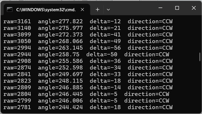

Läuft wie geschmiert:
Code: Alles auswählen
#include <cstdint>
#include <cstring>
#include <iostream>
#include <stdexcept>
#include <fcntl.h>
#include <unistd.h>
#include <sys/ioctl.h>
#include <linux/i2c.h>
#include <linux/i2c-dev.h>
constexpr uint8_t AS5600_ADDRESS = 0x36;
constexpr uint8_t RAW_ANGLE_REG = 0x0C;
int main()
    // Open the TXT 4.0 I2C bus
    int fd = open("/dev/i2c-3", O_RDWR);
    if (fd < 0) {
        perror("Cannot open /dev/i2c-3");
        return 1;
    try {
        uint16_t previous = 0;
        bool havePrevious = false;
        while (true) {
            uint8_t reg = RAW_ANGLE_REG;
            uint8_t data[2] = {0, 0};
            // Combined write + read transaction
            i2c_msg messages[2];
            messages[0].addr = AS5600_ADDRESS;
            messages[0].flags = 0;
            messages[0].len = 1;
            messages[0].buf = &reg;
            messages[1].addr = AS5600_ADDRESS;
            messages[1].flags = I2C_M_RD;
            messages[1].len = 2;
            messages[1].buf = data;
            i2c_rdwr_ioctl_data transaction;
            transaction.msgs = messages;
            transaction.nmsgs = 2;
            if (ioctl(fd, I2C_RDWR, &transaction) < 0) {
                perror("AS5600 I2C read failed");
                close(fd);
                return 1;
            uint16_t raw =
                (((uint16_t)data[0] << 8) | data[1]) & 0x0FFF;
            double angle = raw * 360.0 / 4096.0;
            if (havePrevious) {
                int delta = static_cast<int>(raw) -
                            static_cast<int>(previous);
                // Correct for 0° / 360° wrap-around
                if (delta > 2048)
                    delta -= 4096;
                else if (delta < -2048)
                    delta += 4096;
                const char* direction;
                if (delta > 0)
                    direction = "CW";
                else if (delta < 0)
                    direction = "CCW";
                else
                    direction = "STOP";
                std::cout
                    << "raw=" << raw
                    << "  angle=" << angle
                    << "  delta=" << delta
                    << "  direction=" << direction
                    << std::endl;
            previous = raw;
            havePrevious = true;
            usleep(10000);  // 10 ms = 100 samples/second
    catch (...) {
        close(fd);
        throw;
über SSH auf dem TXT4.0 gestartet
output from ssh
output from ssh
sollte Ok sein, denke ich.
Schönen Abend
Frank
