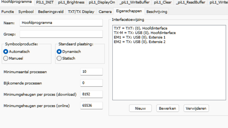

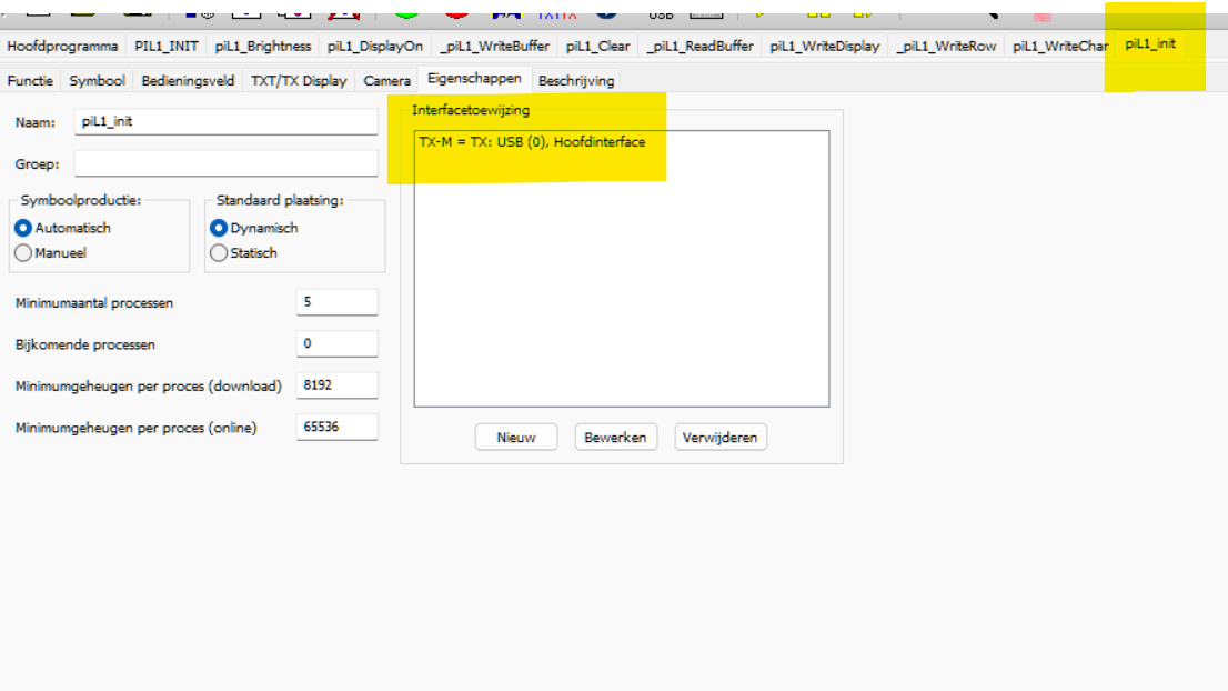

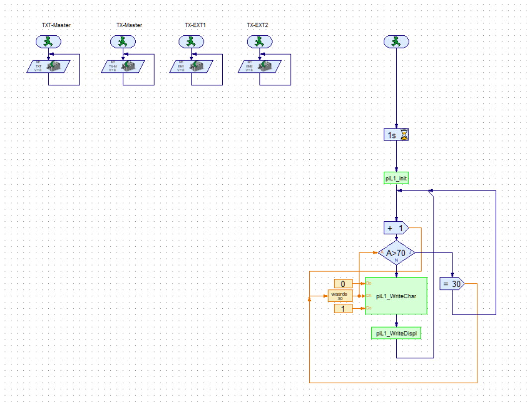

Hi, I have connected 3 TX controllers and 1 TXT controller via USB within RoboPro. I can run both the TX and the TXT commands in 1 program. But what I am unable to do, is gettting the i2c displays I have working. Both the TX and the TXT are set as the main controller and I suspect that something is going wrong there, but you have to set it this way otherwise you cannot operate them in 1 program (In Online mode).
Does anyone have an idea if it is possible to get the i2c displays working in this setting? If I only use the TX controllers, with the FT-extender, the displays work fine.
