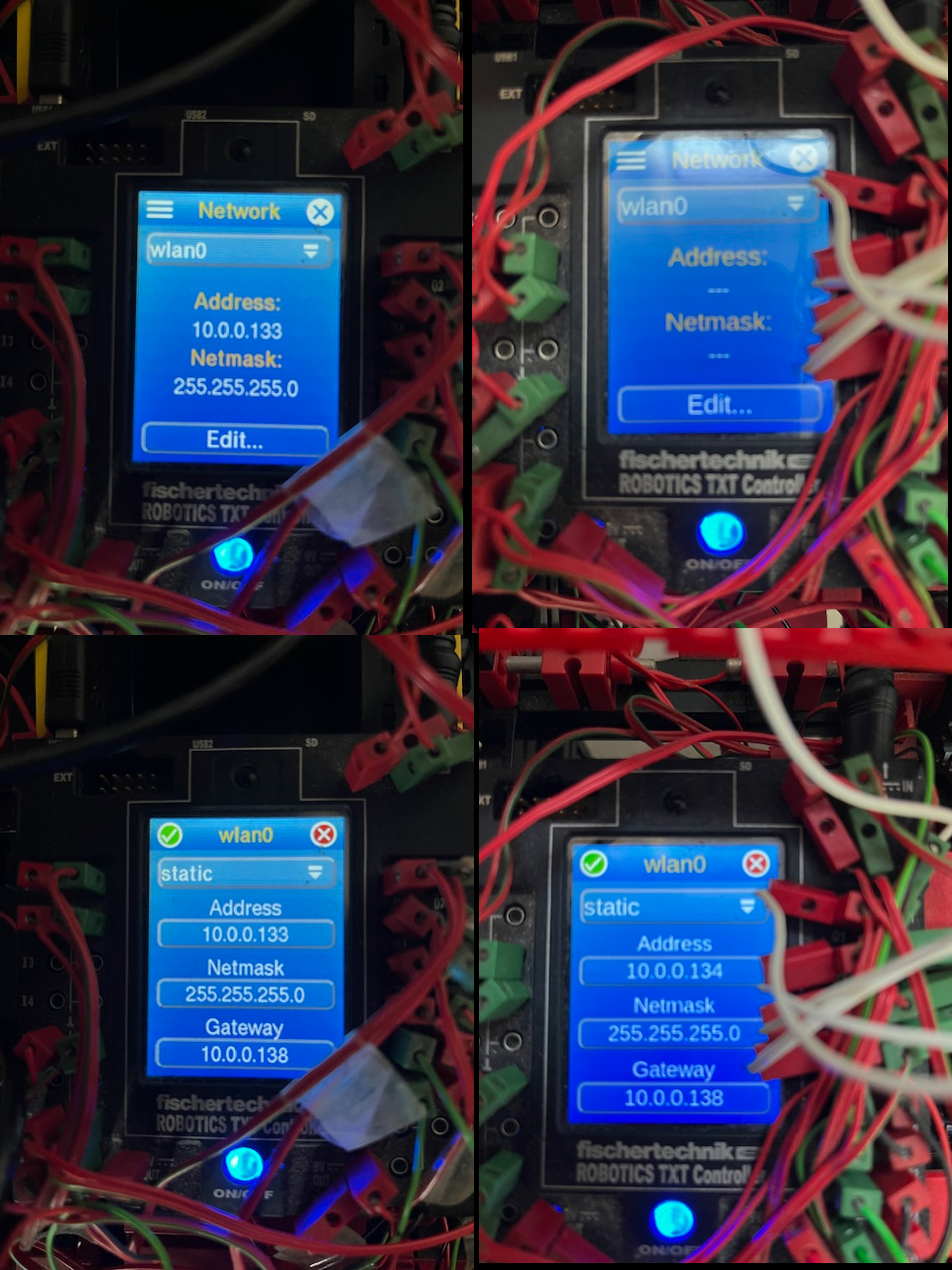

After quite a bit of time, I have made another attempt to regain connection. Which failed. Upon the suggestion, I did not create a new sd card but upgraded the cfw version. Without result. However, since I have 2 TXT's, one of which is working, I made imagess of the network settings of both. .
Both lower images are from the screen after pressing the Edit button.
You can see that at left, both IP addresses are shown: it's the correctly working TXT.
At right, the IP address is shown only at the bottom. That's the TXT that fails to connect.
Is there a reason that could explain the difference between the 2 network interfaces, other than that the TXT is broken?
