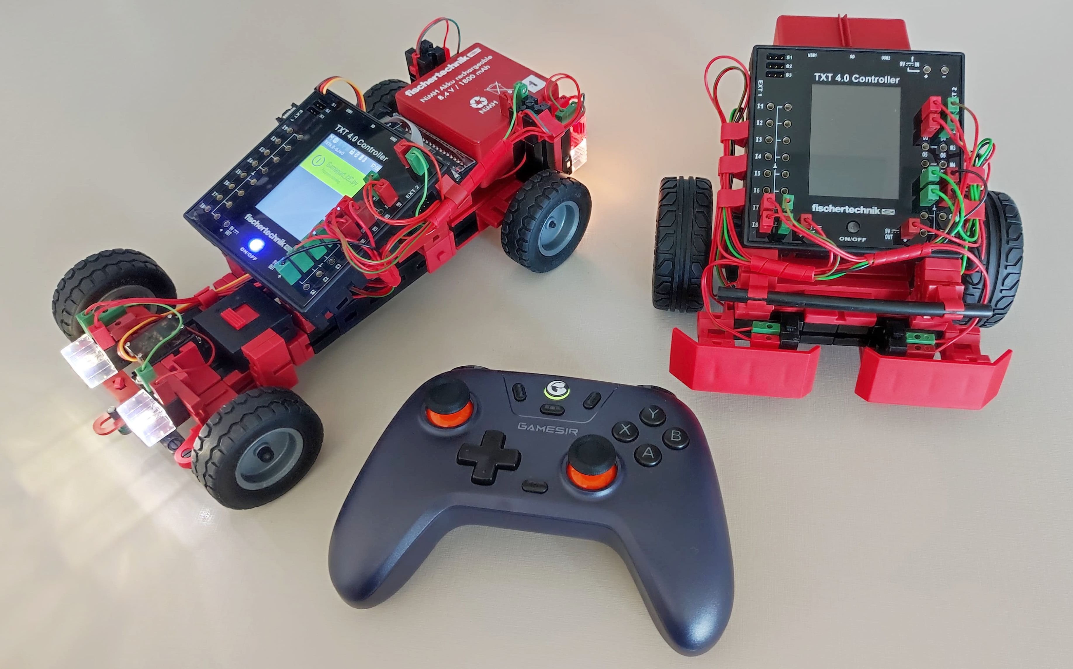

Hi everyone,
I've replaced the Sound + Lights Module with a buzzer which behaves just like a car horn. The result is a "slim" version of the racer. The robot at the right is basically the one from the Robotics TXT 4.0 Base Set with obstacle sensors. I want to use these to provide vibration feedback on the game controller. I didn't test the robot with the ESP32 receiver yet, I still need a new Robo Pro Coding program for that.
Racer and robot.jpg (678.79 KiB) 2690 mal betrachtet
Regards,
Rubem
