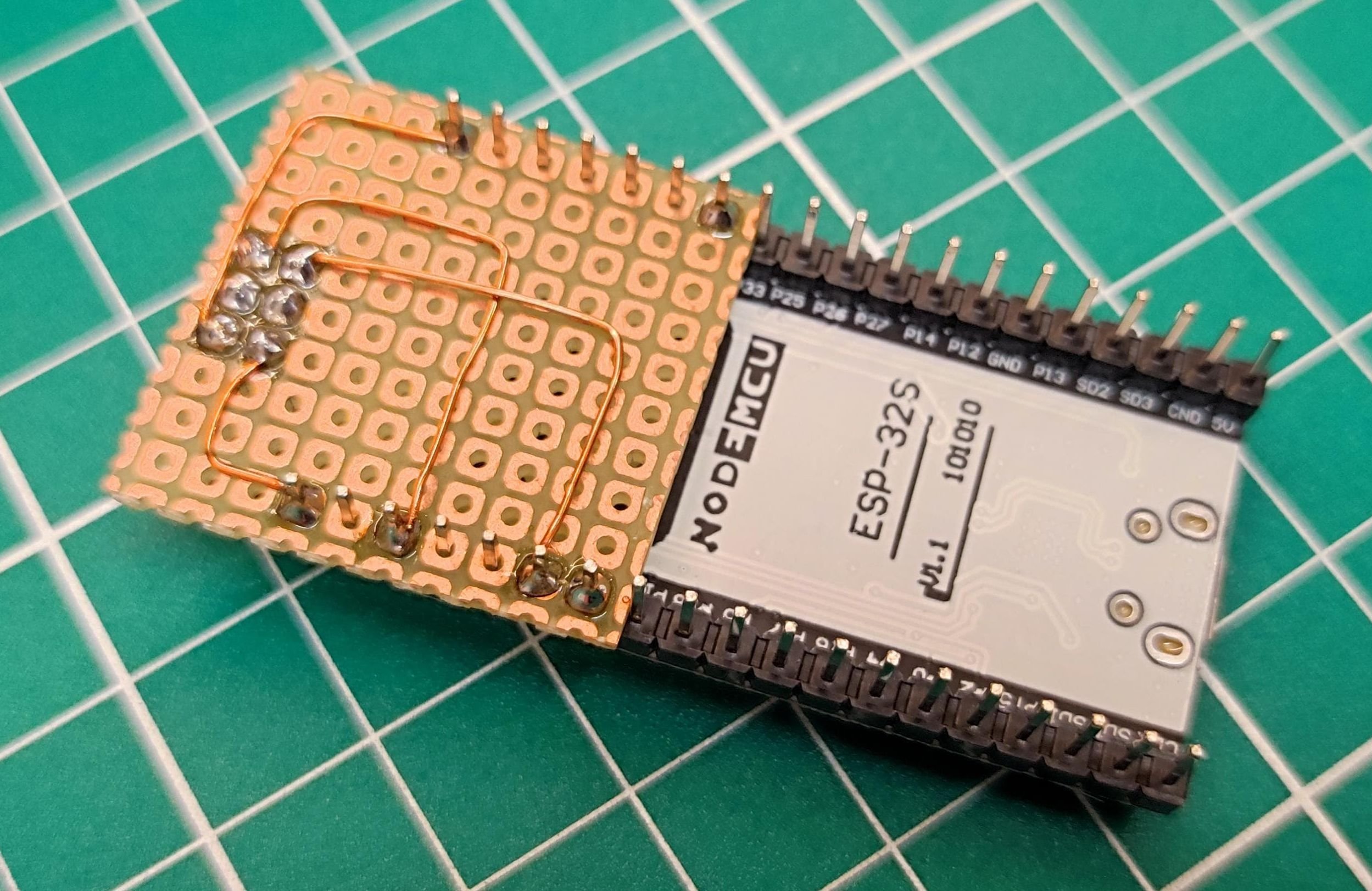

As a follow-up, and because it seems that the lack of a remote control solution is a hot topic now, I'd like to share the current test setup of my project:
Remote test setup.jpg (1003.01 KiB) 26031 mal betrachtet
After several weekends of trial and error, I was finally able to successfully forward the commands from a Bluetooth gamepad into a TXT 4.0 using a cheap ESP32 module via I²C. I'm still working on it, but the results are encouraging! I can already map any analog input (joysticks, throttle, brake) to the motor speed and the servo position, and use any button to command things like reverse, lamps, etc. Just what I wanted. My Python functions report occasional issues with values outside the allowed ranges and I/O errors, I'll probably be asking for some help soon.
Next step will be to build a case for the ESP32 and an IDC socket, then test the controller with a real model. I'll also be posting the circuit and code for those who wish to make a similar adapter.

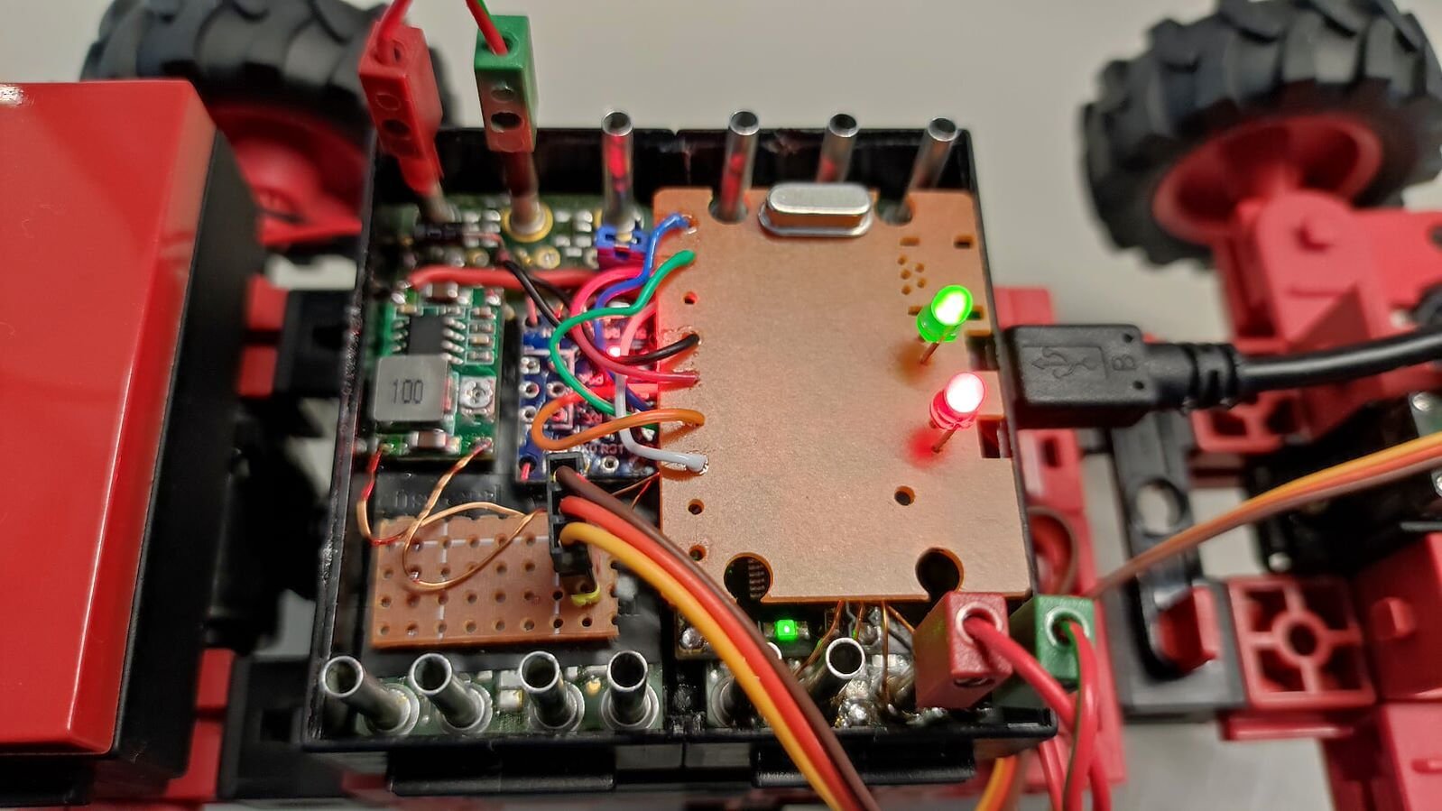

The remote control is now working. You can see that the ESP32 module and the I2C connector fit exactly inside a 30 mm wide ft case.

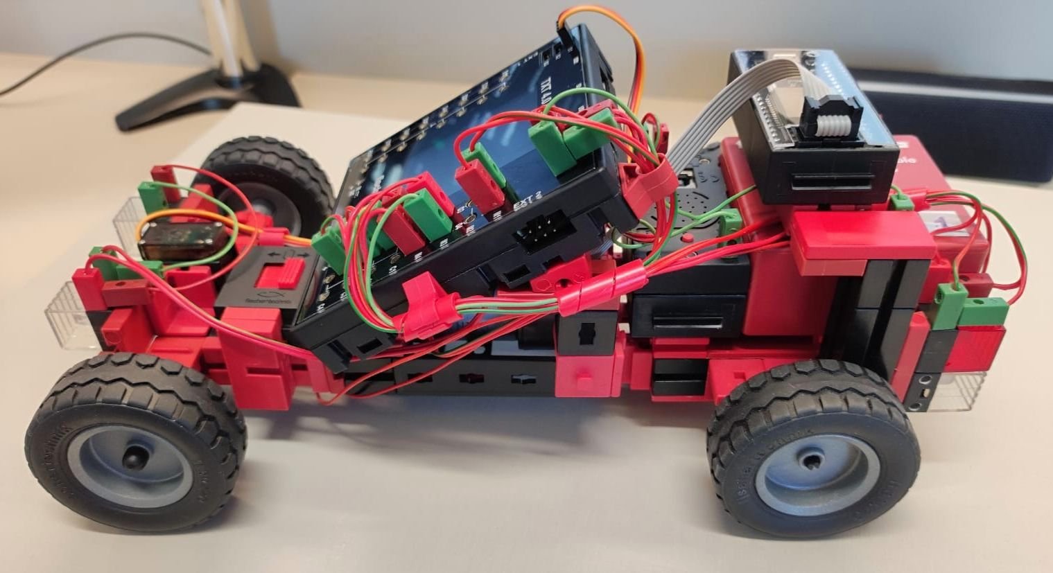

Test car.jpg (394.96 KiB) 25484 mal betrachtet
I built this simple test car with the following functions, all controlled remotely:
- RT (throttle): Motor speed
- LB: Headlights and taillights
- RB: Reverse with lights
- Left joystick: Servo steering
- A: Internal horn from the TXT4 (takes a long time to start -- I hope ft fixes this)
- B: External horn using a Sound + Lights Module (it's below the TXT4)
In the future I may create some sort of library in ROBO Pro Coding including slow deacceleration, braking, dead zone, gamepad vibration etc. For now I'm very happy with the results. The gamepad works better than I expected, especially the speed control which is very precise.

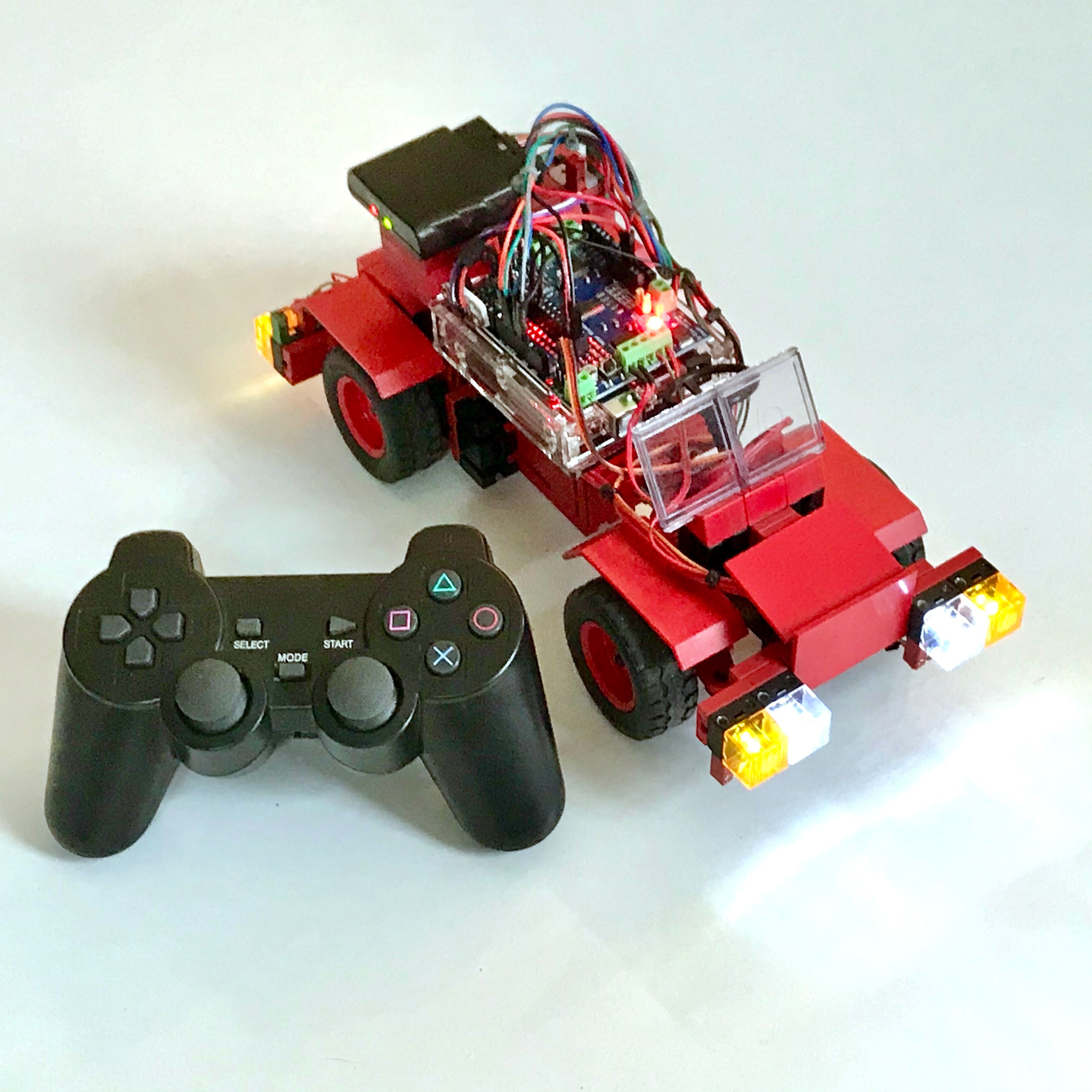

Ich habe keine Erfahrung mit dem Anschluss einer USB-Konsole an den TXT-Controller (ich besitze keine ft-Controller, nur original Silberlingen :lol: ) und wie dann die Fernsteuerung gestaltet ist (über BlueTooth an einen zweiten TXT-Controller?) und ob das für dieses Modell notwendig ist, kann ich nicht genau überblicken.
Aber ich habe selbst schon oft mit kabellosen Controllern für Modelle experimentiert. In ft:pedia 2020/4 kann man über meine Experimente mit dem kabellosen PS2-Gamepad lesen, und in ft:pedia 2021/1 über Lösungen via Bluetooth mit einer selbstgebauten Fernbedienung mit einem Arduino Joystick-Shield.
Inzwischen wurde ich von mehreren Leuten gefragt, ob es nicht möglich wäre, ein universelles Modul zu entwerfen, das die Nutzung der kabellosen PS2-Gamepads ohne separaten Arduino erleichtern würde, also z.B. eine Empfängerplatine mit (Motor-)Treiberausgängen, auf die das Empfängermodul aufgesteckt werden könnte und die von einer ft-Batterie gespeist werden könnte.
Daran habe ich auch schon gedacht und es sollte auf jeden Fall möglich sein. Ich bin immer noch neugierig, ob es Interesse daran gibt (und welches „Budget“ die Leute vernünftigerweise für eine solche komplett gebaute Lösung haben, schließlich wird es eine handgefertigte Sonderanfertigung sein) :roll:

Hi Arnoud,
In one of my posts above I already mentioned you, I was able to duplicate your project. It worked well and I even was able to fit the receiver's PCB inside a 60 x 60 enclosure with an Arduino Nano (see photo), but then I was a bit too optimistic... I cut part of the PCB because I wanted it to fit it inside a 30 x 60 housing. I believe the chip couldn't withstand the heat and burned. This happened twice... But I learned a lesson :D
Failed board.jpg (183.2 KiB) 23991 mal betrachtet

Hi everyone,
For those who are still following, here is the newest version of the car. The main difference is hardly visible below the TXT4. I've replaced the red encoder motor with a 8:1 power motor and now the car is a racer, it can run real fast. I still can set the speed quite precisely, but of course I must be much more careful when handling the throttle control at lower speeds. I also had to extend the overall length a little bit because of the power motor requirements, so the Sound + Lights Module is clearly visible now. I've also added a transparent cover to the custom ESP32 module.
rc racer.jpg (146.48 KiB) 21540 mal betrachtet
Best regards,
Rubem

rubem hat geschrieben:
01 Mär 2025, 17:01
I had not read it carefully yet indeed. In an earlier post you say that you had also blown one and that they “broke down quickly. So also you experience that they apparently get very hot?
I actually did not have this experience at all. That's why I was wondering: did you put the supply voltage of the receiver module at 3(.3) volts? Revisiting the old schematic, I would even think it would be technically more elegant to run the Data/CMD/Ack/CLK lines through a level shifter (5v<-->3v) if you are using a (5 volt) Arduino Uno.
The whole power supply and interfacing becomes easier if you use a 3.3 volt ESP-32 of course.... And so myself, with a supply voltage of 3.3 volts for the receiver, I have not experienced excessive heat generation.
