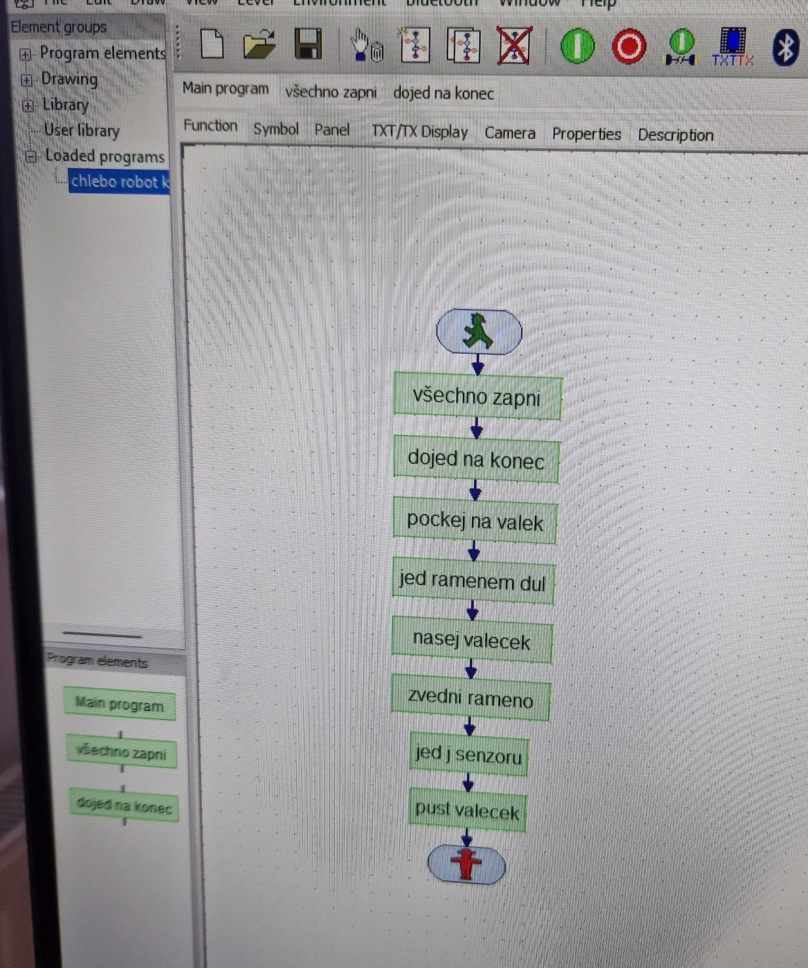

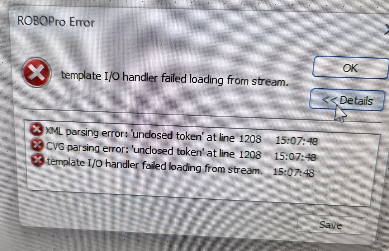

Hello, we are using Robopro in our school and we are facing this very irritating problem:
Our students work on their own programs, they save it on their local computer desktop or documents folder and when they come back next week, almost every time some of them get an error message and their program won't open correctly.
This only happens when working with subprograms.
Some of their subprograms are lost and so the main program doesn't work. They have to do everything again.
See screenshots.
What is the problem here?

It seems to be an xml error. If you attach the file as zip file, I can have a look what happens in that mentioned line.

So I checked the line 1208 in the rpp file, it's the last line but the program shouldn't end there. It didn't save properly.
Any ideas why this might have happened?
The students use the "save" icon, they wait and then they close the program.
Is there a flaw in the save function or on our computers?
Also I notices that it sometimes takes a VERY long time to save. I mean like 20 seconds. The program appears frozen during that time.

Hi. I compared with some of my rpp files, and I immediately found some files which are corrupted like yours.

Because I realized that my recent rpp files are corrupt, I found a quite easy way to reproduce the problem with RoboPro 4.7.0:
- create a new program
- add APDS9960_init and APDS9660_gest objects to it
- maybe wire them and
- save _on_a_nas_ mapped to a local drive (e.g. x:\robopro)
This will hang RoboPro and killing it will result in a corrupted rpp file. The solution is to wait several minutes until saving finished.
Even if the resulting file is not big, it might take very long to save.
In my case, the solution would be to work locally and copy the files to nas later. But I don't know if your students have a similar problem.
