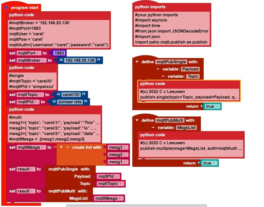

Hereby the basic (Blockly) example about publishing MQTT topic's to your broker.
In this example the MQTT broker runs on 192.168.20.136, change this into your MQTT Broker IP address.
Links:
Links into the MQTT documentation:
https://pypi.org/project/paho-mqtt/
https://pypi.org/project/paho-mqtt/#single
https://pypi.org/project/paho-mqtt/#multiple
Notes:
Python object can only assign to an in Blockly defined variable in a Python code Blockly.
The Blockly structure:
The Blockly code
The Blockly code

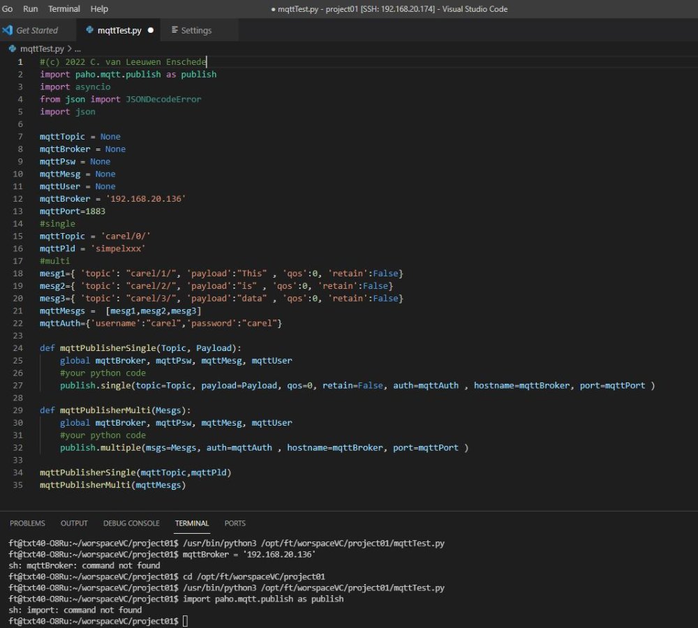

The code development in MS Visual Studio Code remotely on the TXT4.0:
The development of the Python code in MS-VSC
The Python code in the ROBO Pro Coding (RPC) Python pane:

The code from the MS-VS code:
Code: Alles auswählen
#(c) 2022 C. van Leeuwen Enschede
import paho.mqtt.publish as publish
import asyncio
from json import JSONDecodeError
import json
mqttTopic = None
mqttBroker = None
mqttPsw = None
mqttMesg = None
mqttUser = None
mqttBroker = '192.168.20.136'
mqttPort=1883
#single
mqttTopic = 'carel/0/'
mqttPld = 'simpelxxx'
#multi
mesg1={ 'topic': "carel/1/", 'payload':"This" , 'qos':0, 'retain':False}
mesg2={ 'topic': "carel/2/", 'payload':"is" , 'qos':0, 'retain':False}
mesg3={ 'topic': "carel/3/", 'payload':"data" , 'qos':0, 'retain':False}
mqttMesgs =  [mesg1,mesg2,mesg3]
mqttAuth={'username':"carel",'password':"carel"}
def mqttPublisherSingle(Topic, Payload):
    global mqttBroker, mqttPsw, mqttMesg, mqttUser
    #your python code
    publish.single(topic=Topic, payload=Payload, qos=0, retain=False, auth=mqttAuth , hostname=mqttBroker, port=mqttPort )
def mqttPublisherMulti(Mesgs):
    #your python code
    publish.multiple(msgs=Mesgs, auth=mqttAuth , hostname=mqttBroker, port=mqttPort )
mqttPublisherSingle(mqttTopic,mqttPld)
mqttPublisherMulti(mqttMesgs)
