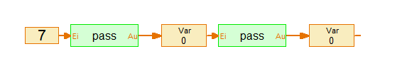

So kann die Fehlermeldung noch einfacher erzeugt werden:
Das ist natürlich nicht sinnvoll, sollte meines Erachtens aber von RoboPro trotzdem fehlerfrei bearbeitet werden.

Back to topic of that thread: local variables in functions. My wish would be that:
But this produces no error and just does not work. Of course, I could use a workflow element. But for me, it is not obvious, that the time of existance of the local var is a problem...

Und wenn Du nur eines von den Var-Dingern nimmst und dessen Ausgang mit seinem eigenen Eingang verbindest?
Connecting the output to the input of a variable (variables with the same name and active "link by name" are like one variable block) leads to endless recursion in message sending, which then leads to a stack overflow. Certain input/output constructs have the same effect. This is by design and not considered a bug since there is no point in doing this and very few people actually do it accidentially.
Operators have recursion stoppers to avoid endless message recusion, since with operators in the loop it is more frequent that this happens accidentially.
