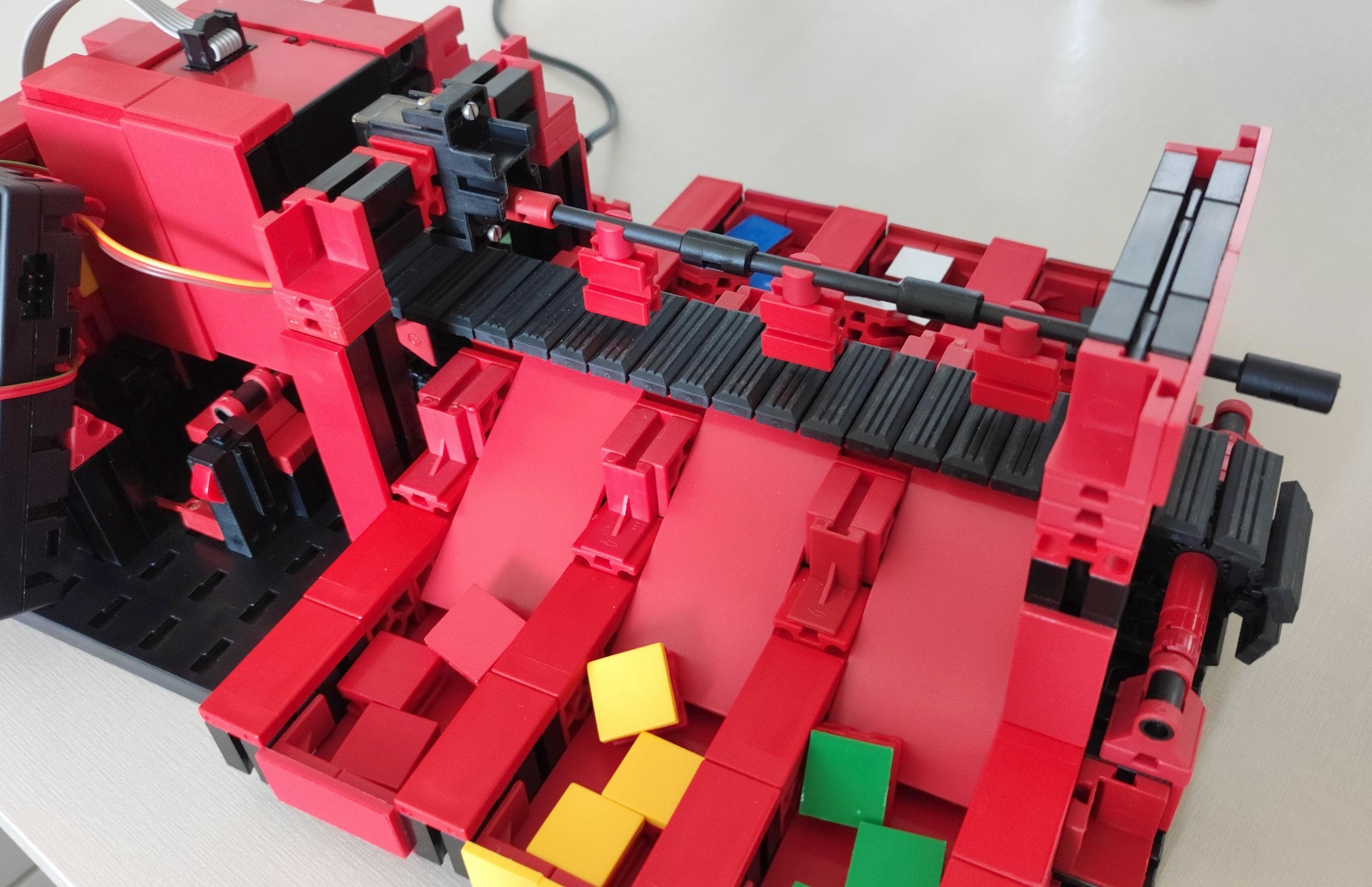

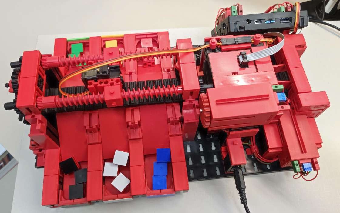

Hi there,
Now there's something I'm working on, a new kind of color sorter with a gesture sensor and a servo arm. It detects six colors including black and white. Since now I own two brand new TXT 4.0 controllers, I wanted to put them to good use, so I took a deep breath and started to work with Robo Pro Coding in graphic mode. (It's overwhelming.) Hopefully the way the color sorter works can be deduced from the photos below. If you pay close attention to the pictures you may see the gesture sensor is home made. I fit an APDS 9960 I had around and a 6-way IDC socket inside the case of an old ultrasonic sensor.
Color sorter front.jpg (90.85 KiB) 38642 mal betrachtet
Color sorter back.jpg (88.15 KiB) 38642 mal betrachtet
Here is the link to the code in case someone is interested.
Best regards,
Rubem

Hi!
Congratz with your learning curve on the Robo Pro Coding. Looked into your program, looks clean and I can see clearly the level of effort.. Nice work.
Although your pictures are clear it would be nice to see a video. Can you take the extra mile to create a simpel video for us?
Did you use the default FT lib for Gesture sensor for your "APDS-9960 Gesture sensor"? I am a little lost...
thx in advance, looking forward :-)

Hi,
rbudding hat geschrieben: ↑
16 Sep 2024, 12:11
It's just the default FT library. The great book from David Adams reveals that this sensor is exactly the same used in the ft gesture sensor, so anyone with a soldering iron can build a homemade ft gesture sensor for a few bucks. I'll create a new thread about it and post some pictures soon.
Video... yes, I'll definitely post one. (It's probably almost a year now since I promised one about my slot machine. I have captured everything, but editing is a lot of work.)
Thanks Richard and Peter for you compliments!
Best regards,
Rubem

Hi Rubem, like your way of sorting to two sides. It needs less space than the usual long track.
Nice that you got it working with the TXT controller. My 'color-sorter' (without TXT, see https://www.youtube.com/watch?v=PnTt4FmBfGg) is still functional and I have plans to build in a 'detection-queue' in the software, so multiple objects may be placed directly after each other on the belt. This might greatly enhance the thruput.
Another plan is to make it a more 'useless'-machine by feeding the sorted output back to a magazine that places the colored objects back on the belt from bulk.

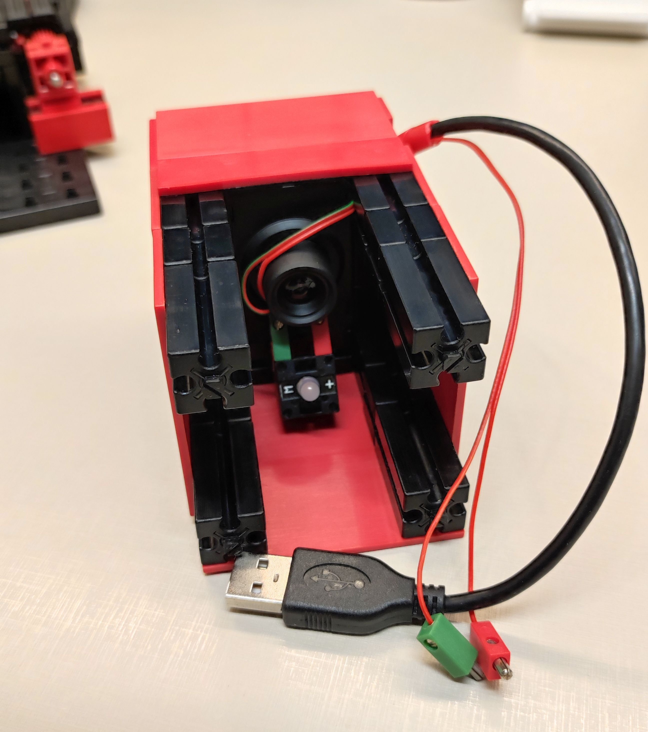

Hi Arnoud,
Your color sorter with Zauberlings is really amazing, congratulations for the design and also for the great video editing! I also think the colored dominoes are a great idea. As you can see in my video, the colored pieces don't show their colors anymore as they tumble. The dominoes would be much better. And in my case I just had the idea to use the servo because the TXT 4.0 just interfaces to it directly and I wanted to test the results. Of course moving the servo back and forth is much slower, but it kinda proves the concept and it can work without pneumatics which makes for a less noisy and more compact solution. Using 3 servos would be much better and potentially lot faster, but I didn't try it because I don't have enough servos and supports.
I also had several difficulties which may not be apparent. I first used a camera, but I could never make it to read the colors reliably because it seems to keep adjusting itself for luminosity all the time. (If someone knows how to circumvent this, please let me know.) Here is the failed setup:
With camera.jpg (539.79 KiB) 37094 mal betrachtet
Best regards,
Rubem

Hi Arnoud,
These are great ideas. In fact, when you think about it, only one servo (or one pneumatic cylinder, for that matter) should be enough, at least in theory. The main challenge then would probably be to guarantee a smooth, linear movement for all positions at the same time. Maybe I'll try it before taking it all apart...

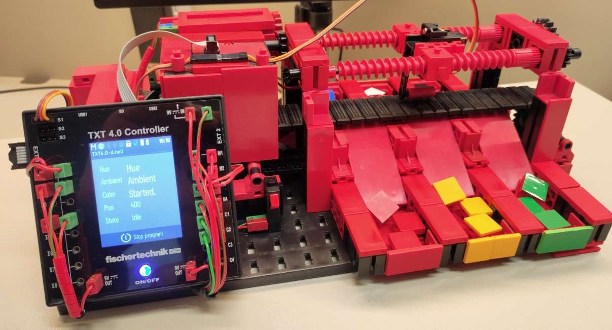

Hi Arnoud and everyone,
Here is the result with the new mechanics. Everything is simpler. The servo drives the axle directly using a sleeve 15 for stepper motor 160549. As soon as the color is detected, the servo is rotated in the opposite direction of the intended slot. The timing are set so that one of the blocks 7.5 pushes the colored pieces to its place. One second after, the servo is then re-centered to prepare for the next piece. The code is also a lot simpler (103 lines vs. 157 lines in file Object_placing).
New mechanics.jpg (910.91 KiB) 36667 mal betrachtet
Here is the link to the code (Color sorter servo II 9.ft).
Best regards,
Rubem
