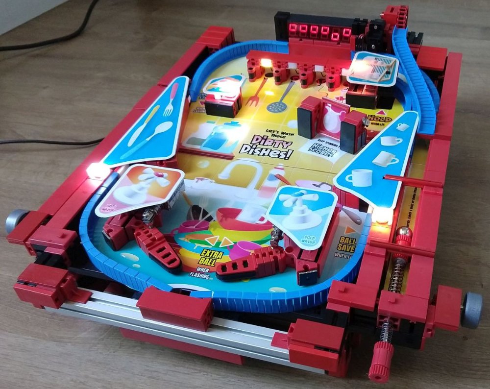

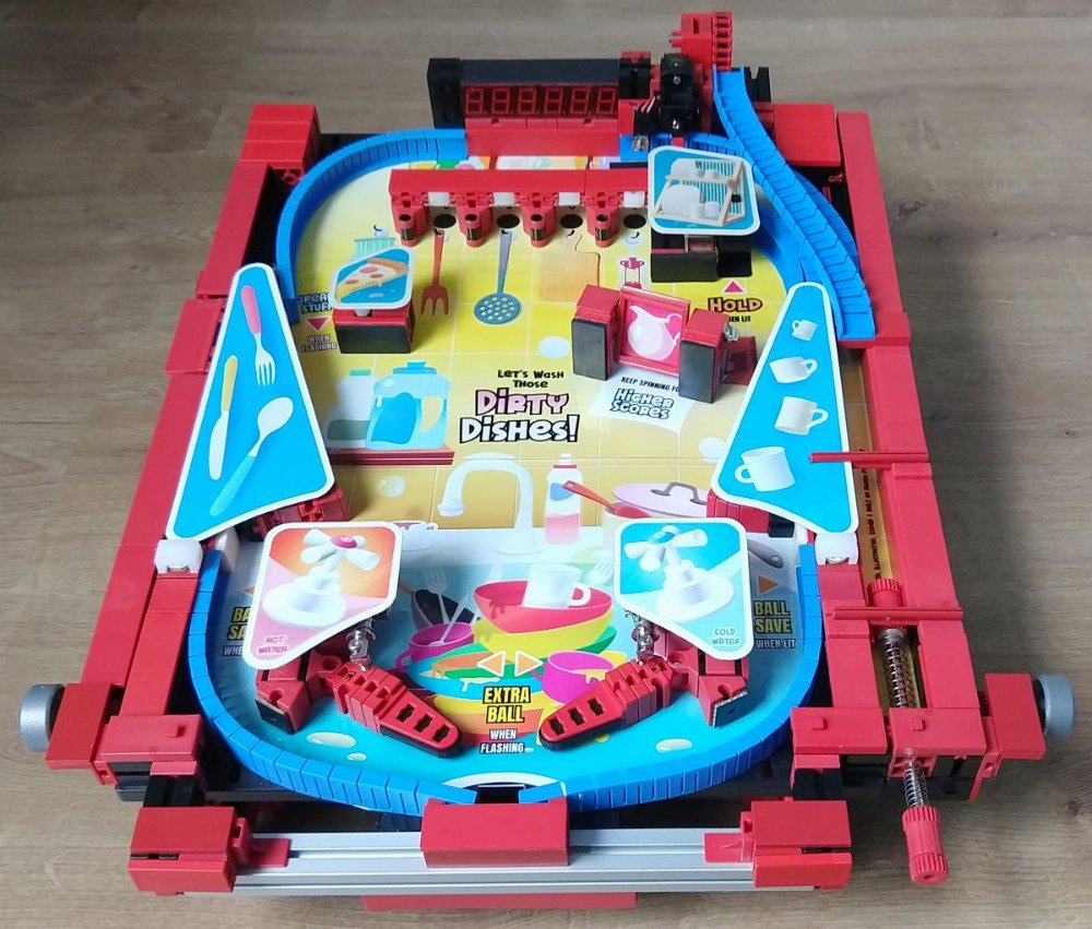

Hi everyone,
(Deutsche Übersetzung unten)
So here it is: After more than four months designing, building and coding, dozens of failed attempts and tests, meters and meters of wire, solder and double sided tape and a couple of smoked modules... my fischertechnik-based pinball table!
Overall view 3-2.jpg (164.26 KiB) 14380 mal betrachtet
It began as the standard ft Electropneumatics kit but evolved in a very different direction. The end result doesn't look or work like the original anymore. My main goals with this project were to achieve good playability and to simulate some classic pinball table features. It's a complex project so there is quite a lot to talk about. Here is a summary:
  • Flippers: These are made smaller than ft's and use two S-couplings with a hard rubber pad sandwiched between them. Minimum and maximum angles are similar to those in a real pinball table. The curved tip allows for better control of the ball direction, so usual tricks like passing and precise aiming are possible. Instead of pneumatics, the flippers use 6 V solenoids driven by a L298N module. They receive about 18-19 V for a few milliseconds, then drop to about 15% PWM which is enough to hold them up.
  • Ball return: After the ball is drained, it runs to the rear side via a flex ramp located underneath the table, then is immediately returned to the plunger by a chain elevator with a small magnet. After the last ball the return is not automatic, you must press one of the flipper buttons to start a new game.
  • Launch door: A servo-driven door opens when there is a ball to be launched, and closes when it passes a nearby sensor so it cannot return to the plunger. The closed door also helps to direct the ball to the rightmost upper lane during gameplay.
  • Targets: The playfield has four upper lanes with reflective IR sensors, a left target similar to the one in the Electropneumatics kit with an LED and ft phototransistor, a right target with a ft lightness sensor and electromagnet to hold the ball, a spinning target with a fork sensor to count revolutions, two extra IR sensors in the outlanes, and another ft phototransistor/LED pair just below the outhole. Rubber pads guarantee fast action in strategic locations.
  • Player feedback: A self-made 6-digit Arduino-based module shows scores and simple messages. Several LEDs and NeoPixels are lit or flashed to indicate game states. The sensor LEDs are controlled by software and they are used in some animations. There is also an MP3 module used for various sound effects.
  • Graphics: I've designed and illustrated a kitchen-based theme called "Dirty Dishes". You use the "hot" and "cold" handles (the flippers) to wash a pile of dishes inside the sink (i.e. get points). There is also a kitchen roll (the spinner), a plate rack where you can "dry" your plates (the electromagnet), and so on. Graphics are inkjet-printed on plastic sheets that cover for the many slots in the baseplates 500 so the ball runs smoothly. Translucent paper is used in some top covers where light is supposed to shine through.
  • Programming: The main logic is programmed into an Arduino Nano which deals with the all inputs and sensors, in addition to driving the flippers and the electromagnet. Another Nano is connected to it via I²C. It works as a port expander and controls LEDs, NeoPixels, the MP3 module, and the ball feed motor.
  • Gameplay: Game rules are detailed and somewhat intricate. Several of them are taken from actual pinball machine tables, while others are entirely different or had to be adapted. Features include: skill shot, ball save, multipliers, spinning target bonus, ball hold, extra ball, time-related scores, and more.
Overall view 2-2.jpg (160.84 KiB) 14380 mal betrachtet
I'm still working on the software. There is also room for improvement in some fronts, but I'm quite satisfied with the results so far, and so are my kids which also enjoy playing with the machine. Most of the time they are not very interested in fischertechnik but this is an obvious exception :)
I also have other images, I'll post some later.

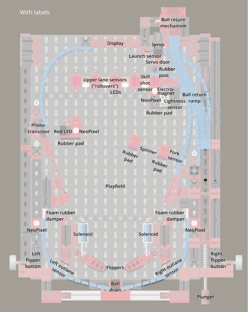

Thanks for the compliments! I certainly will make a video at some point, but "soon" is a bit optimistic :D (still working on the software). Meanwhile, you may take a look at what's below the covers and plates, I drew some diagrams:

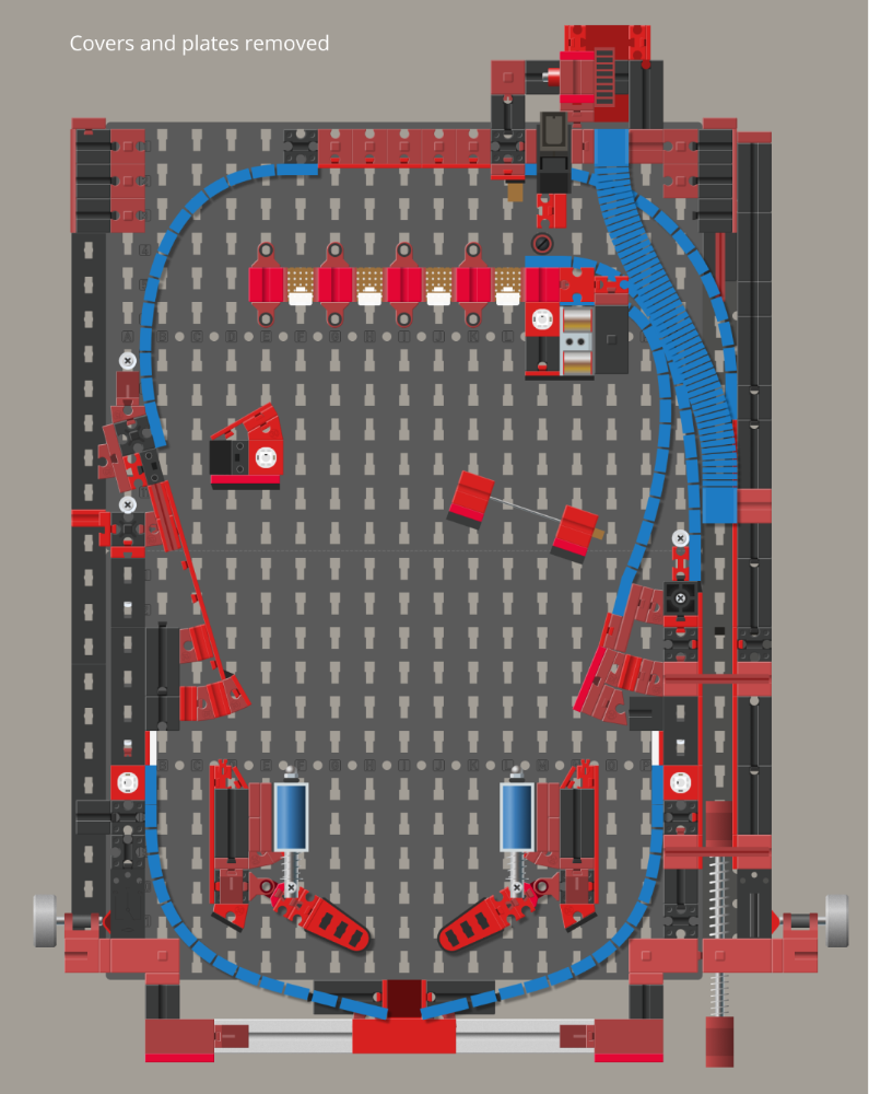

Table diagram without covers.png (337.55 KiB) 14353 mal betrachtet
Table diagram with labels.png (361.48 KiB) 14353 mal betrachtet
Best regards,
Rubem

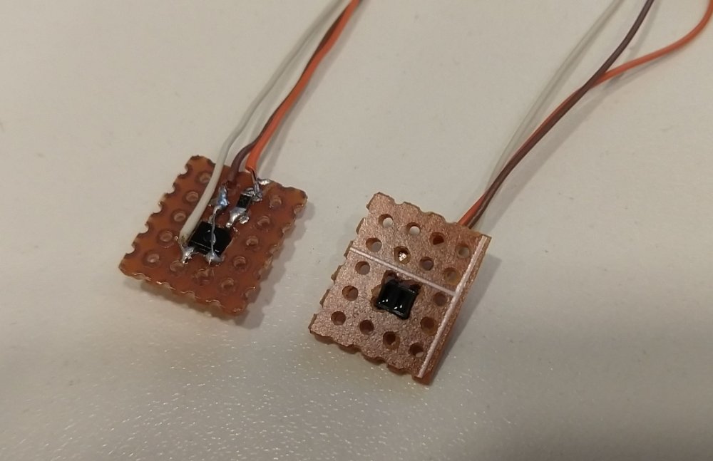

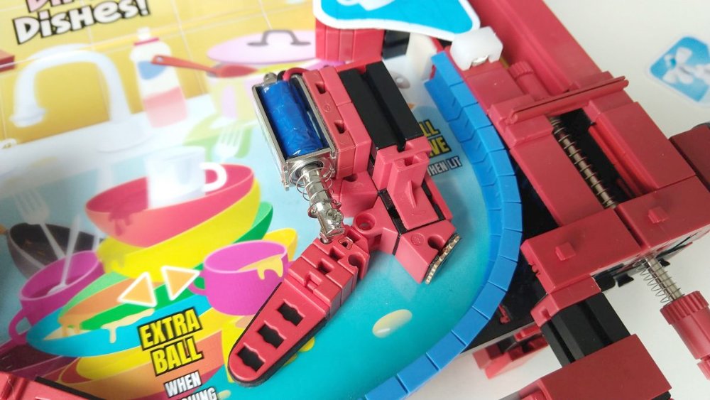

I assume the solenoids are something like this one, right? You say you are driving them only very shortly at full 18V, so I assume at 15% PWM you do not run into any heat problems if they are activated a little longer? I have one of them here for testing purposes, it's labeled JF-0530B, but found out that it becomes quite hot, if driven permanently, which can be a problem for 3d printed cases.
The outlane IR-sensors also look very slick! Where are they hiding? I can only see a little hole, are there SMD sensors in the ft-part groove below?

@Juh: Yes, that's exactly the solenoid model I used, which was designed for 6 V. It gets very hot when driven continuously at 18-19 V so PWM is a must. In my experiments I've arrived to 50 ms and 40/255 (~15%) as optimal values. 50 ms is enough for the flipper to quickly move up at full power, and, after that, 15% is just right for keeping them up to make them a bit warm, but not very hot. These solenoids are great because their dimensions are just right for the ft grid, see below:
Solenoid detail.jpg (97.67 KiB) 14156 mal betrachtet

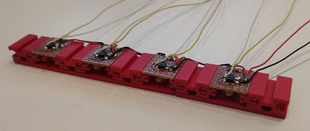

As for the outlanes, you also guessed right: These are QRE1113 reflective sensors which are very small and can be fully embedded in the width of a PCB if you cut a square hole on the board, which is exactly what I did in the outlanes. Then I've covered the small PCBs with black electrician tape, cut out a square on them, and glued them to the angle blocks with double-sided tape. These are the same sensors used in the four upper lanes, although I didn't need to cut the PCBs there.
Rubem

@Juh,
I have some photos from intermediate steps that will hopefully clarify how the QRE1113 sensors were mounted:
Outlane sensors.jpg (68.79 KiB) 14155 mal betrachtet
Upper lanes sensors.jpg (59.35 KiB) 14155 mal betrachtet
In the end I've replaced the upper lane LEDs with more powerful ones, but the general assembly remained the same.

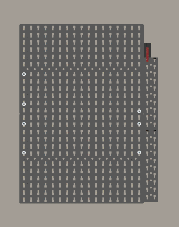

Here's a simplified animation showing some of the layers used for the pinball machine design, I believe you're gonna like it. Everything was done in Figma with custom ft and non-ft components.
Best,
Rubem

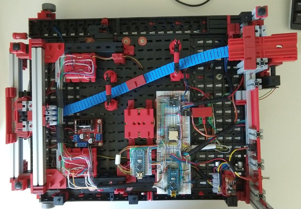

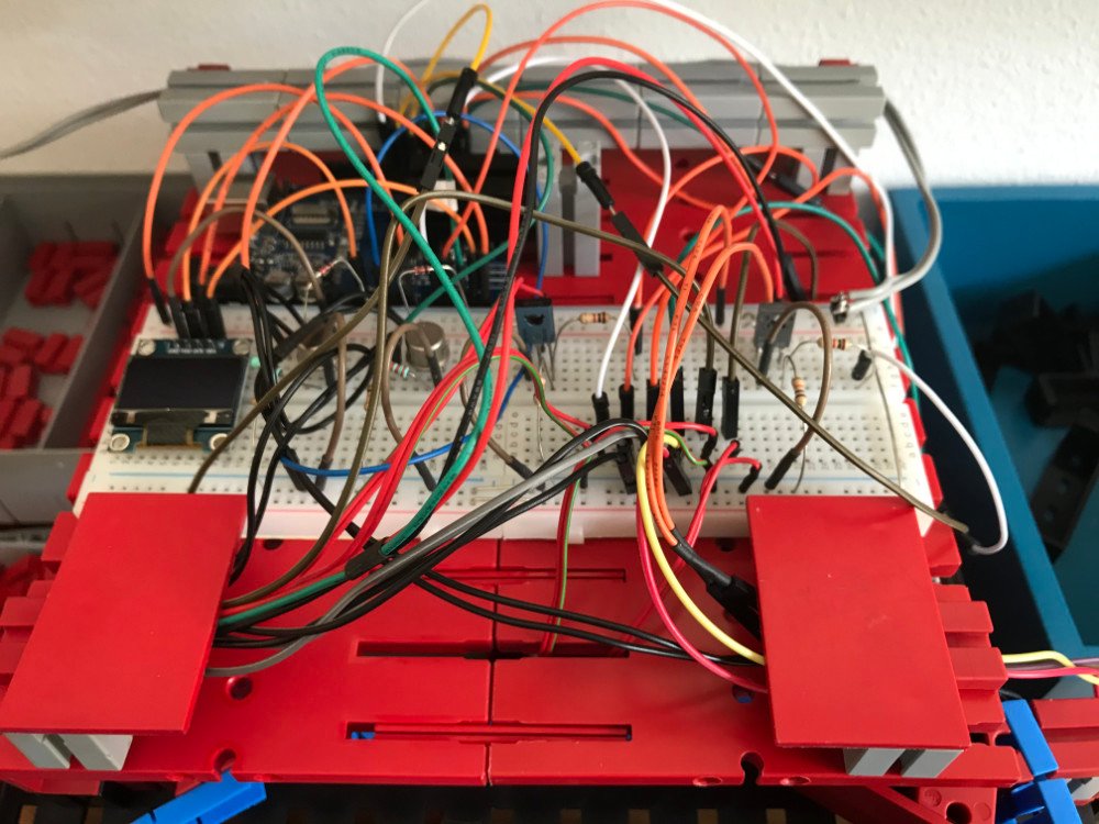

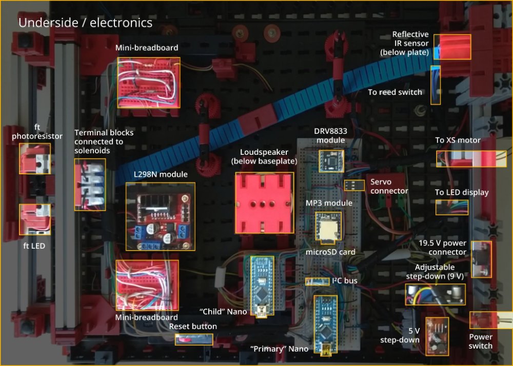

I found out the Neopixels don't work well as control LEDs. They often display the wrong color, light up when not asked to, turn off at wrong times. I made several tests but could not figure out a solution. So I've replaced them with regular white LEDs, I still had free ports in the child Nano. Less colorful, but reliable. Some more soldering and rewiring was required, Here is a photo of the underside as it looks now:
Underside 3.jpg (147.67 KiB) 13599 mal betrachtet
And a diagram showing the electronic components:
Underside electronics.jpg (137.36 KiB) 13599 mal betrachtet

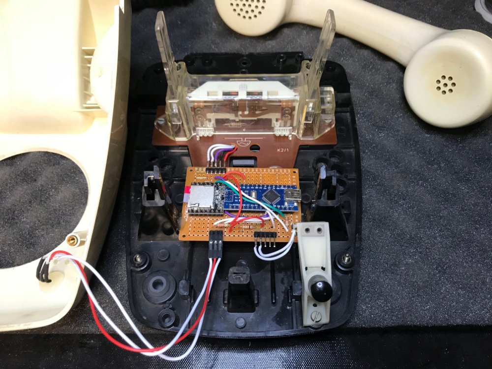

My use of a Nano and that MP3 player, is for a 'Nostalphone', an MP3 player made from a vintage rotary dial telephone:
A bit off-topic on a fischertechnik forum, but more about that: https://www.whizzbizz.com/en/gpo746-t65 ... wav-player

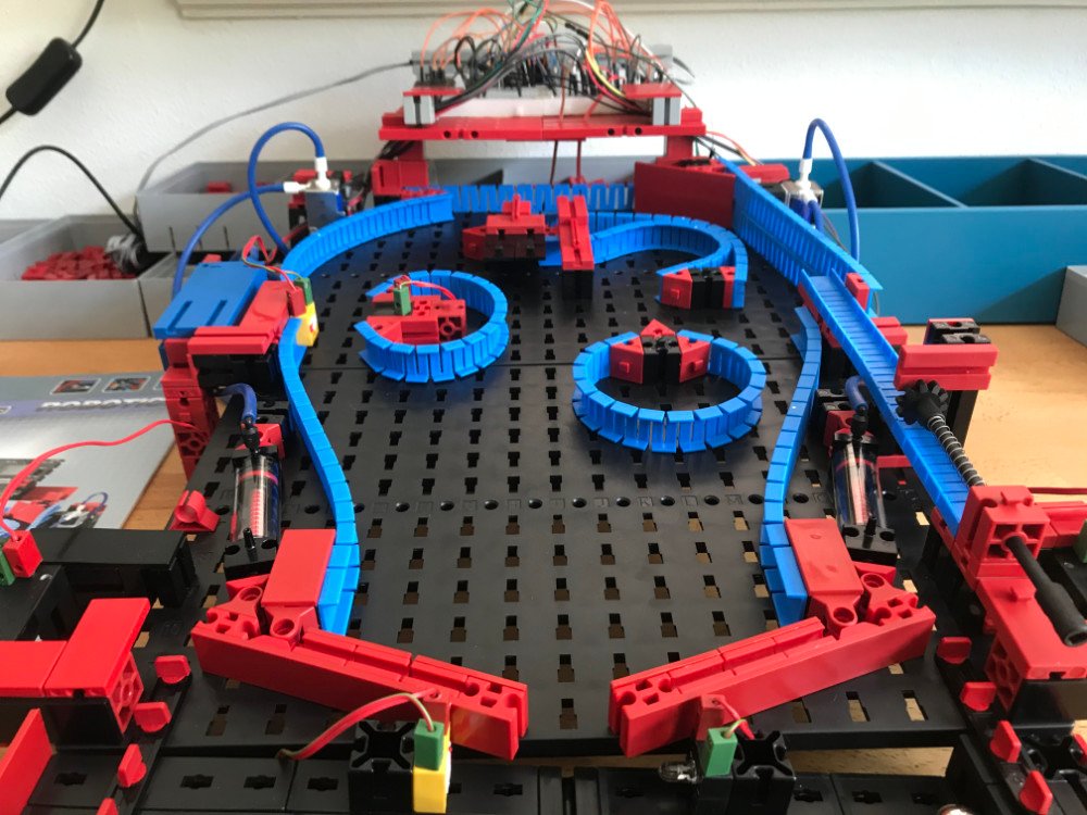

Great! My first tests to the ft pinball did not look much different from your photos, with an external breadboard and lots of jumper wires... And I loved our "Nostalphone" and the video :D (I already knew the Zauberling, of course!)
Thanks for the photos!
