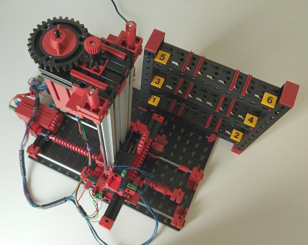

I have built a slightly improved version of the high bay storage rack from the Robotics Automation Robots Set. Much faster speeds can be achieved with just a few modifications in the original model. The photo shows how I changed the encoder motor gear ratios, and the original worm drive for the retractable fork was replaced by a rack with pinion. I changed the bay numbers so that they correspond more or less to the distance to the home station.

The Y-axis speed is not as fast as I expected. Especially when moving up, there is a noticeable power loss because of the heavy load. This also affects the horizontal movement. Maybe the TXT limits the oputput current, I'm not sure. I could probably use a power motor to drive the vertical axis, but in that case I would lose the encoder part.
