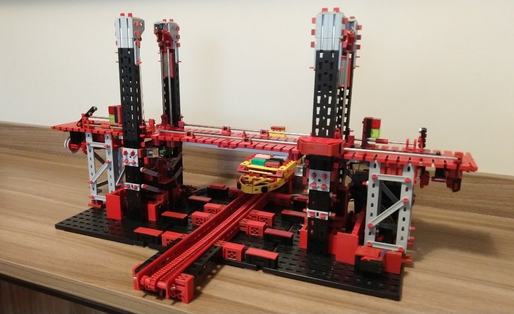

This is a working model of one of the most famous landmarks in my hometown, a unique lift bridge popularly called Ponte do Guaíba (Guaíba is the name of the lake it crosses). It lifts a 58-meter long mobile section with four elevators and counterweights. It was designed by German engineers and started operating in the 1950s. Today it is a cause of frequent traffic jams which are now partially solved by a newer and taller static bridge that started operating in 2020.

The lift bridge is a beautiful engineering achievement and I thought it deserved a fischertechnik model, so I've built one:
It operates as follows: Pressing the front button makes the green traffic lights flash, then turn red, then the boom gates are lowered. The bridge rises, the white lights turn on and the yellow barge starts moving slowly until it stops in the end of its course. At this point the bridge is lowered, the boom gates rise and the lights turn green again. A further button press at this point raises the bridge just a little bit so that the barge can quickly go back to its home position. Finally the bridge is lowered again. This completes the reset process. Everything is run on my PC by a Scratch program.
As my most ambitious fischertechnik project to date, it took around two months to design and build. It was rather extenuating but a lot of fun, so in the end I think it was worth it!

Dies ist ein Arbeitsmodell eines der berühmtesten Wahrzeichen meiner Heimatstadt, einer einzigartigen Hubbrücke, die im Volksmund Ponte do Guaíba genannt wird (Guaíba ist der Name des Sees, den es überquert). Es hebt einen 58 Meter langen mobilen Abschnitt mit vier Aufzügen und Gegengewichten an. Es wurde von deutschen Ingenieuren entworfen und in den 1950er Jahren in Betrieb genommen. Heute ist es eine Ursache für häufige Staus, die teilweise durch eine neuere und höhere statische Brücke behoben werden, die 2020 ihren Betrieb aufnahm.
Die Hubbrücke ist eine schöne technische Leistung, und ich dachte, sie hätte ein fischertechnik-Modell verdient, also habe ich eines gebaut.

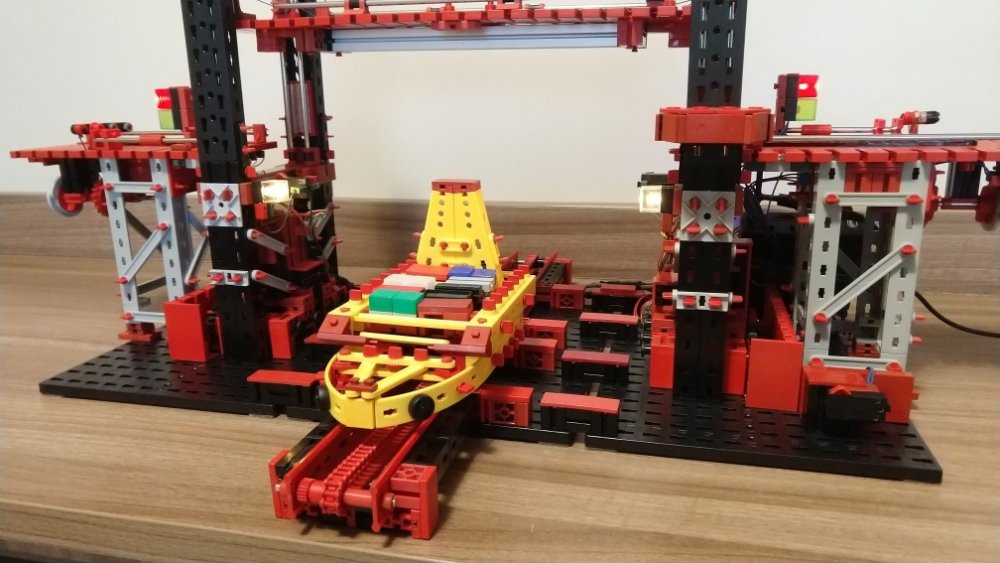

Es funktioniert wie folgt: Durch Drücken der vorderen Taste blinken die grünen Ampeln, werden dann rot und die Auslegertore werden abgesenkt. Die Brücke steigt an, die weißen Lichter gehen an und der gelbe Lastkahn beginnt sich langsam zu bewegen, bis er am Ende seines Kurses anhält. An diesem Punkt wird die Brücke abgesenkt, die Auslegertore steigen und die Lichter werden wieder grün. Ein weiterer Knopfdruck an dieser Stelle hebt die Brücke ein wenig an, so dass der Lastkahn schnell in seine Ausgangsposition zurückkehren kann. Schließlich wird die Brücke wieder abgesenkt. Damit ist der Rücksetzvorgang abgeschlossen. Alles wird auf meinem PC von einem Scratch-Programm ausgeführt.
Als mein bislang ehrgeizigstes fischertechnik-Projekt dauerte das Design und der Bau rund zwei Monate. Es war ziemlich mildernd, aber es hat viel Spaß gemacht, also denke ich, dass es sich gelohnt hat!

Hallo Rubem,
das ist ein sehr schönes Modell. Es gefällt mir gut, dass Du nicht nur den Bewegungsablauf der Brücke dargestellt hast, sondern zur Vervollständigung des Bilds auch den Lastkahn.
Danke für's zeigen!

@Peter and @Karl: About the barge, I felt it was necessary to show the whole thing, complete with a boat / barge, traffic lights and boom barriers, otherwise it would be too easy ;) But my TXT ran out of outputs so I built a custom relay module which is housed inside a 9V battery case lid. It can be seen behind the push button at the bottom right.
@Peter und @Karl: In Bezug auf die Barke hielt ich es für notwendig, das Ganze zu zeigen, komplett mit einem Boot / Barge, Ampeln und Auslegersperren, sonst wäre es zu einfach;) Aber meinem TXT gingen die Ausgänge so aus Ich habe ein spezielles Relaismodul gebaut, das in einem 9-V-Batteriefachdeckel untergebracht ist. Es ist hinter dem Druckknopf unten rechts zu sehen.
