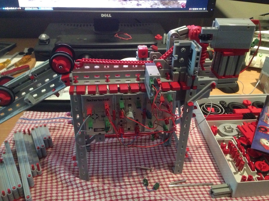

Hi Everyone,
I built the Incline Elevator but I am having trouble with the electronic controls. I am using the picture in the catalog 1975-39004 page 15.
I tried a few wiring circuits but have not got it to work correctly.
The way I see it operating is as follows. It should stop when it reaches each end; then when you push one of the buttons it should proceed to the other end and stop.
I have found in document 39543b Hobby 4 Band 3, page 62. This uses two Elecktronik-Grundbaustein and two Relais-Baustein, whereas the picture in the catalog shows only one of each baustein.
Does anyone, know where I can find a document that shows how to wire it up where it uses one of each baustein? Or can any one provide some assistance please.
Thanks
Michael :D

Beitrag von Codex » 24 Jul 2017, 02:24
Ohh.. I see my error now, thanks Stefan. I thought it had one relay. Yes, I can see how it can be done with 2 h4RB relays.
This picture show my attempt using one h4RB relay and one h4GB Elecktronik-Grundbaustein. I have another h4GB relay and will try it later when I get home. Thanks for your help :D
Michael

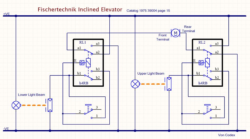

Beitrag von steffalk » 24 Jul 2017, 15:28
Hello Michael,
here https://ft-datenbank.de/details.php?Art ... bd023c6bd8 on page 13 we can see that they actually used *2* buttons, one underneath each relay. So I guess the original model was quite simple: Each button just shortcut one of the self-inhibiting relays, one for up, one for down.
However, let's keep trying using only 1 button to achieve both movements without further electric components!

Beitrag von steffalk » 30 Jul 2017, 23:33
Hello Michael,
I have also built that model - couldn't refuse ;-) I have a working version using original hardware, that is, 2 h4RB relays and 2 buttons. Works fine, including that you may press whatever button you want during transfer - it won't change anything. If the wagon is driving, nothing but the light barrier at the end will stop it. At the end positions, only the button for driving to the other end will do something.
As extensions, I have attached two lamps at the ends, one for each direction. They will light up whenever the motor is turning in "their" direction as a warning light.
Also, one of the good old 8-step rotary switches (from e-m1 or hobby-3) is used to turn on none, each single, or both end positions to auto-turn. That is, you can set at which end(s) you want the wagon to automatically reverse, including full auto-mode in both directions.
The one thing for which I am looking for improvement is that in auto-mode, the relays snare for just some milliseconds.
I will have the model with me at the Convention in Dreieich in September. Will you join us there with your version?
Best Regards,
Stefan

Registriert: 06 Jul 2017, 04:17
Re: Incline Elevator
Beitrag von Codex » 01 Dez 2017, 01:16
Here is my circuit. Attached. It is as per the original 1975 design.
