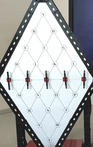

The article describes the device thoroughly, and it even includes a very nice schematic. A faithful copy would require ten electromagnets and ten fixed magnets connected to the needles, but I realized I could make it work with mini-motors. The principle worked, so I set out to build a complete model. It has one simplification: the model is unidirectional, that is, one unit is always the transmitter and the other is the receiver. I could made it bidirectional (i.e. half-duplex), but the wiring would require a lot of extra labor. It looks like this:
telegraph model.jpg (788.54 KiB) 12970 mal betrachtet
In the original, two buttons must be pressed for a character to be transmitted. I added rotating handles to press the buttons, both to avoid short-circuits (which are very likely to happen otherwise) and to make transmission more user-friendly. Turning a pair of handles each time drives two motors on the transmitter and two on the receiver, sending one character. The whole switch assembly can be pivoted for easier storage. The panels are printed on 240 g paper and have lines, circles and typography similar to the original. Five needles give only 20 characters; I decided to copy the original English layout (which omits the C, J, Q, U, X and Z, so it can't quite spell "fischertechnik" :sad:). Perhaps some of you will try a German version with different letters? A bigger, 6-needle model which would allow up to 30 characters.

Sehr schönes Modell!
Die Rückseite mit der Technik wäre natürlich auch interessant. Gibt es da eine Rutschkupplung oder fahren die Motoren an einen Anschlag und brummen dann vor sich hin?

Hi Holger, Cheorl, Harald,
Thanks for your answers and compliments. @Cheorl, you are right: The photograph seems to depict a model with an earth (or return) wire added, possibly to be able to rotate needles individually so that it can send additional codes. My model, however, uses just five wires like in the schematic:
I'll try to change the title anyway, and I'll be adding more photos soon.

Hi again,
Here is a photo of the receiver (still on a plate 500) with the front panel removed. Harald, hopefully you can see that the connectors 15 with clips act as stops. And you added a good question: I don't hear any hum. Maybe because the switches are on just for short periods (less than a second)?
Here is the back of the transmitter showing the batteries:
Here is the swiveling switch panel in the storage position:

Hallo Rubem,
ein wunderhübsches Vintage-Modell hast Du da gebaut. Glückwunsch!
Das Prinzip verstehe ich aber noch nicht. In Deinem Schaltplan scheinen mir mit den gedrückten Tasten 4 Motoren in Serie geschaltet zu sein.
Wie soll das funktionieren? ist das eine Art Schrittmotor-Betrieb für die Motoren oder laufen sie synchron und wenn abgeschaltet wird, bleiben sie an der gleichen Stelle stehen?

Hi Florian,
In essence you are right, whenever I turn two of the handles four motors are energized: two at the receiver, and two at the transmitter. The "trick" is that they turn just about 30° and stop (i.e. they don't rotate continuously), thanks to the connectors 15 with clips on each side that are used as stoppers. I hope it's clearer now.
I've edited the original schematic to represent my actual circuit, where each coil represents a motor:

Hi rubem,
thank you for the explanation! It is much clearer now why the plates at the motor are 15 x 30.
Essentially each motor has 3 states: +30 deg, 0 deg (vertical) and -30 deg. The +/- 30 deg positions are limited by the end stops and for the 0 position (hand vertical) the operator must stop in the middle I would assume.

Hi Florian,
Exactly! The rotatable handles are kept in the middle position by default because of the springs inside the mini-switches. They are connected to horizontal plastic axles that rest on the switch buttons, one at each side. Here they are in their default position:

Thanks for the compliments! About the ft-pedia article, I agree that the subject is interesting enough to warrant an article. Maybe I can find some time to write it after the holidays, let's see. I appreciate the invitation.
I forgot one important detail: When a motor is de-energized, the needle goes back to its resting position by using a time-tested principle called "gravity" ;) Each assembly includes a weight made of a block 7.5 with a clamping sleeve where a 30 mm metal axle (with two clips 5) is attached. The picture below shows it in detail, with one of the connectors 15 with clip that stops the rotation.
